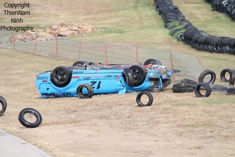

Was This One Of Our Members...Ouch !!!
Curious on how you guys perceive the cage or no cage on street car debate.
Is it safer? My guess for a roll over it is.
But for occupants with no helmet on, does it just give you what is likely a closer hard object to hit your head on?

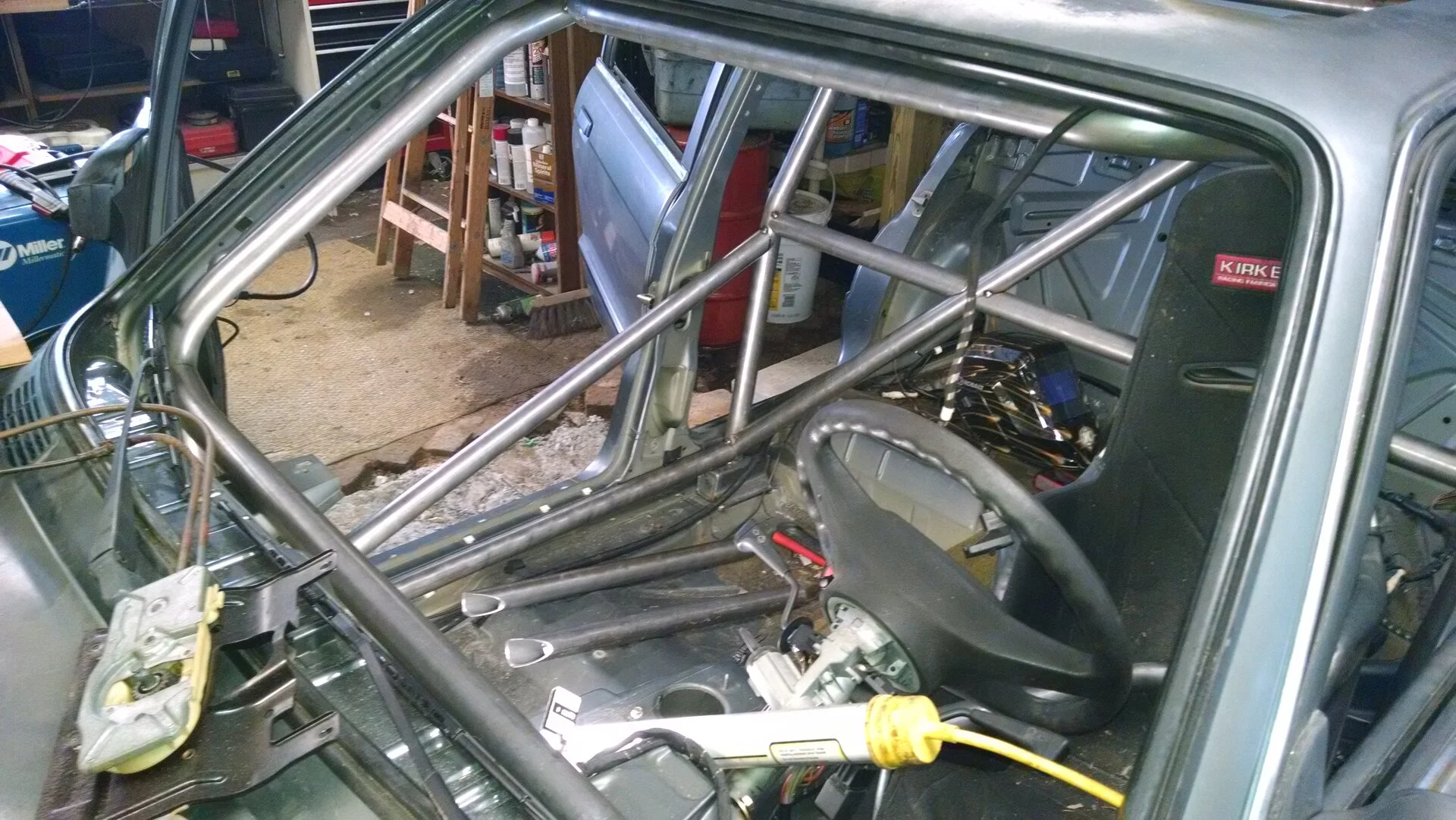

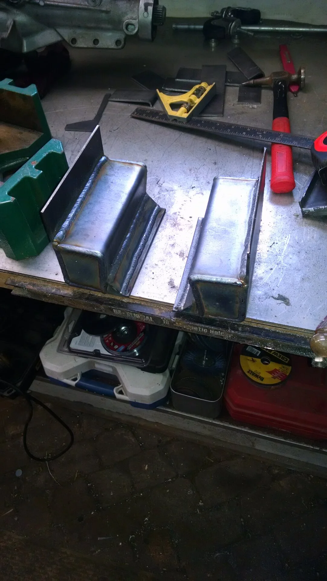

That would be an improperly installed roll bar. That's one of the reasons I like to use step boxes on the rolls bars that I've put in for people. #1 it allows you to move the roll cage around while it's in the car to get the top welded properly and keep the bars as close to the body as possible. #2 is provides a crush structure that absorbs some of the impact in a roll over and more surface area to weld to the body which both helps prevent punch through.
Like this (these were for my E30)
