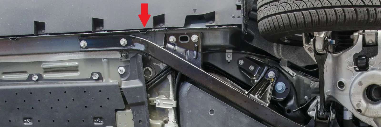

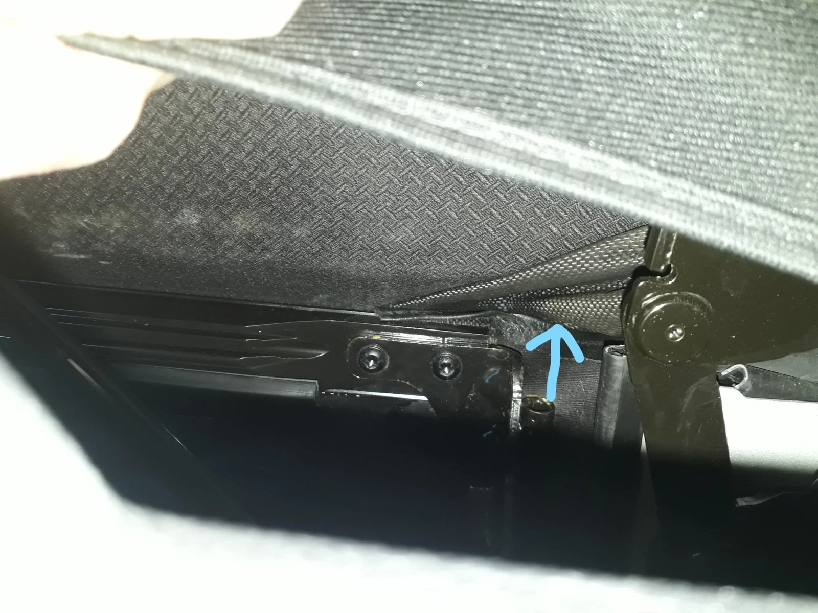

Same issue for me on my 2016 convertible. Lots of water collecting in the rear passenger (ie left) footwell and under the passenger seat when it rained. Poked around and found a couple of things worth registering:
1. Drain holes underneath, which can be cleared with a wire coathanger or similar - see picture. One on each side about a foot in from the rear wheel.
2. There is a flap of material attached to the outer fabric top, directly behind the rear quarter window, beside the back of the rear seat. Lift up the inner fabric top to get to it. In my case, on the leaking side, this flap was hanging around on the inside of the of the car and I could see that water had coming in over it. The flap needs to on the outside of the lower fabric hood lining so that it guides rainwater out and into the gap between the body panels and eventually out of the drain hole above. The picture shows it back in the right place.
I am hoping this has solved it... now waiting for the rain.

Hi Nik, yes it seems to have fixed it. We have have a few serious downpours in the last couple of weeks and it has stayed completely dry. I don't think it was anything to do with the drain holes in the end - mine did not seem to be particularly blocked. The key was making sure that that flap of material on the inside of the hood is in the right place to keep the rain out of the cockpit.

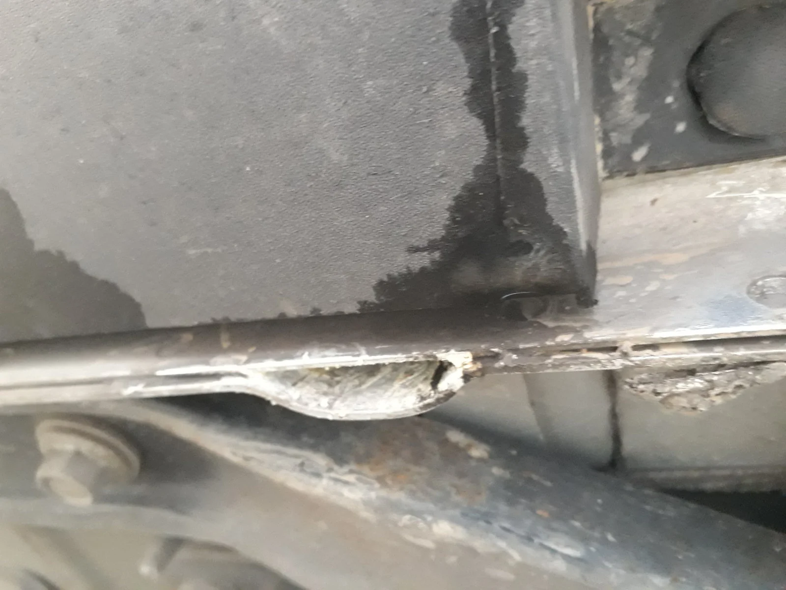

Glad you got it sorted. Found the "flap" and both looked like they falling outside of the cabin so time to check the drainholes. Difficult to tell from the close photo. Did you mean here ...
Thanks to eleanor5oh on the "other" forum for the photo BTW.
Yes that looks like it... and you can see another one about a foot to the left... My, what a nice clean car !
