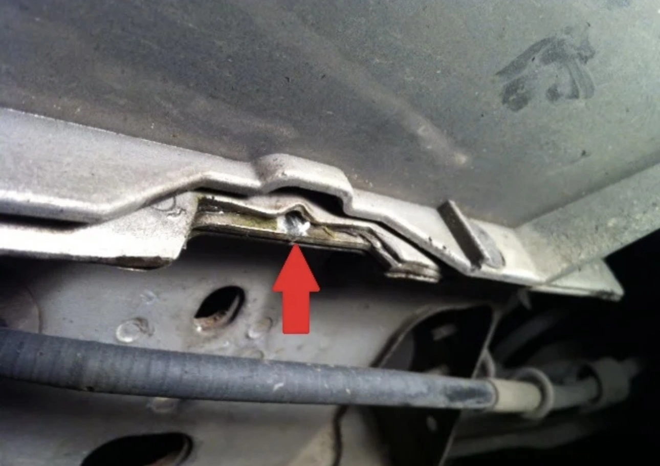

Beleive it or not, the top is designed to channel the water off the back of the top around and drop the water into a “pocket” under the rear quarter windows. At the bottom of the pocket, there is a drain hole.
Over the years, these holes plug with leaves and dirt and other crud and block the drainage path. The pocket fills up with water, and spills into the interior. Usually the rear seat and rear floor area get soaked first, but it can also travel up the side rails and leak into the front floorboard area.
Clear the drain holes with a coat hanger/ compressed air. If bad enough, you may need to open up the paneling to the pocket and vacuum it out. All depends on if the car was parked under a tree and lots of leaves and crud fell down in there.
