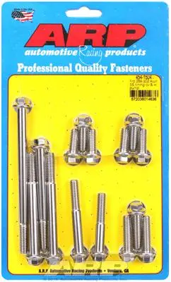

Water pump and timing cover bolt kits..
ARP # 454-1504
You will need to reuse a few of the studs. Nobody makes a fastener kit that includes the factory style studs for the A/C compressor bracket, etc.
if you have your old bolts why not go to home depot or lowe's and match up your old bolts with new ss bolts, it's got to be cheaper ...and your not paying for a complete kit that you can only use some of the bolts from. :shrug:
I hated that nobody made a fastener kit that had the actual factory style studs and after calling a dealership and finding out I could get all but one (due to discontinuation) BUT these idiots wanted $30 for 1 freakin stud. Low and behold one of those stupid little H.E.L.P. packages you see at most autoparts stores had the exact studs I needed to replace. Not stainless of course though but is where I had to look to find new studs.
