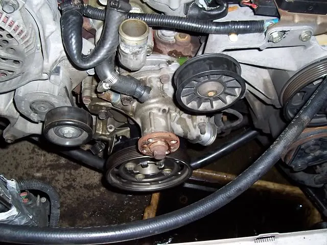

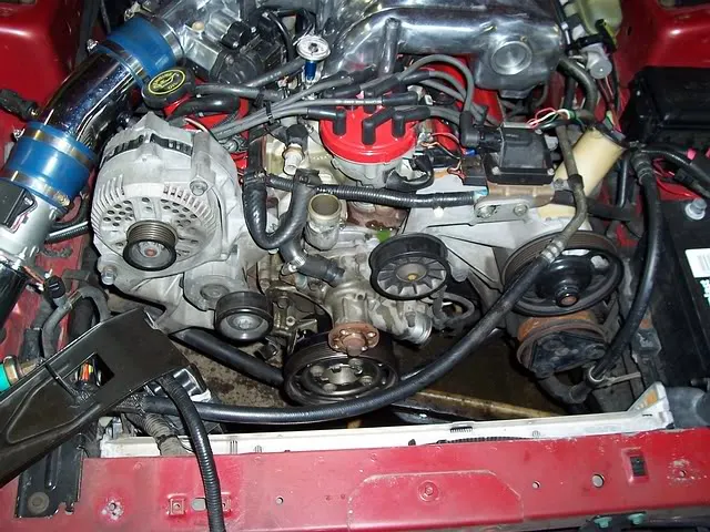

You have to take crank pully off because there is one bolt of water bump(on bottom) begind crank pully and you need help with pully tensioner , I did with my self using prey bar and push tensioner with my sholder so I have bothe hands free for water pump bolt under tensioner

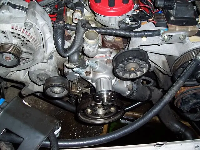

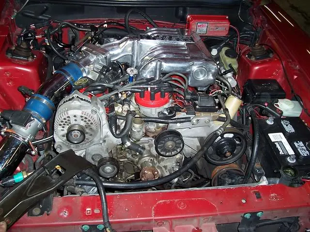

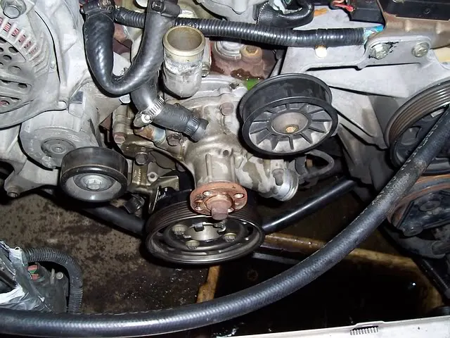

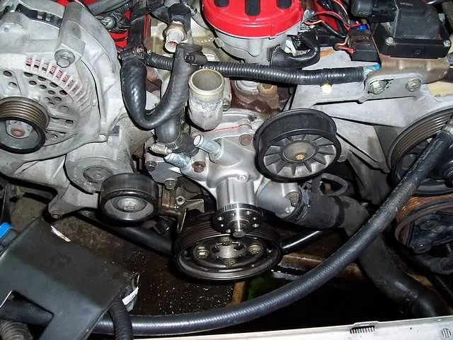

Here is some pics and last pics is new water pump
