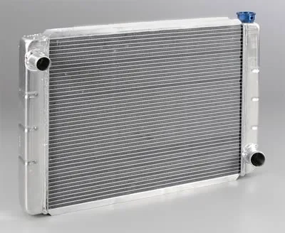

well im gonna oder a Summit Universal type,its gonna be 27.3"X19X3.0 (stock is 17X17 :( )so it will fit inbetween the frame rails and i got the drivers inlet and pass outlet,that way its easier to use Cool Flex hose for the inlet and maybe keep my same pump and add a Taurus fan :nice: As far as making it fit,im gonna weld a couple of tabs and thats it.Shouldnt be too hard.This pic upside down and they are made by Griffin and its 169.00 so its A LOT less then the $575 that my Be Cool list for. :rolleyes: .

Maybe I'm not understanding. I'm using a universal "chevy style" Griffen alum radiator. I'm using a pass side water pump on a early style timing cover. Are you changing to a 5.0 style for some other reason other than the radiator? :shrug:

I was going to run a drivers side outlet but i found a universal with a pass outlet.Originally i was going to use a 5.0 radiator which is opposite.
Sorry, I'm a little slow tonight. I'm using the same radiator as you are with a victor pump and the car gives me no problems at all. I only run electric fans and the car stays cool. Even been Woodward tested on a 90deg day. :nice:
