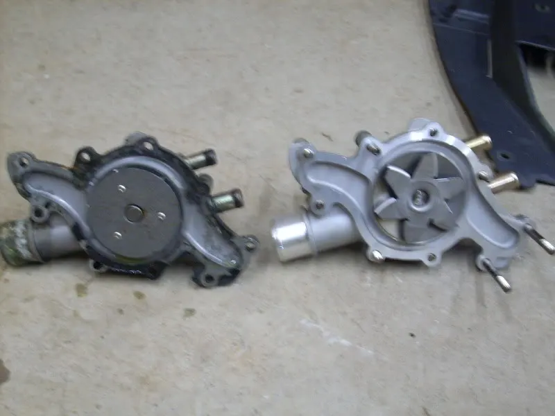

Remember when I got duped into buying that Stewart, cuz all you guys said it was awesome, and then ended up returning it. It's not high flow or high volume or any of that stuff. It's got a stock casting and stock impellar. It's a way overpriced bone stock water pump with a less competitive warranty. The only thing advertised that I can't dispute is that it supposedly has a stronger bearing in it. But seriously, the SN doesn't even have a fan hanging off the front of the pump, so how strong of a bearing does it need. And if they lied about the high flowiness, I bet they lied about the bearing too. And then turn around and back up a $191 pump with a 1 year warranty, when the Advance brand cheapy pump for $70 has a lifetime?
There is a picture of a high flow on the left, and the Stewart on the right. If you look at the back of your stock pump, you will see that it's identical to the stock one.
Kurt
