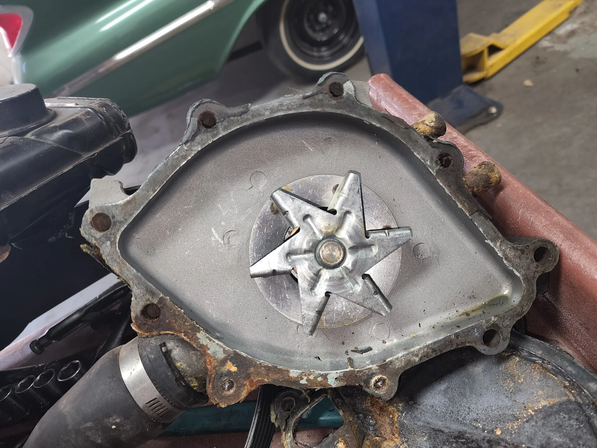

Hi. I apologize if it was asked here before.
I'm trying to figure out the correct water pump for my brother in law 1984 mustang 5.0 lx.
I called the dealer with my Vin and was told the E5ZZ8501A. On rockauto this number crosses to both standard and reverse rotation pump. Fan blade look reversed compared to a 1967 dodge with v belt I have sitting around. And the original pump looks like it's revered rotation. So everything indicates to reverse rotation.
Did the car originally came both standard and reverse rotation?
This car is a convertible with air conditioning. Does that have anything to do with it?
I'm attaching a photo of the original water pump.
Thanks in advance for all your input.
What side of the belt touches the pump pulley? If the back of the belt touches the pulley, its reverse. If the ribs of the belt touch the pulley, its normal. All the factory pumps I've seen have been reverse, but I'm not certain about 1984.
Pully is smooth, water pump is revered for sure by the way the fan blades are tilted.
I finally found a water pump that's reversed and the back plate matches the timing cover, it should be here Wednesday.
Thanks
The first pump I ordered was standard, the second was reversed but for a different timing cover. From the photos of the pump I'm pretty sure I should be getting the right one this time around.
