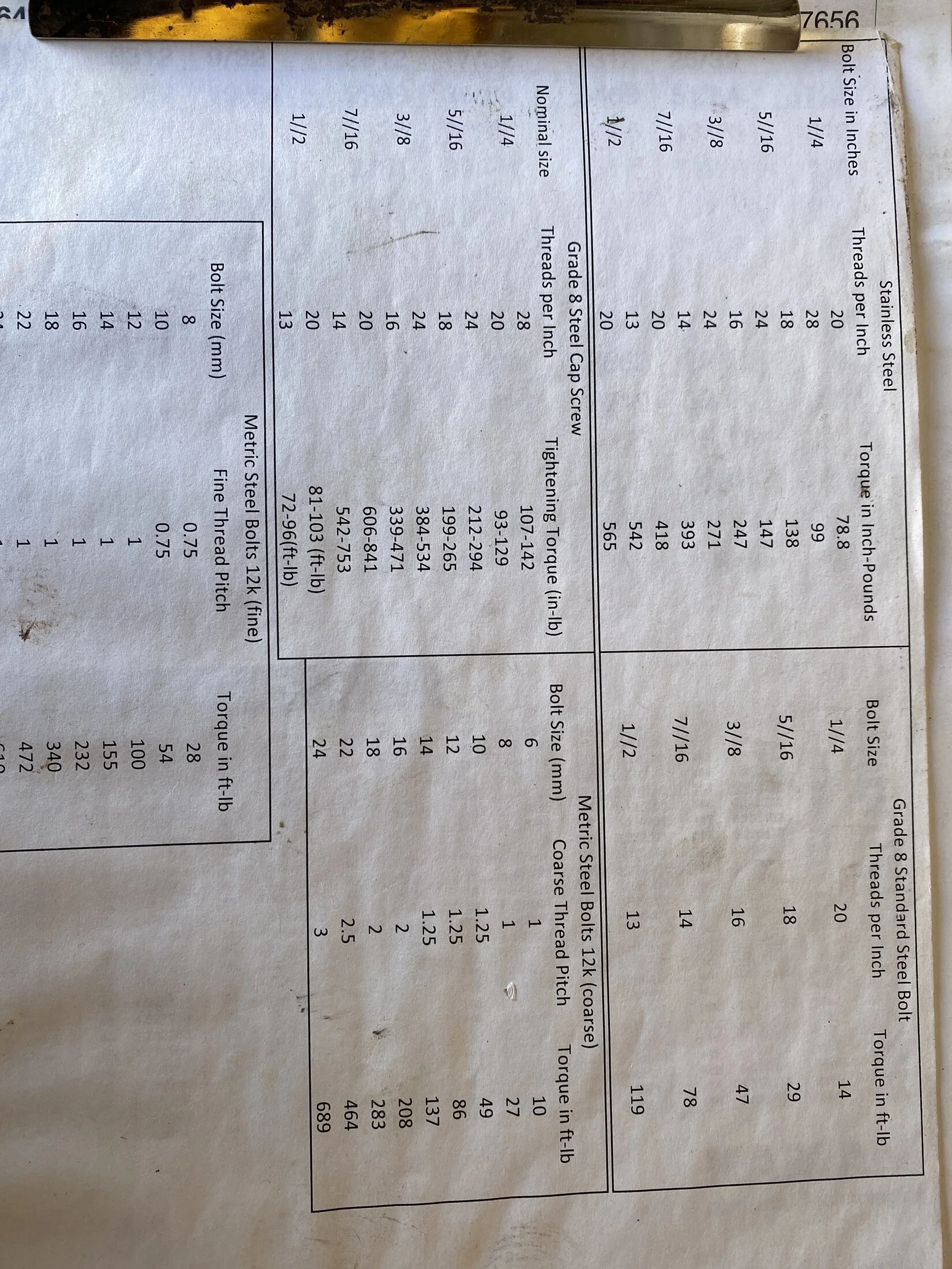

Old post I see, yet I am doing more parts on the 94 now. Was trying to find any if at all any torque specs go the water pump.
In the past I had always been tighten until tight for a water pump. But if it will let me here is a general torque spec sheet for different type bolts and different applications. Hope it can be useful.

Turn them until the bolt strips, and then back them off a hair. There are no water pump torque specs.
