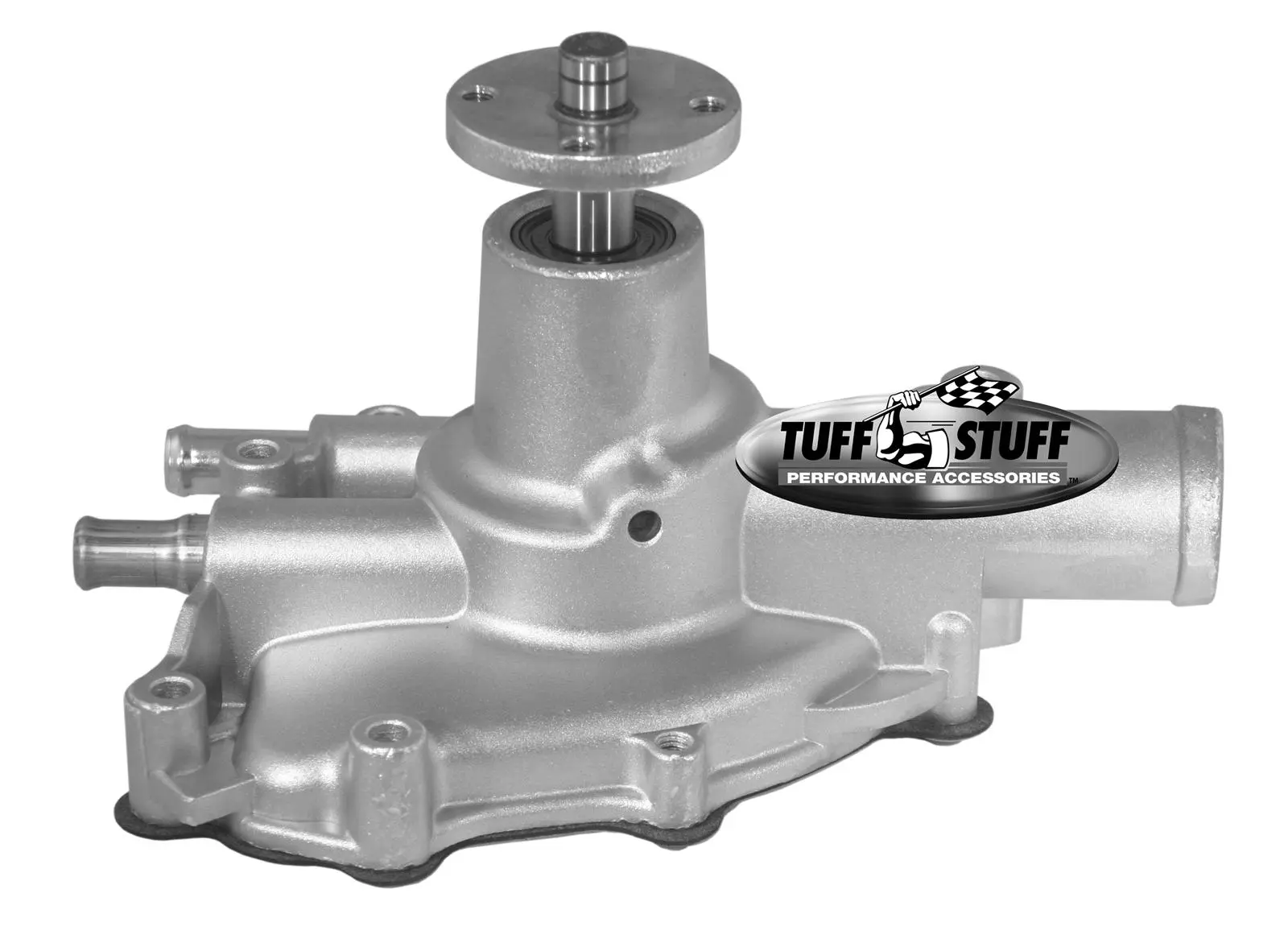

Its time for number four, O'Reilly's pumps #mtc cp4038. My receipts show #2 replaced 4/21/14 ,#3 12/26/15. Now they have a supposingly better one mtc4038h for less then a buck more.
They also have a copy of edelbrock pump for $95. But the heater hose connections are a little funky,like they need fittings and different hoses.
What is a fox owner to do? I got time its just weeping now .
But a Motorcraft PW291. $53 on RockAuto.
Still made in China, just found first pump I bought its when O'Reilly's was Checkers 8/11/07. That lasted almost seven years, second one lasted 18 months,and third one lasted almost nine years. I daily this beast in the desert I live in here in Nevada , I'm leaning on the better one O'Reilly's has.
Reactions: Noobz347
