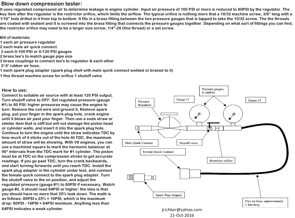

Be sure if you can't hear it run, to at least leak down test it. Very simple to do, but can save you a lot of money. Then if it checks out, new oil and Prime it.
You buy or rent a tester (harbor freights is meh, but works). Essentially you leave all the spark plugs in except the one your testing. Bring that testing cylinder up to Top Dead Center, fill with air (either from a portable tank or air compressor) and watch for loss. Best case scenario is for the engine to be warmed up, however while cold, this still can provide a insight on whether or not there is a clear problem. That is the simple version, there are more in depth procedures, which I'm a visual person and youtube has a ton of videos showing better than I can explain it.

I remove all of the plugs and rocker arms, fill the cylinder with air (the motor may spin either direction depending where the piston is at on the stroke) It is important to use a consistent amount of incoming air pressure for consistent resuslts, I typically set the incoming regulator at 80 psi fwiw. I would look for a number 15% or less with consistent readings across the board to agree with a passed result. Hope this is helpful
Here's some DIY help...
Click on picture to enlarge it...
