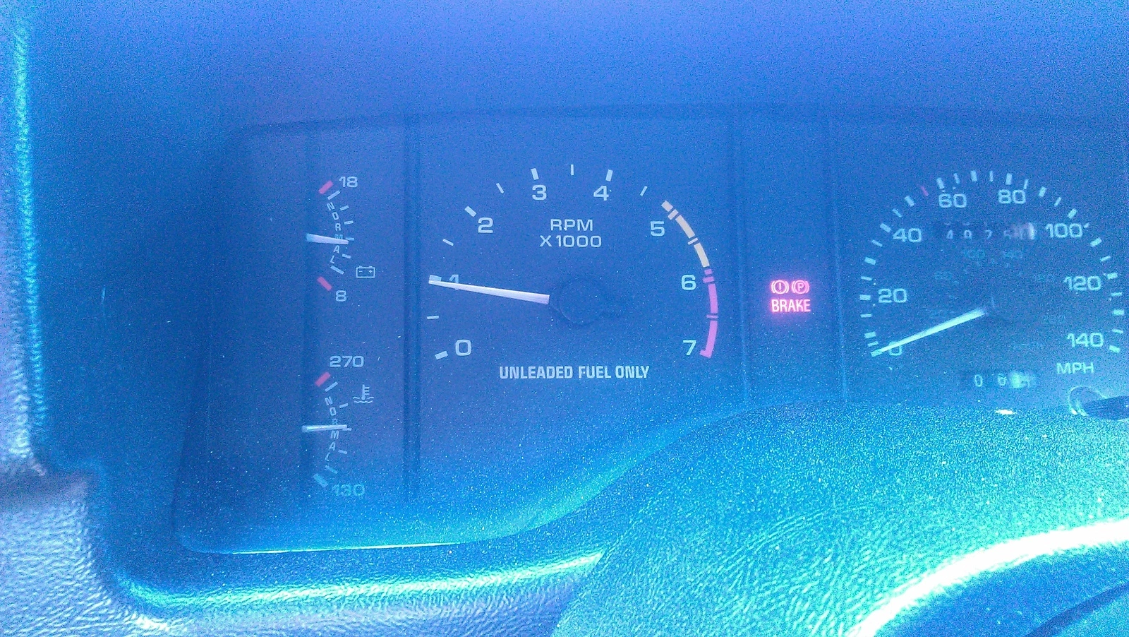

So I'm reading reviews about this product and I feel enough people on forums have claimed good results v.s. the no results to try it, ...and Soooooooo the experiment begins, ....Muahhahahaha!!! I'm always trying new things to see if they actually work anyways and it's time for the coolant flush, so what the hey, let's document it with pics of the gauges. I'm also needing a little love with the upgraded 3 row radiator with 1 electric fan i already had. Should have stayed 2 row with 1 fan but it's cool, I'm in deal with it city and I've had good success with the Bars Stop leak_silver aluminum with the old radiator and heater core. So it's time for more snake oil :D
So to really slap the teeth outta this b!@tch I'm not using one bottle but 2 Bottles :nice: Also gonna use stock gauges and the "normal factor" for my car. My car doesn't get middle on my NORMAL scale until a/c is being used. Never over heats normally and i have not had any puking in any situation in 1 1/2 years, I have a 190* t-stat in right now and a 60/40 water/coolant mix and today is "D" day ....Let's Do This o_O
Pics before/after coming :nice:

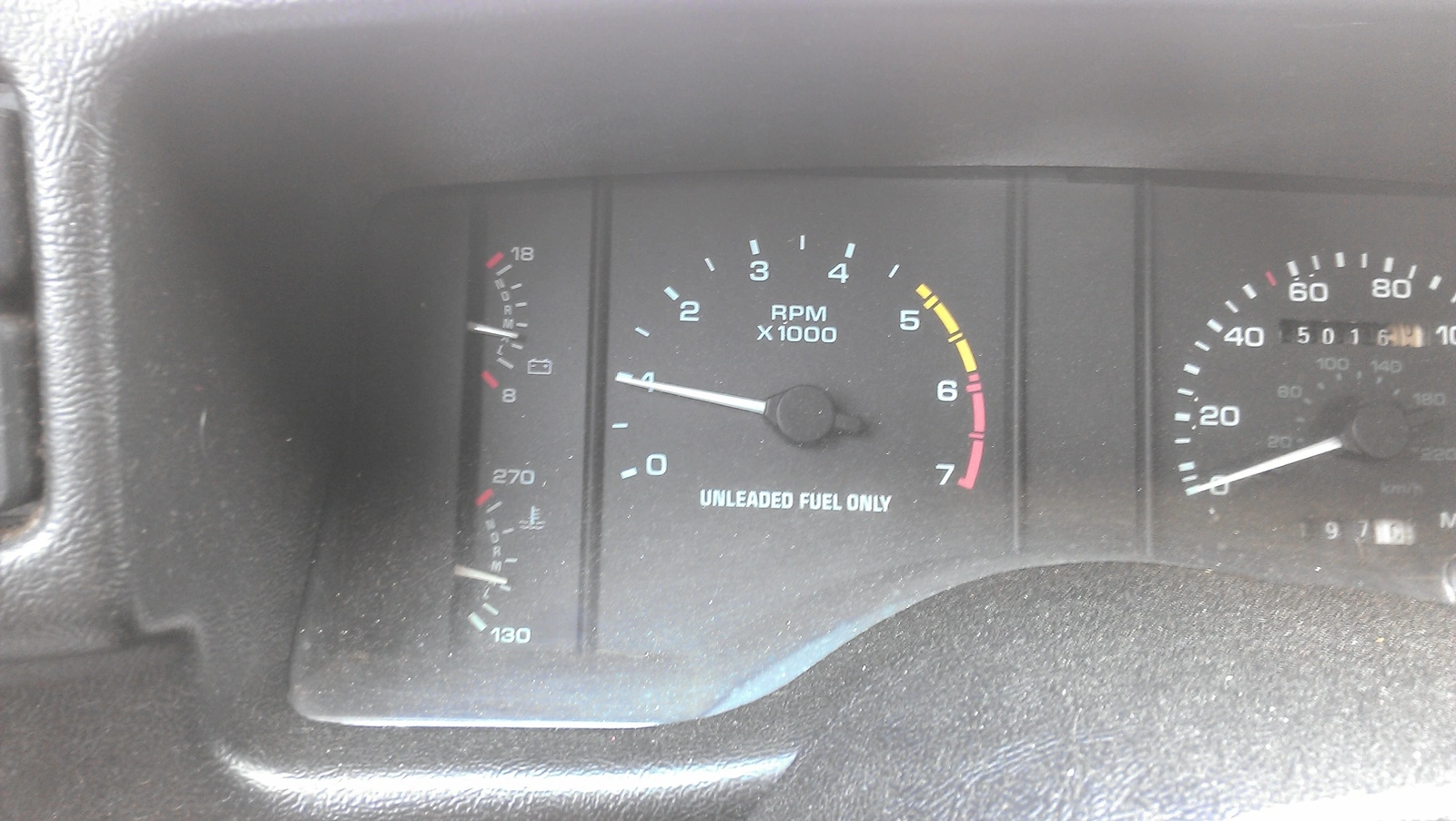

So AFTER getting the engine nice and hot, ran both pics at 25min at idle, the simulation of Dead Stop Traffic after the engine was hot and driven. So again, engine nice and hot, then let them sit for 25min at idle, then took the pic. First one is no a/c and the 2nd pic is with a/c. Turned it half and half with level 2 and full blast a/c max to really get it going. Outside temp 70*

Wow.My temp gauge never goes more than half way between the A and M even with the A/C on. You sure you got all the air out?
Water wetter works with straight water. It's a waste of money with coolant. Call the company and they will tell you the same.
Holy Crap it's Amazing :eek:

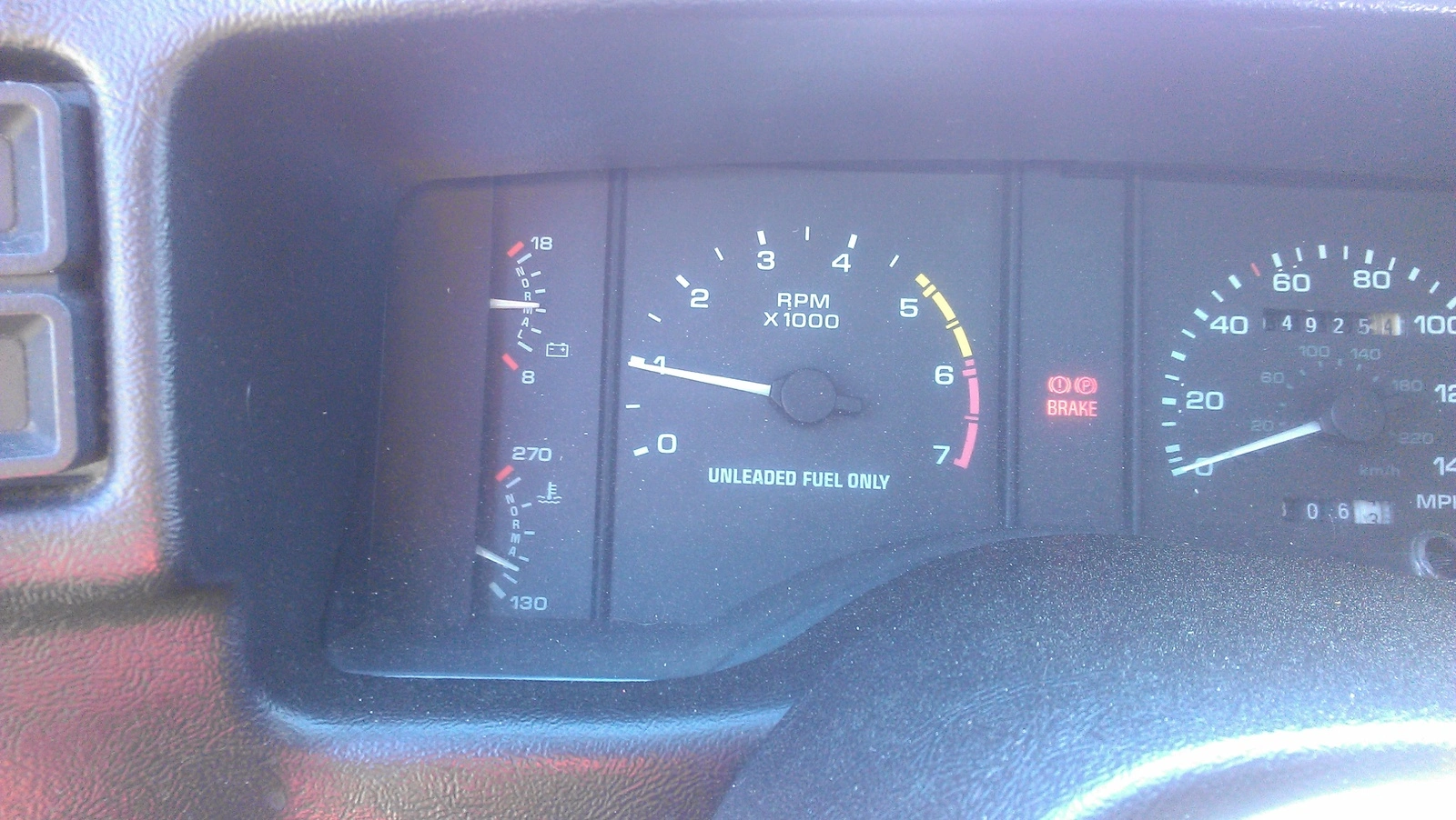

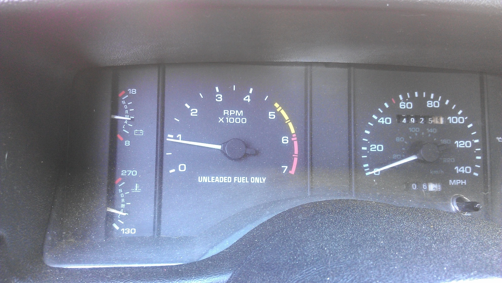

So I actually skewed the results, I put the Watter Wetter's feet to the fire and upped the outside temp to 80* cause that's the temp when i finished, so hey why not, i was curious anyways.
So here they are and I did it the same way in 80* weather, hot motor and then they idled for 25min with some revs to 3000ish rpms and I will post my formula after the pics but Holy Sh!t it worked better in 80* weather, couldn't have had better results ftom this experiment.

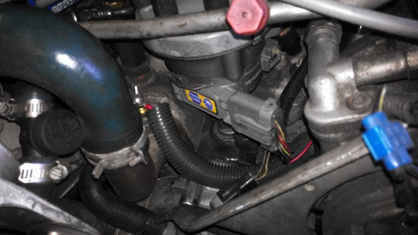

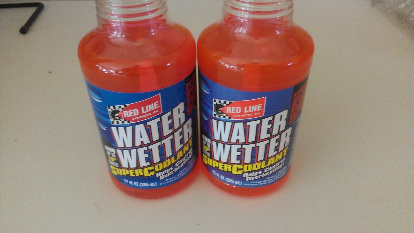

Also a couple of points i would like to add, seen online before i bought my 2 bottles, a few bottles that seemed pink in color. Mine were red from the zone store, just wasn't sure if it was another product or just the lighting online. Also the prestone t-adapter has been installed on my car since '97, never had one issue with that line or fitting. Even when I did have a rare puk happen long ago, it came outta' the radiator cap. Here's a couple pics of the product i used and the location of my t-adaptor in the coolant line. I'm pretty floored by today's results and if anyone wants to check it out in person in Atlanta, Ga just hit me up see this thing in action, best $20 I've spent in a LONG while. Hope this helps someone else with high a/c temps.
wont running that cool cause rich burning issues? not to dog you or anything but I wouldnt trust the stock gauge to tell me anything.
I know the stock gauge is not the best way to determine the actual temp number so I'm just using it as a reference point of difference. I have no idea what it is right now but from the change of it's characteristics just tells me it works. Obviously I have no idea of actual temp but I'm gonna try and get a better gauge later. But I do know this, when I did have the 180* t-stat in a while back it's a tad higher now than when it was installed, and it was rich then thats why i took it out cause it was so rich. But it's higher now so i feel like it will be ok. So I need a temp measurement, can I use a thermo light gun on the t-stat housing to find a close temp??

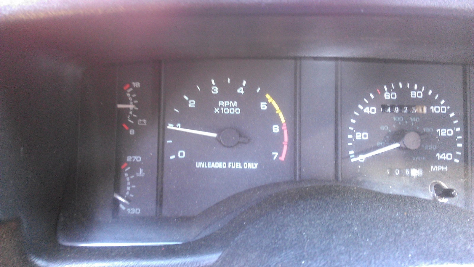

Update:
So this a/c pic is probably more accurate, had to travel 45min on the freeway then drove 10miles in red lights, traffic etc with the a/c kickin' all the way. Took this pic at the end of the 10 mile part. But still pretty happy :D
Thanks for posting your findings. Whether we know the exact numbers or not - we can still see it works.
On a side note, I used to live up north, so I understand the a/c on at 80*, but at the same time having lived in PHX AZ for the last 14years it does sound kinda funny.
I need to get a proper gauge for mine too.
