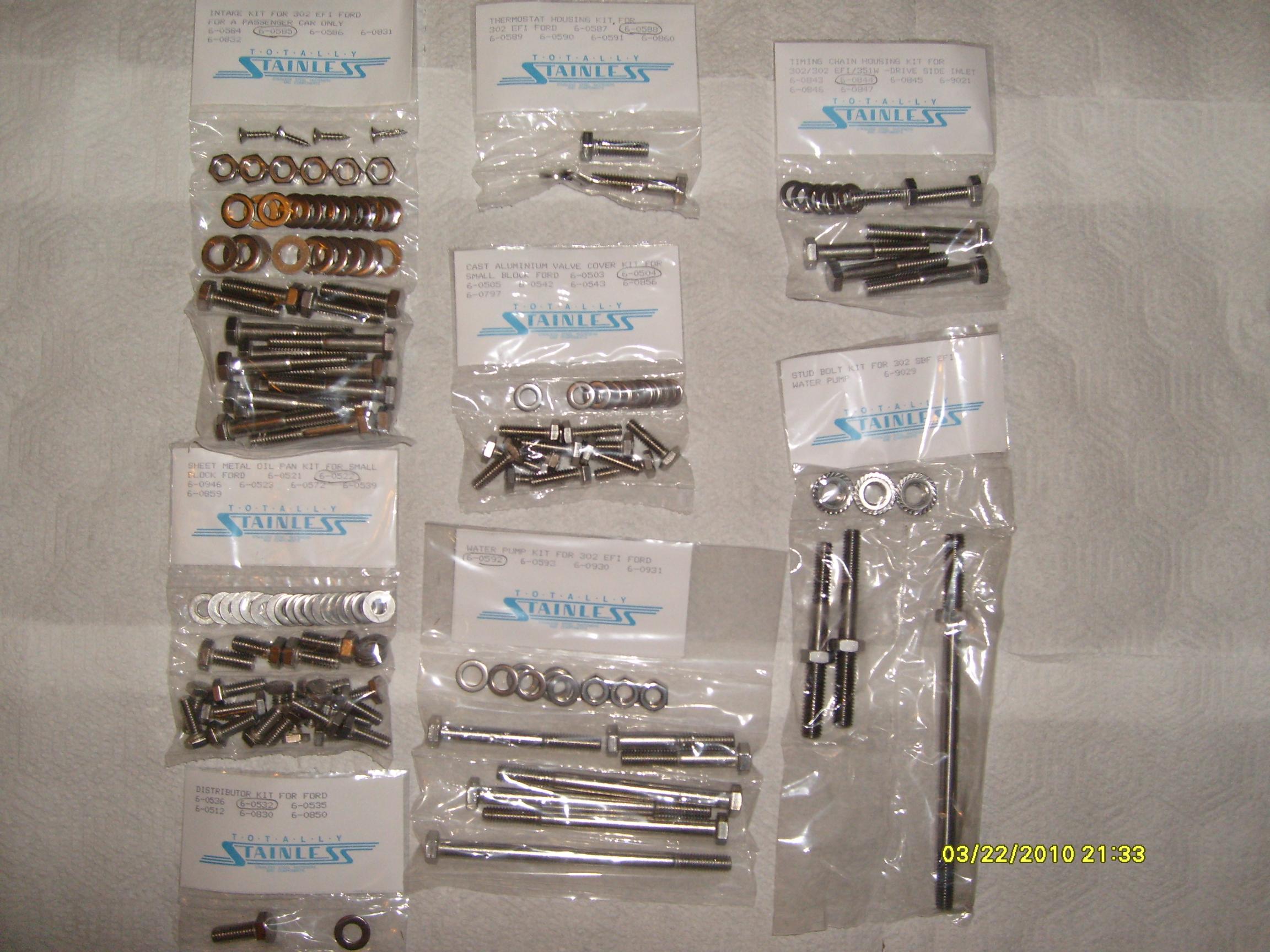

Here are the bolts that Totally Stainless ( Totally Stainless ) has:
http://www.veryuseful.com/mustang/tech/tmp/TotallyStainlessWaterPumpBolts.jpg
As I remember, I got the "Engine Kit 5.0L EFI SBF" (6-0897) (~$45), and the the "Stud Bolt Kit for 302 SBF EFI Water Pump" (6-9029)(~$30). Plus, ~$10 for shipping and handling.
Check and verify those numbers and prices before ordering!
Also, it took ~5 weeks before I received them.
So, if you need something now, I'd suggest asking before you order!
I took care in taking that picture.
All of the the packages are labeled. You can see what bolts are in each package, and what the package part number is. Something that I wish that Totally Stainless would do for their catalog, or web site.
It all depends on what bolts you want. If you want just the water pump bolts, it seems like kits 6-9029 and 6-0592 are all you need. Check their catalog, or call, for prices on those kits.

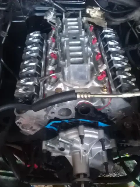

I traced the new water pump shape on a piece of cardboard. As I took the stock bolts off I pressed the bolts into the cardboard. This way I knew where they went. Each bolt is a different size.
Yea, there are a few sizes and types. :)

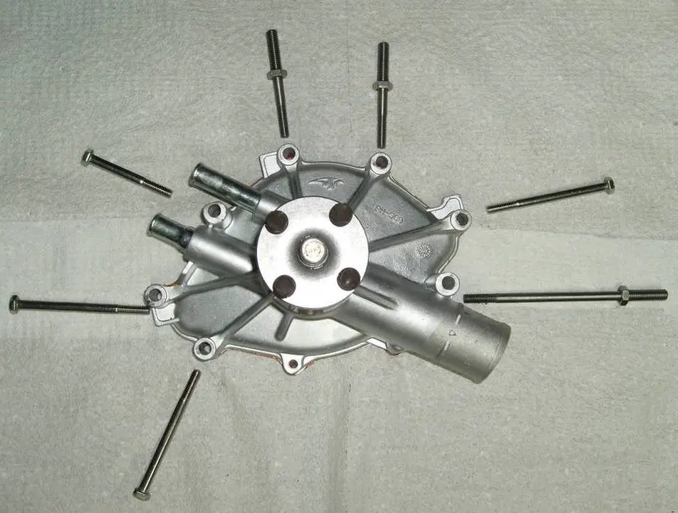

Specifically, there are 4 different sizes/types for the 7 bolts/studs. :-O
I found it easier to look at a picture that someone posted, verify that it was correct, and use that.

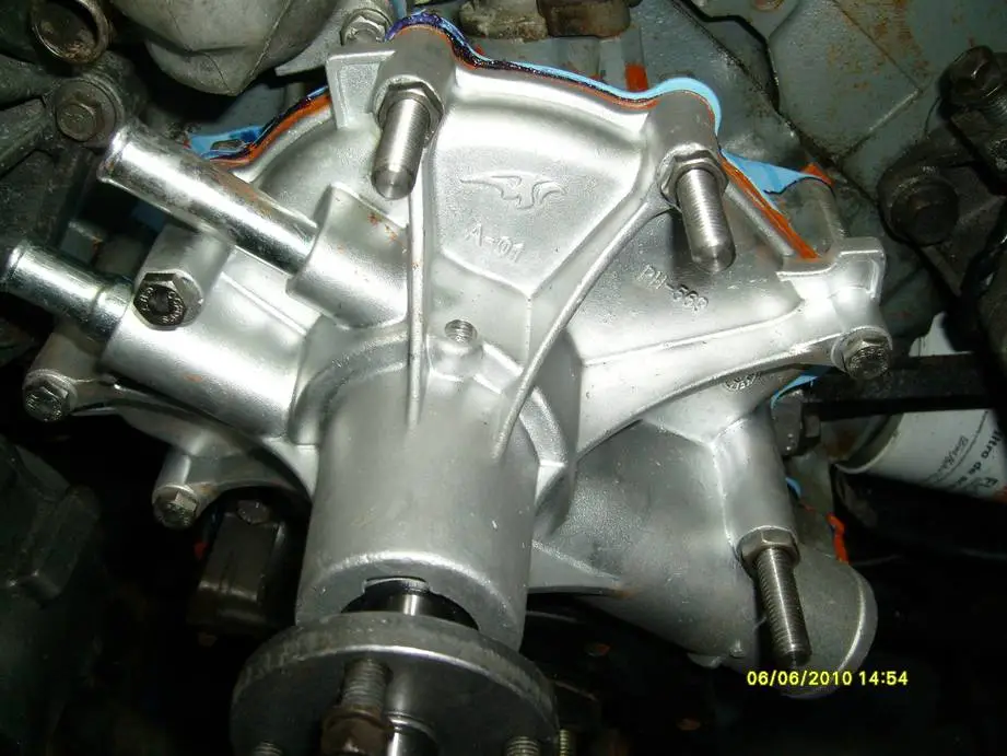

I find the picture I took easier to see the differences and locations:
Installed:
