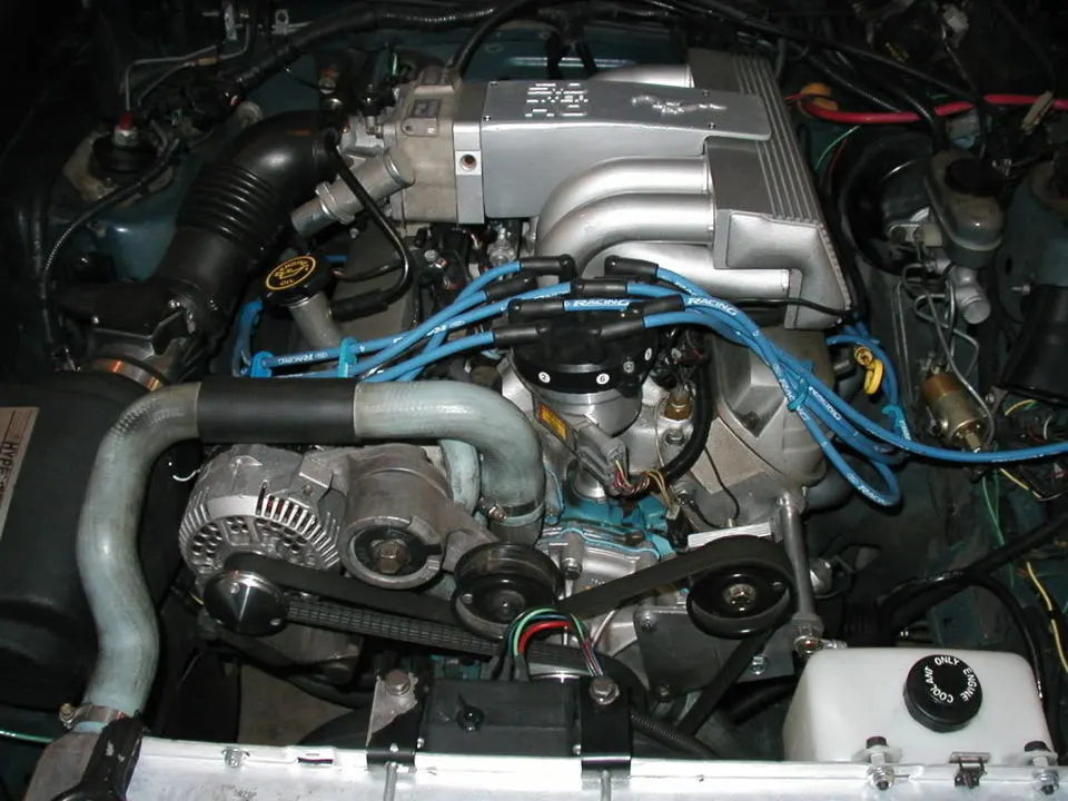

Here's what I did...
I went and bought the ford kit for a/c delete FMS-M-8511-A50. It moves the power steering pump into the place where the a/c compressor was. The smog pump didn't matter.
So now I just use a short belt.

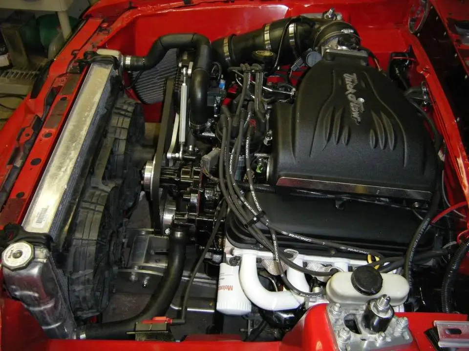

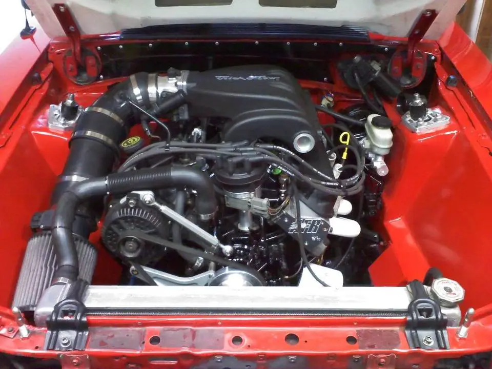

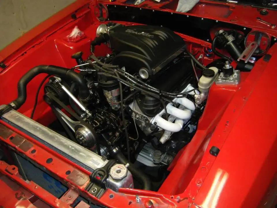

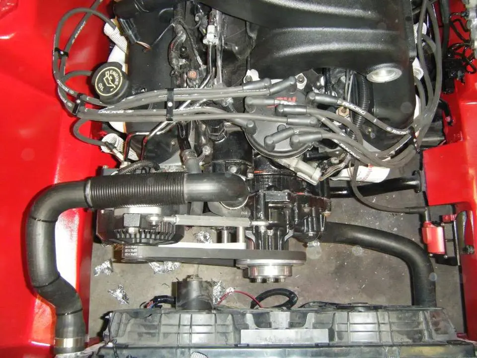

I would say unless you buy one of the a/c delete kit pulleys or an idler pulley to mount somewhere on the drivers side you will have to.
I have only the crank, alt(mounted on the drivers side) and water pump and I went with a standard rotation pump and deleted all the brackets and tensioner. I have the moroso kit for my alt. which came with a turnbuckle for belt tenstion.
Go to autozone and ask for a water pump for a 1990 town car. it will look exactly the same as a 5.0 but the impeller and flow channels will be like the one above in the pictures of this red mustang. Its like 40 dollars.
