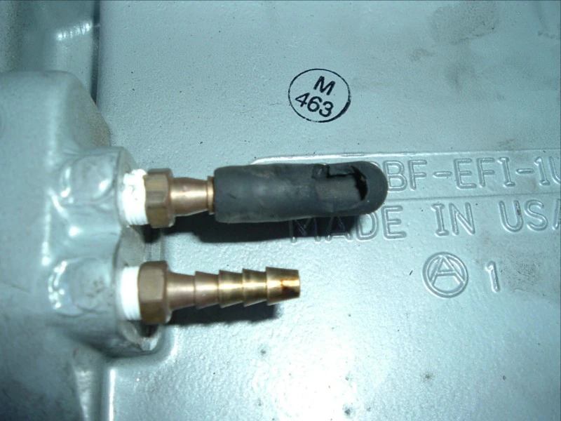

another thought, maybe the hose to the fpr came loose or has a leak? my tfs intake was leaking because of this ...
good luck and keep us posted.
