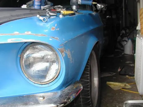

How much is too much? I thought mine looked "too much" after I did the same mods as you, but a trip to the alignment rack showed only -1/2 degree, which isn't really that bad for a street car. I have the eccentric eliminator kit adjusted all the way in, and no upper shims except for the reinforcement plate that Pro Motorsports includes with the wedge kit. Tire wear on my 50-series tires looks pretty even.
edit - found an old pic showing my camber
