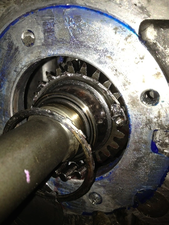

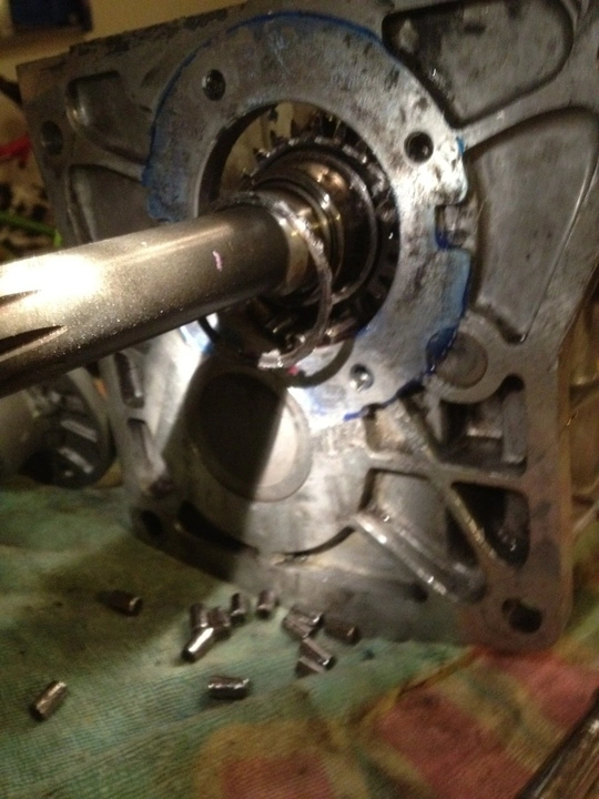

Ok, it's a late up date but none the less here it is, I finally got the T5 back out and opened up and much to my dismay. I would consider myself pretty lucky in the grand scheme of things, I was looking and expecting to find complete carnage or something so little it would not pop right away. What I found as it was staring me right in the face was a twisted and mutilated front input shaft cone bearing.
So I have ordered a new cone bearing and because the inner bearing race was cooked.....would not budge under a 20Ton press, I am also getting a new input shaft.
