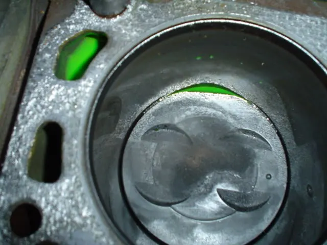

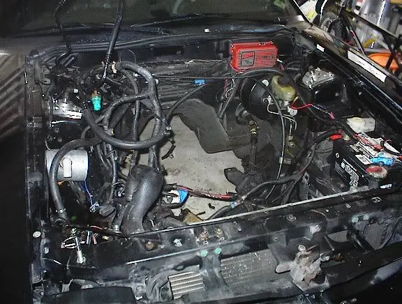

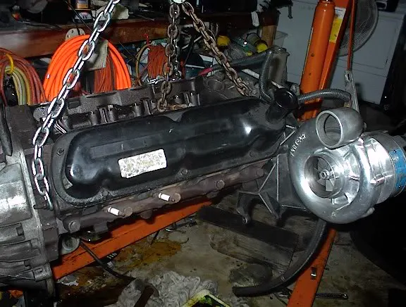

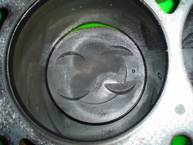

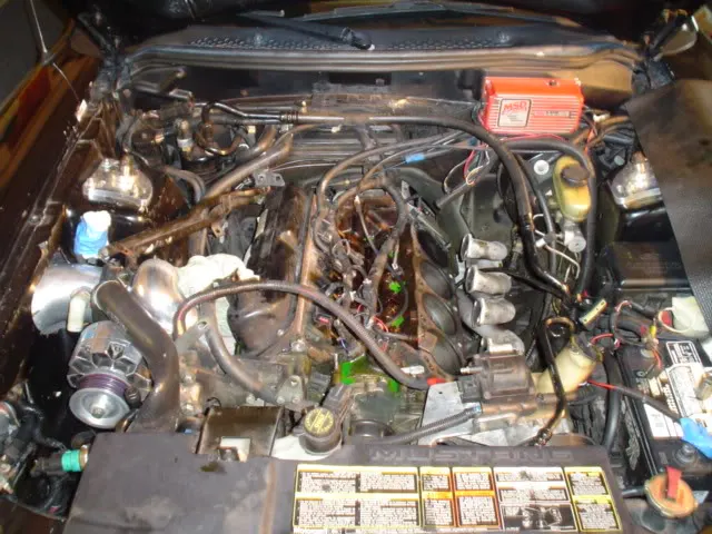

Blown headgasket, number 2 of 3 total

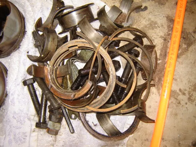

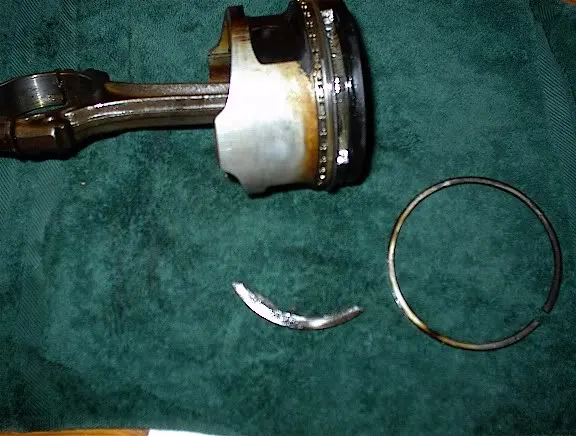

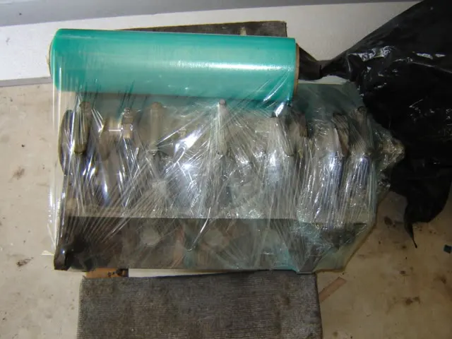

RIP 94 Engine

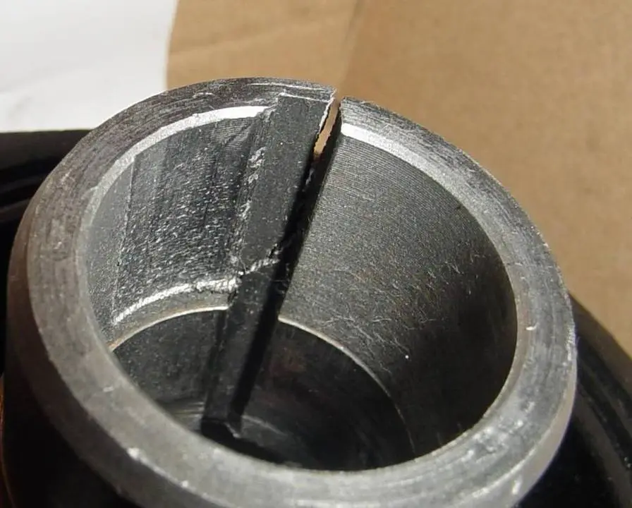

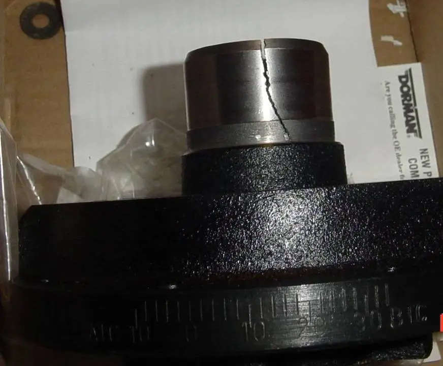

If you get a replacement balancer and it goes on too easy, Chances are there is something wrong with it.
Here is what my replacement looked like after 1 week.

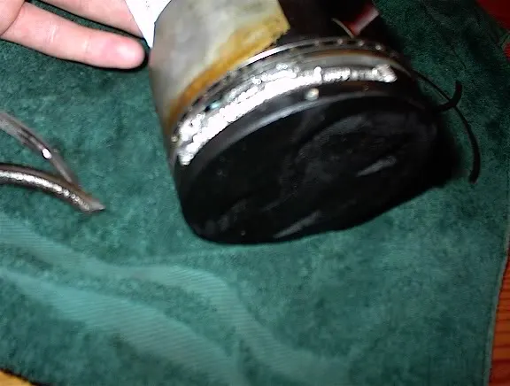

Dude, it was a very stupid thing that happened. Partially my fault. My timing and nitrous tune was not the problem. I had the correct plugs, had the timing backed up properly for every 50shot, etc. I had all the safety devices but the main one was the one that screwed everything up. So I still dont know what nitrous really feels cause the one pass that it did work, I almost hit the wall like 3 times cause I was going all over the place with the slicks on and off throttle. Too much torque.
Anyway, when the WOT switch jammed up, I ended up spraying 100shot STANDING STILL, reving up the engine to 5000rpm ready to launch...And then you know the rest..
I'm not hating nitrous because of this, cause I know it's basicly my fault. My custom made plate was the problem.
