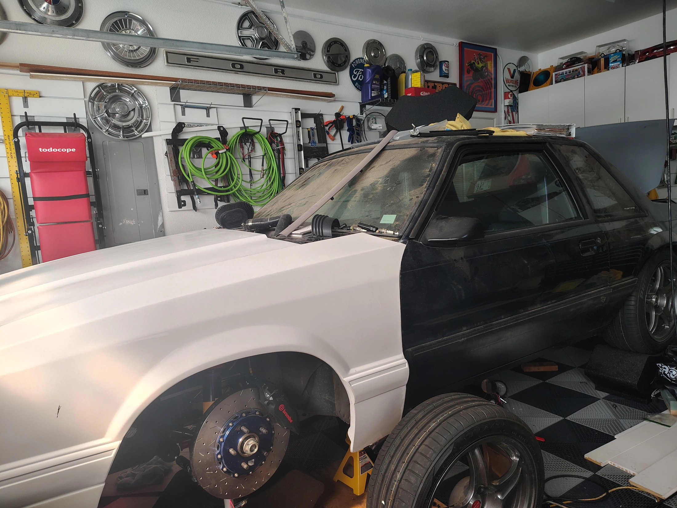

Progress Thread Weight loss 90s coupe . -500lbs

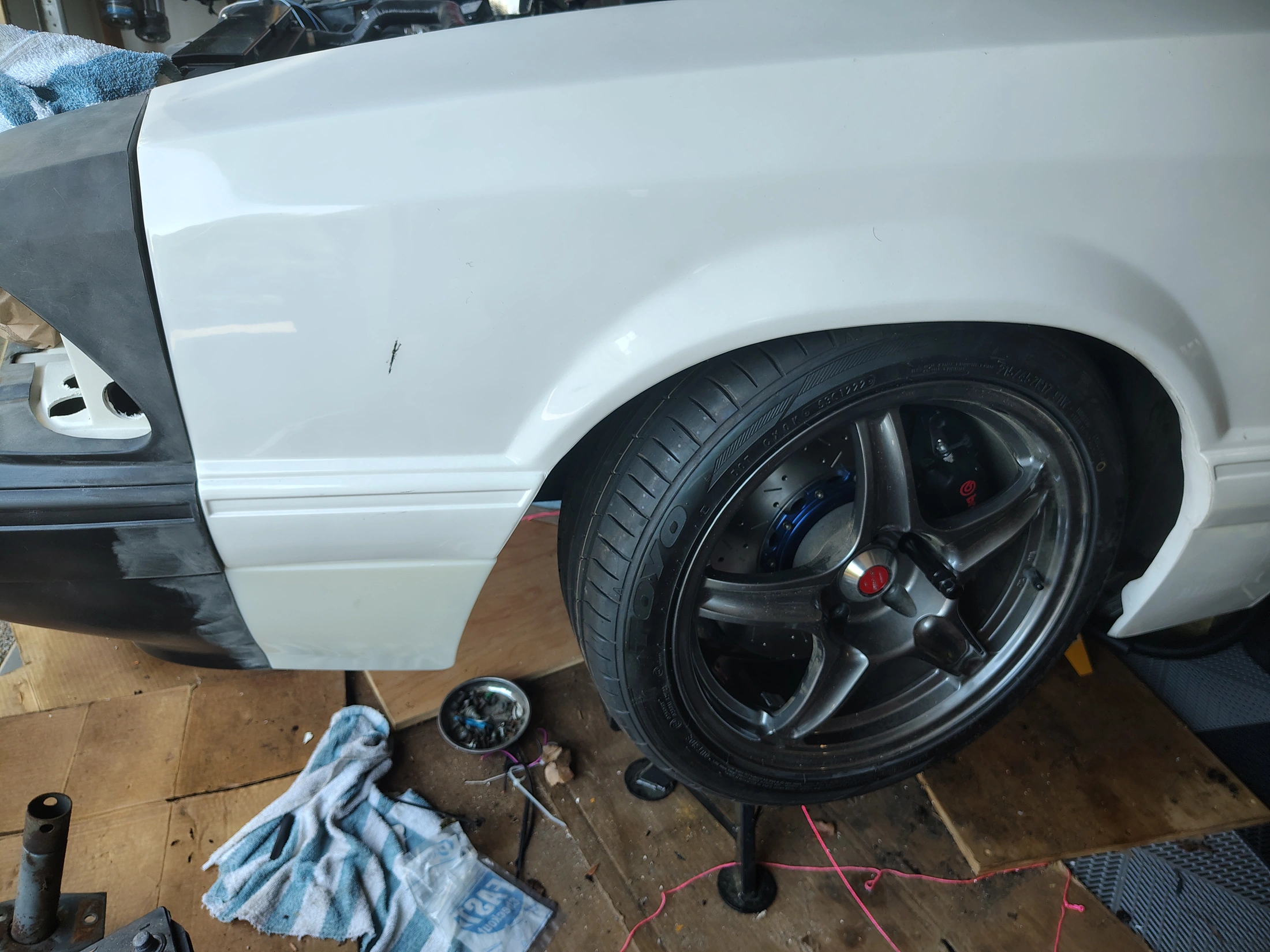

I am not hard core on the tenths of pound or ounces. My view is if I am going to replace a part or piece why not buy the lightweight item but there is a limit to how much cash I will burn thru to lose a pound..But that doesn't stop me from doing stupid stuff like Fiberglass fenders $$

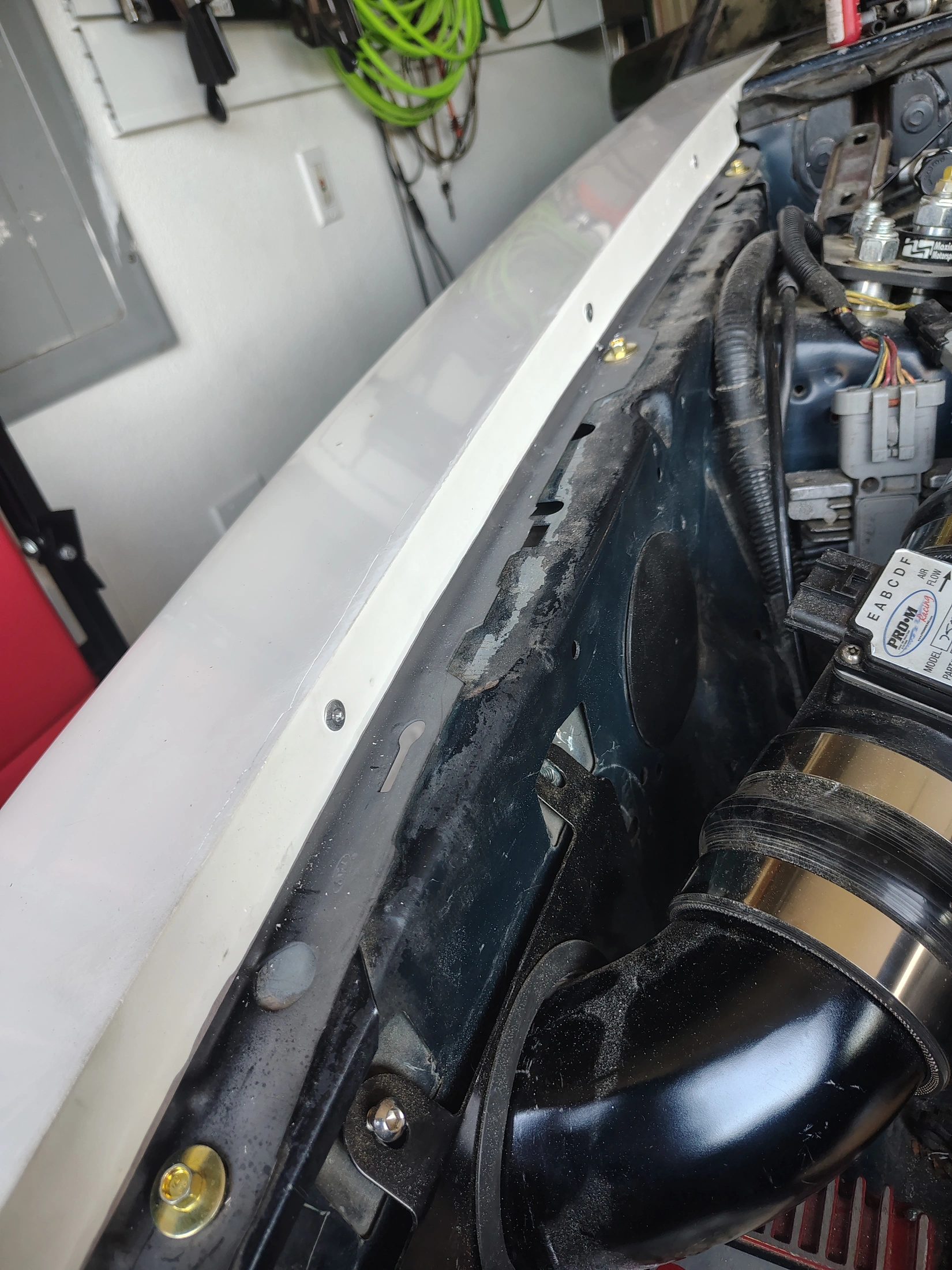

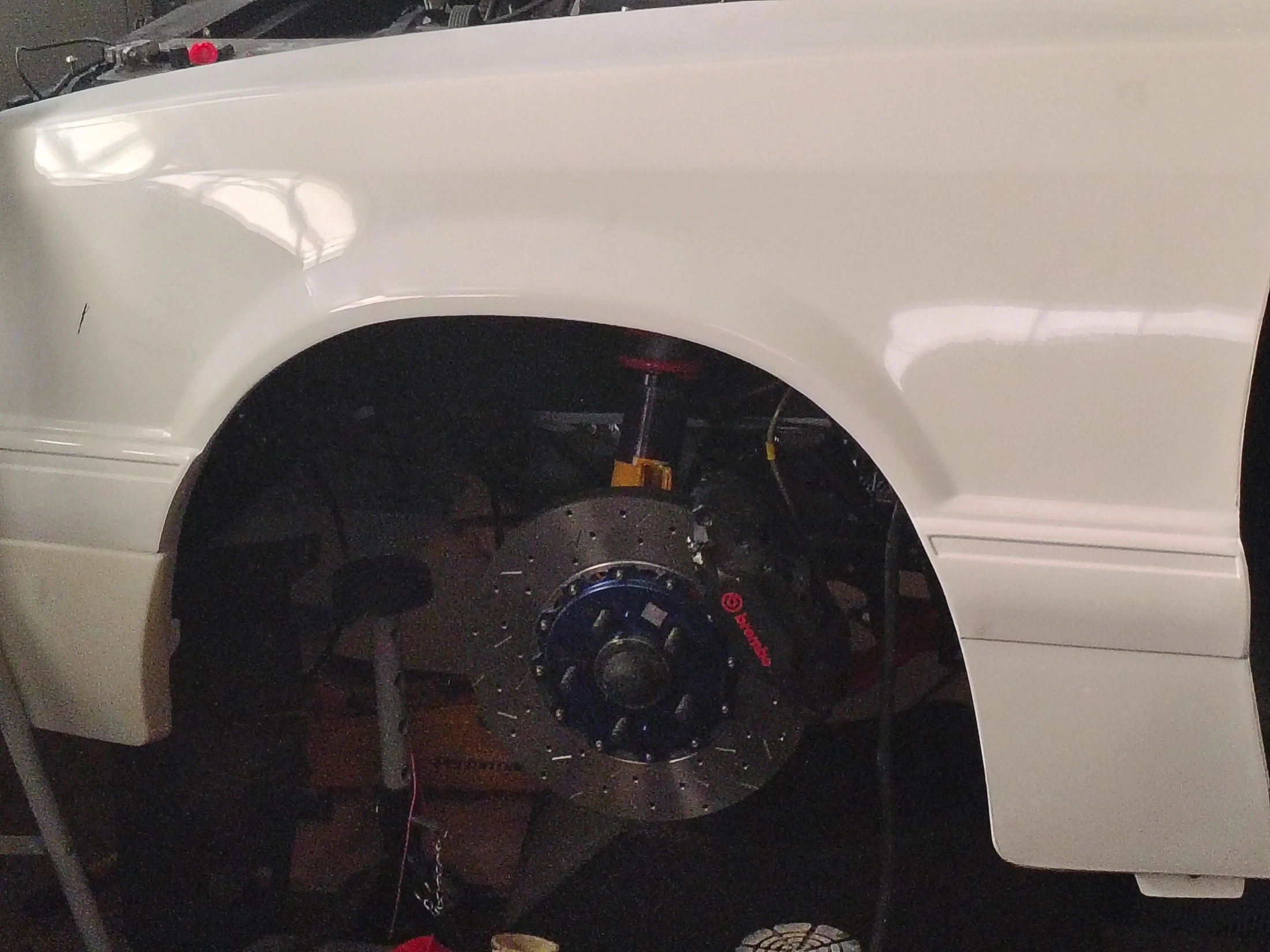

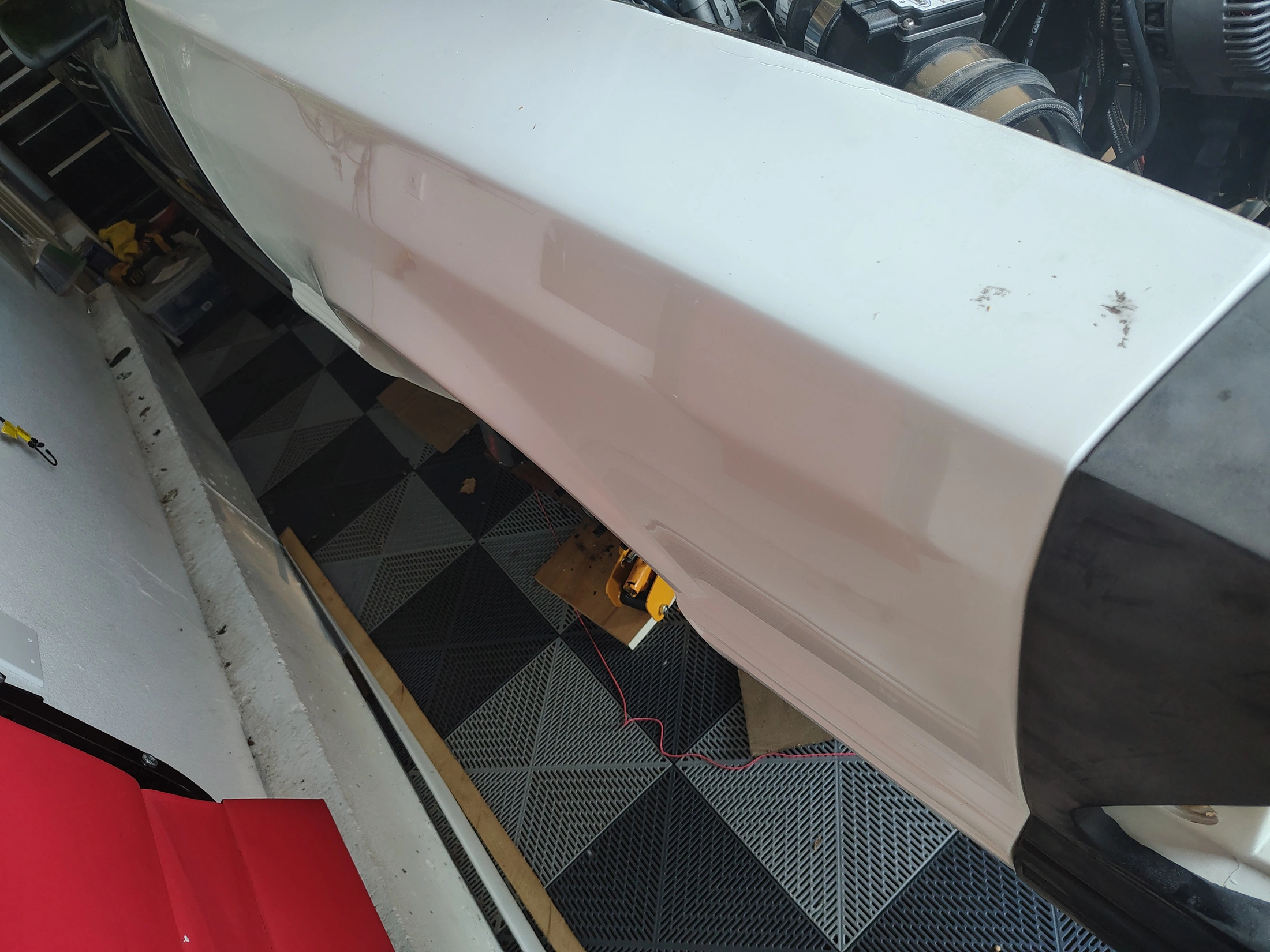

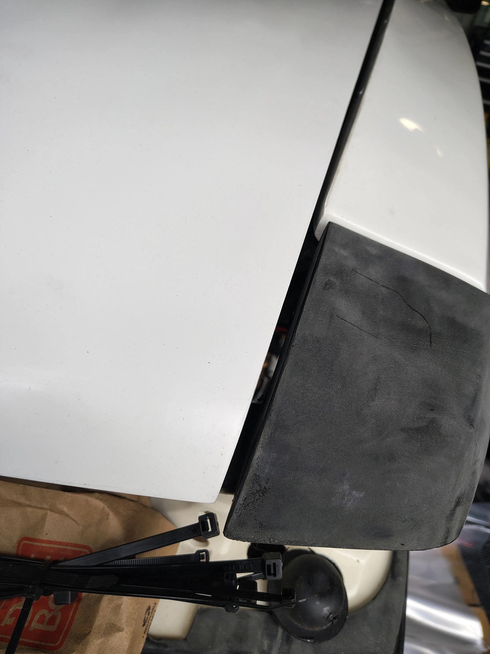

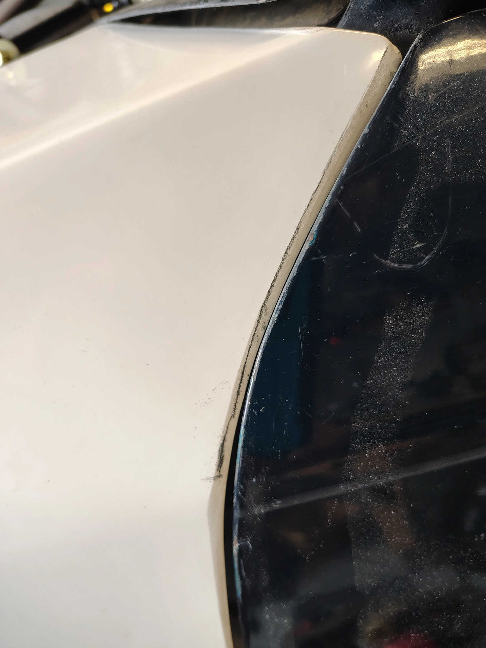

How is the fit and finish of 'fiberglass' fenders
These are Jase fenders .I had to cut the inner fender lip off where it would bolt to the front clip so I could bolt the fenders on the lip was so bad warped it would crack when bolted down .So I had to just cut it off and use the metal structure off of a OEM fender and rivet it on to the fiberglass structure I have not donen that yet ..I have not completely fitted them up but everything else seems reasonable as far as fit and finish ...

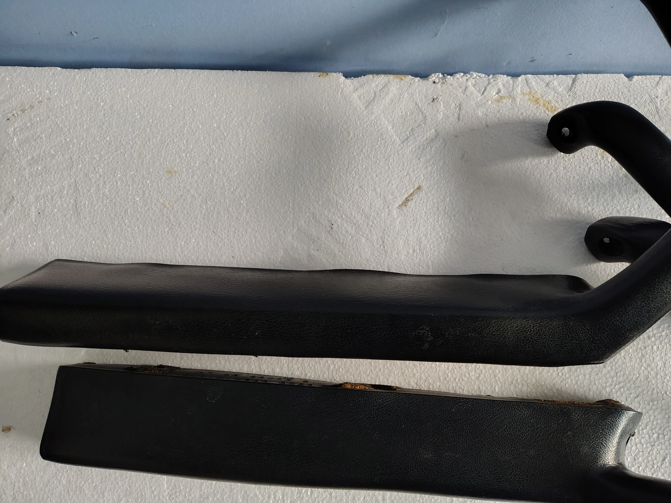

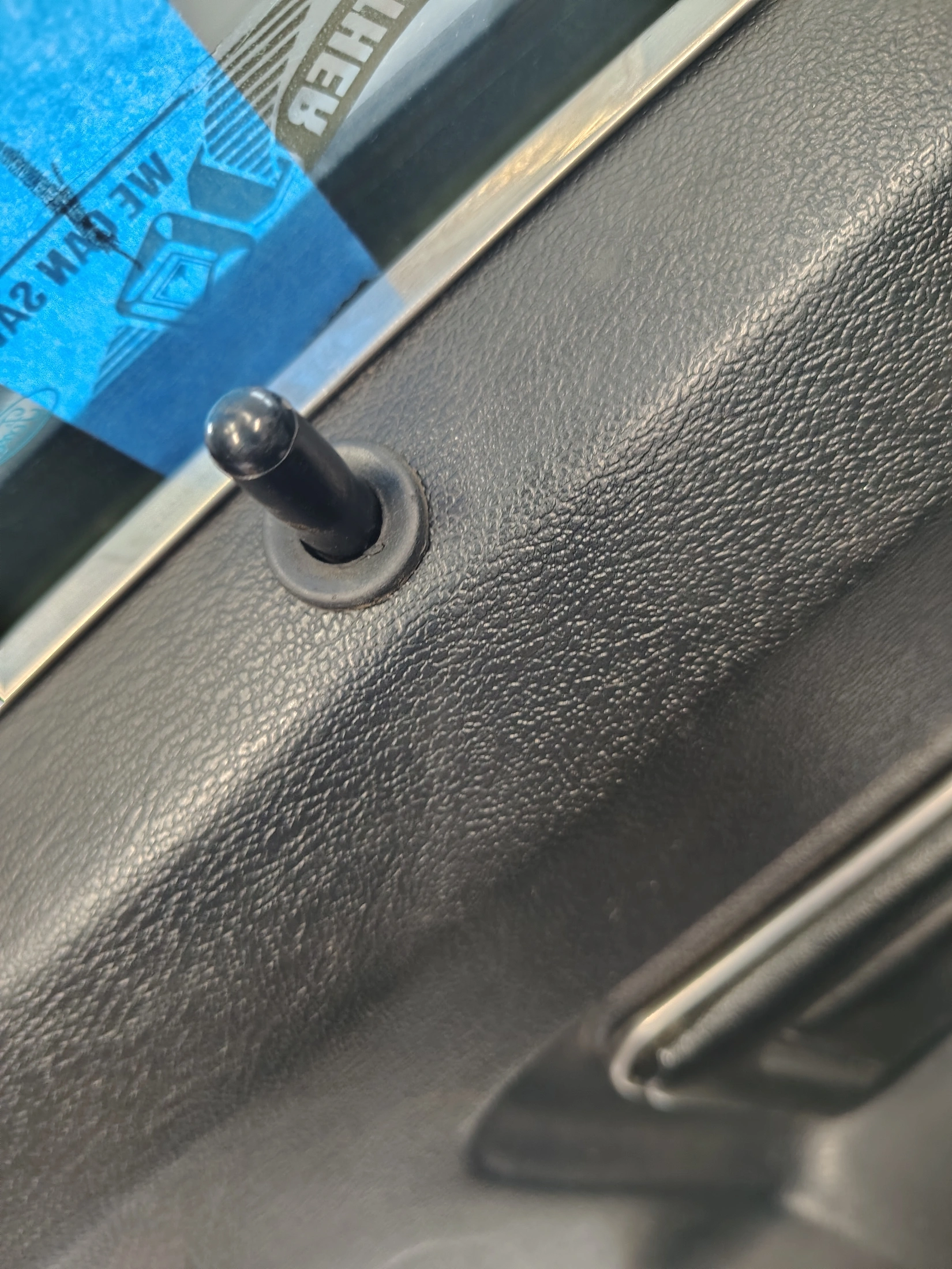

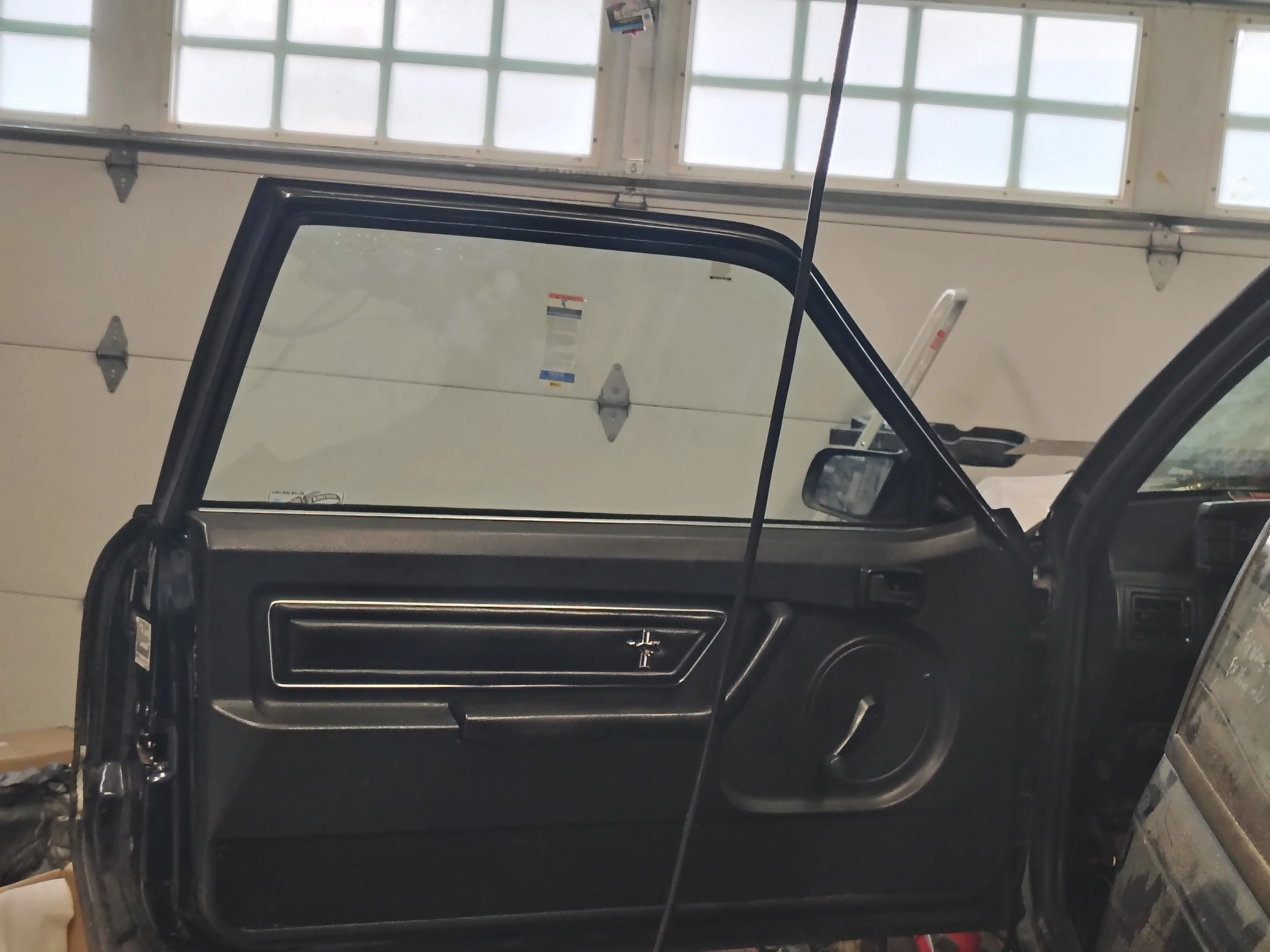

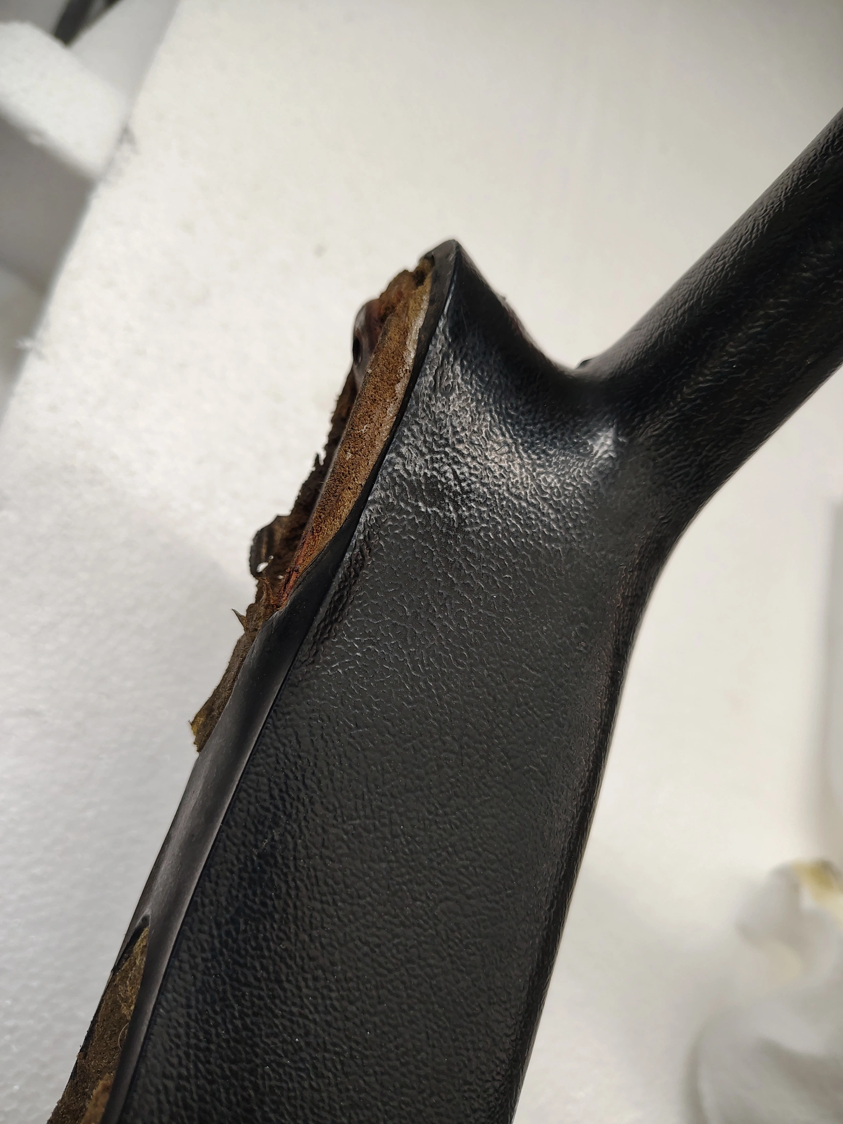

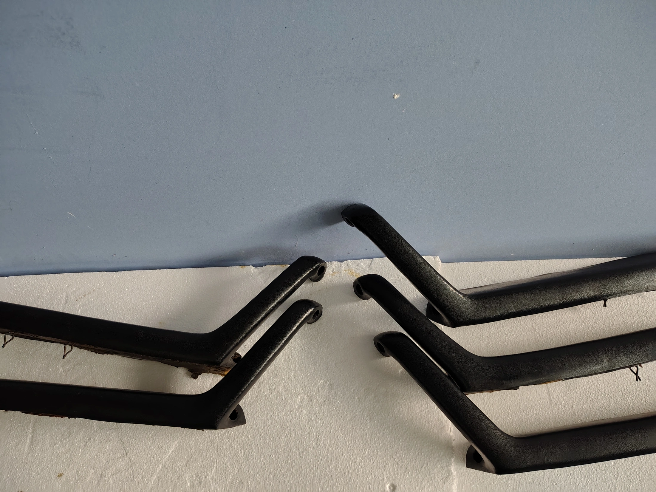

I have butchered up a set of very nice 79 only door panels to fit the upper door pull & the standard lock location for my 90 coupe & yes they are lighter than my stock 90s setup ..My question ❓ does anyone have any ideas on how to fix the armrest they are horrible wavy distorted from time Ihave tried a little heat and some contact cement .These are not reproduced sobyou get what you can IDEAs

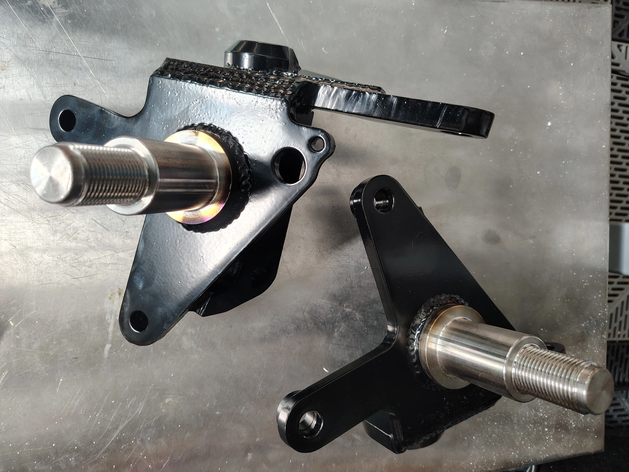

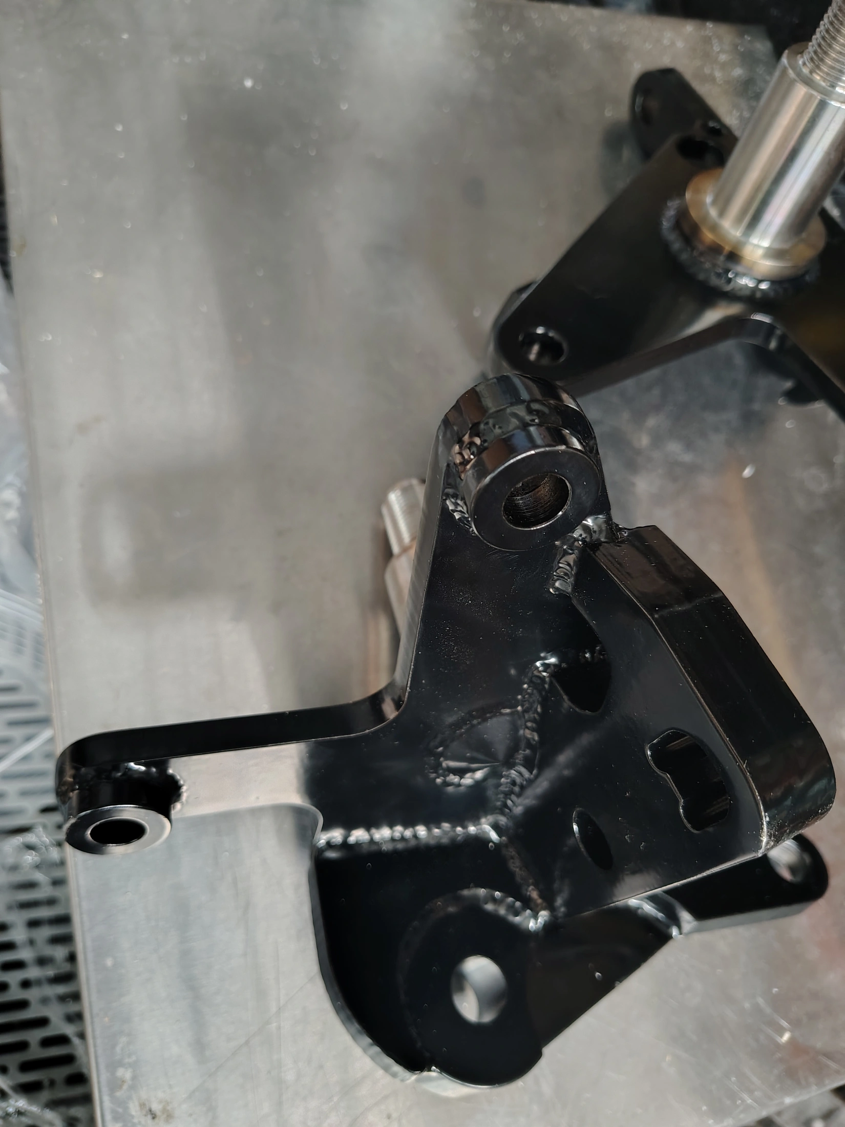

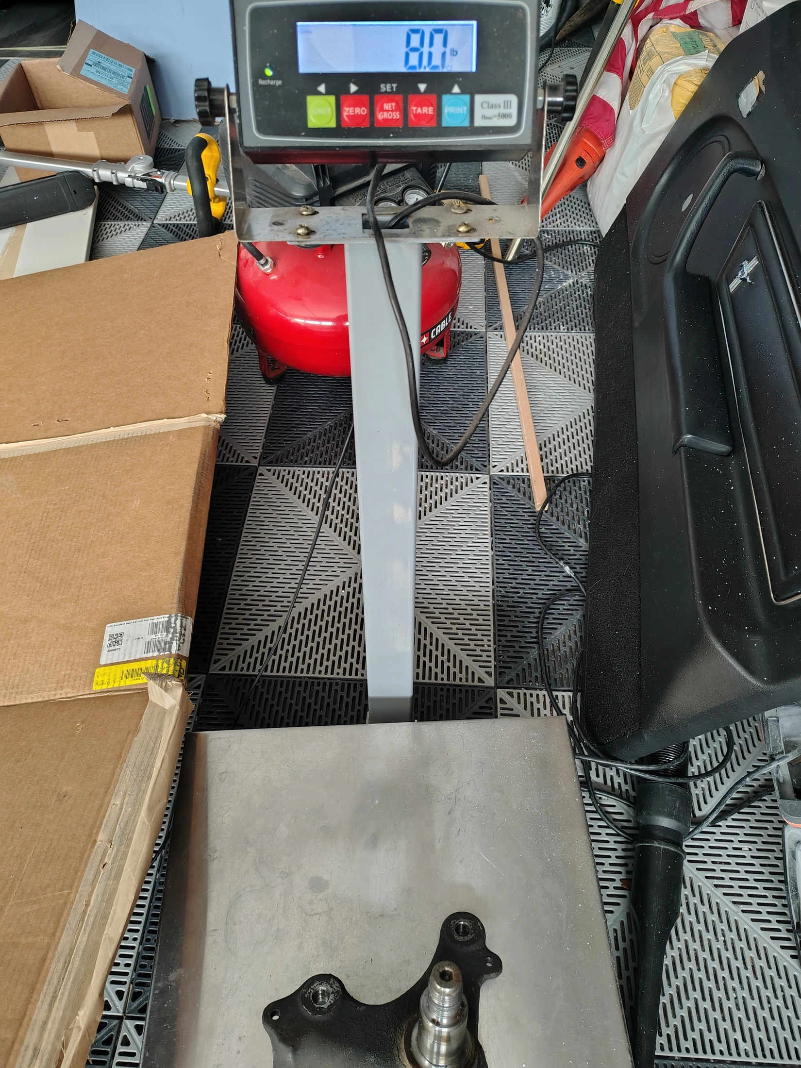

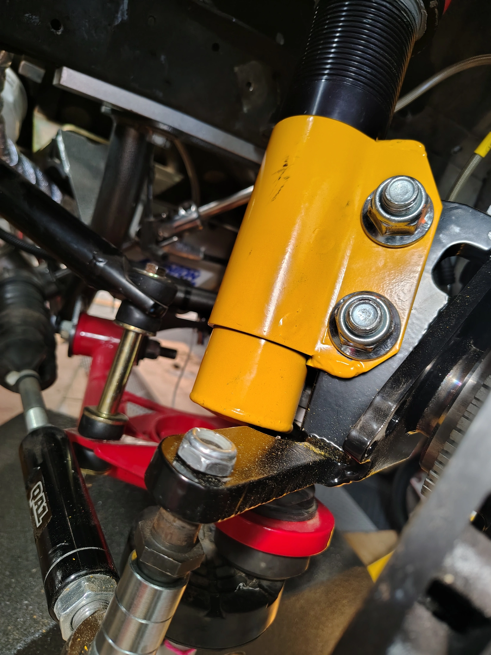

Another day another dollar spent on mustang parts AJE drop spindles ..They are nice & well built I know AJE is not known for hi quality...Weight 15lbs so there will be some weight savings every pound counts.. One weird thing they didn't discuss is they have a camber adjustment pin ... Now to get the parts installed
I did get one spindle in the weight savings about half pound per side compared to a Sn95 spindle ...The interesting thing is there's a company out there that's states there spindle weight and the stock fox spindles at 11.1 lbs. SN95 spindle weighs 8lbs each .I personally don't have a set of 87-93 V8 spindles to weigh .If someone has a set of 87-93 spindles laying around that they could weigh that would be awesome...I personally don't think the 87-93 spindles weigh 11.1 lbs it just doesn't look like there's enough meat there ..But if 87-93 spindles do weigh that much that would be a nice chunk of weight off the front end..

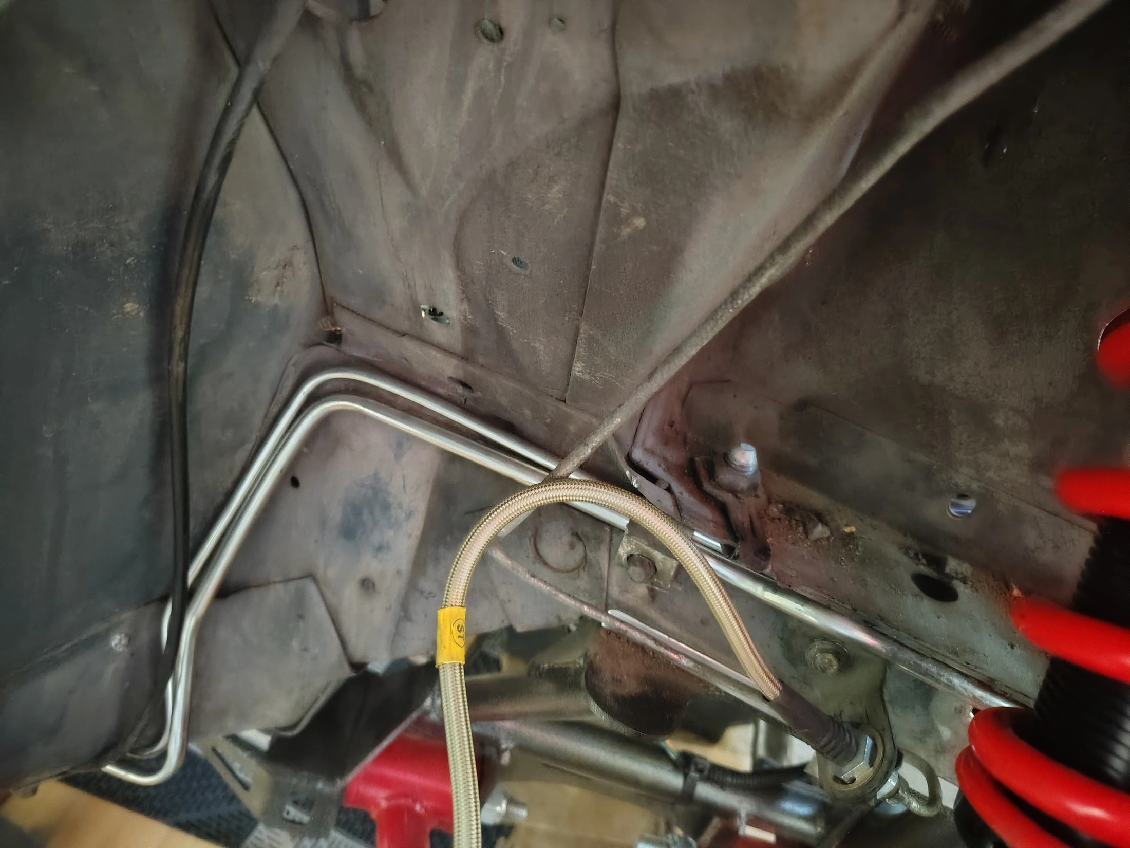

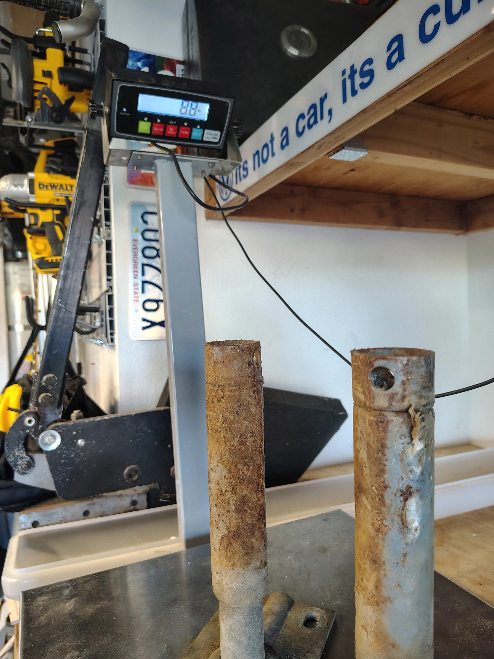

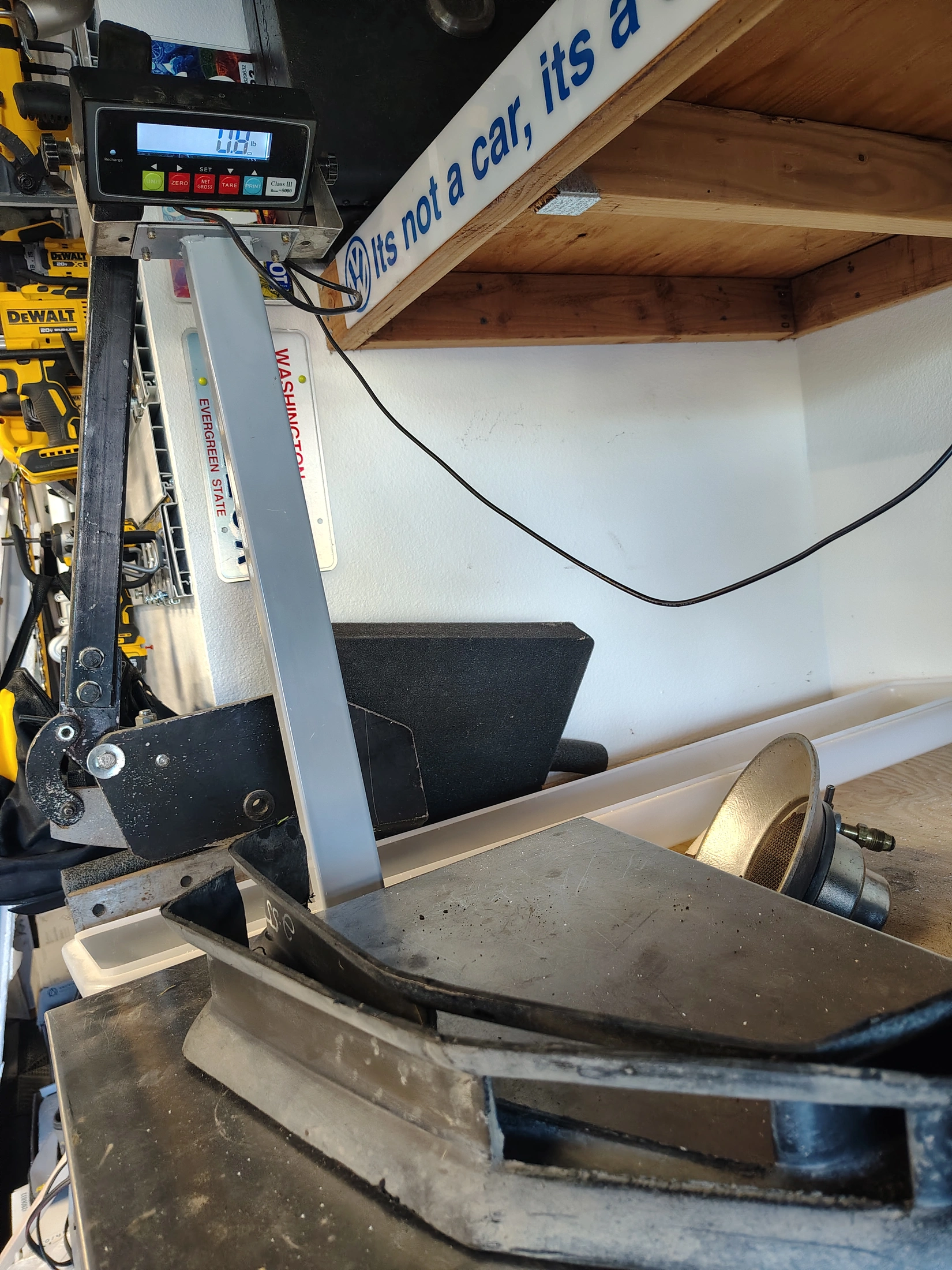

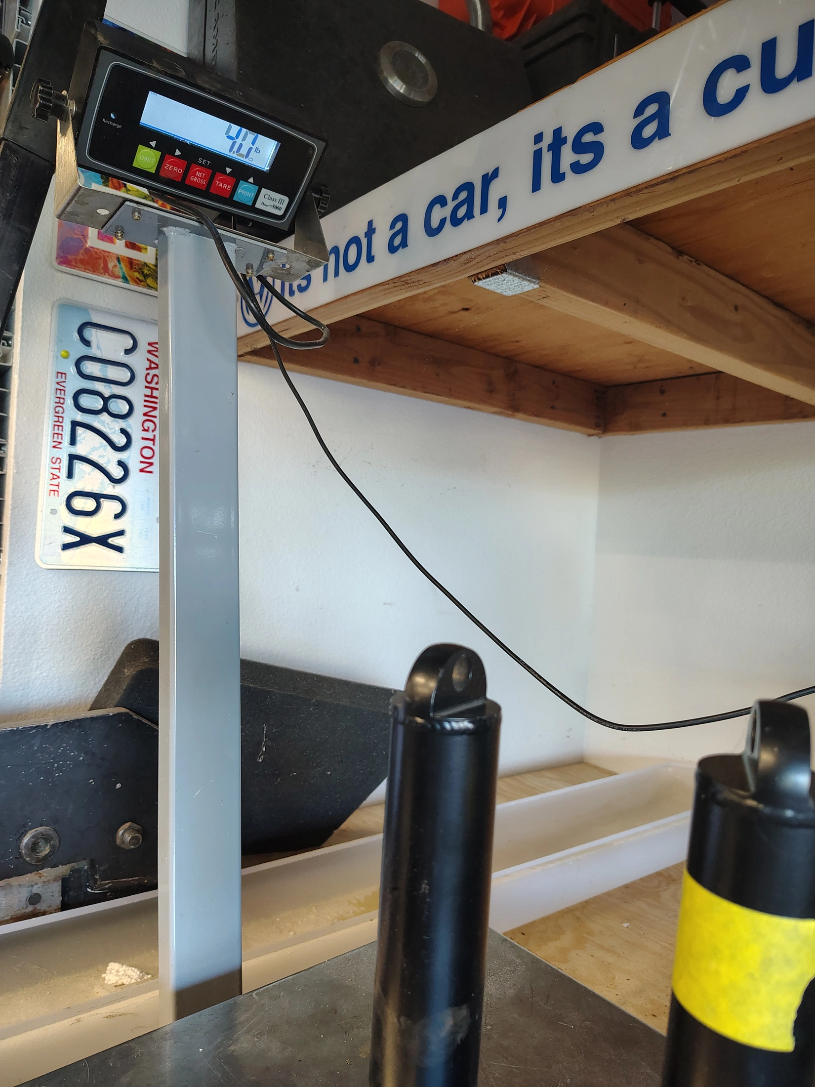

Today I got frustrated with fuel line fix/install and moved onto WEIGHT savings .Rear bumper brackets from rock solid did it meet rock solids claim of six pounds of weight savings NO there rear brackets do weigh 2lbs each but the rear OEM brackets don't weigh 5lbs each as they show in there photo they weighed the brackets with the install hardware ...My weight shows 4lbs for two rock solid brackets & 8.8lbs for OEM brackets minus hardware ..

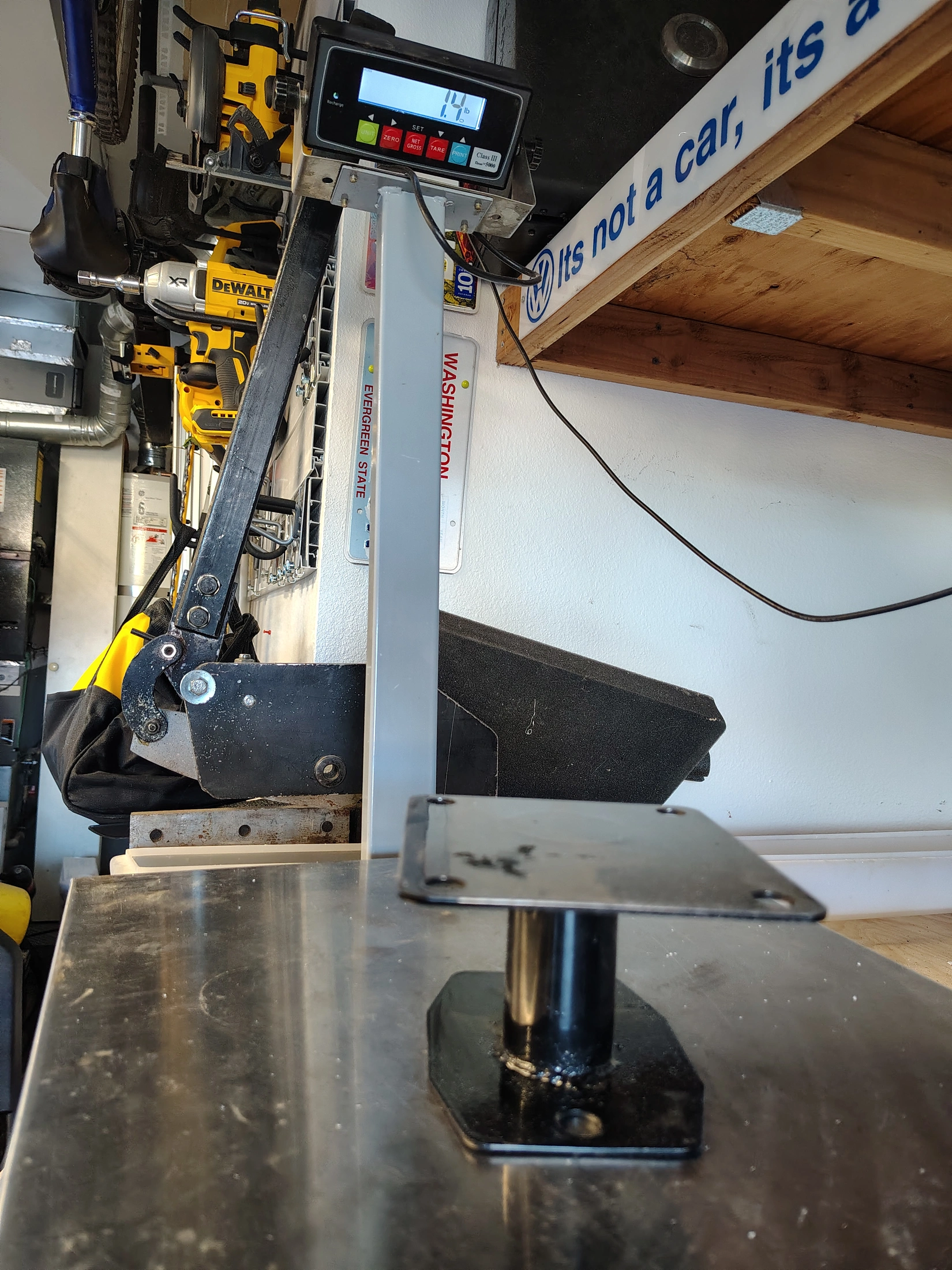

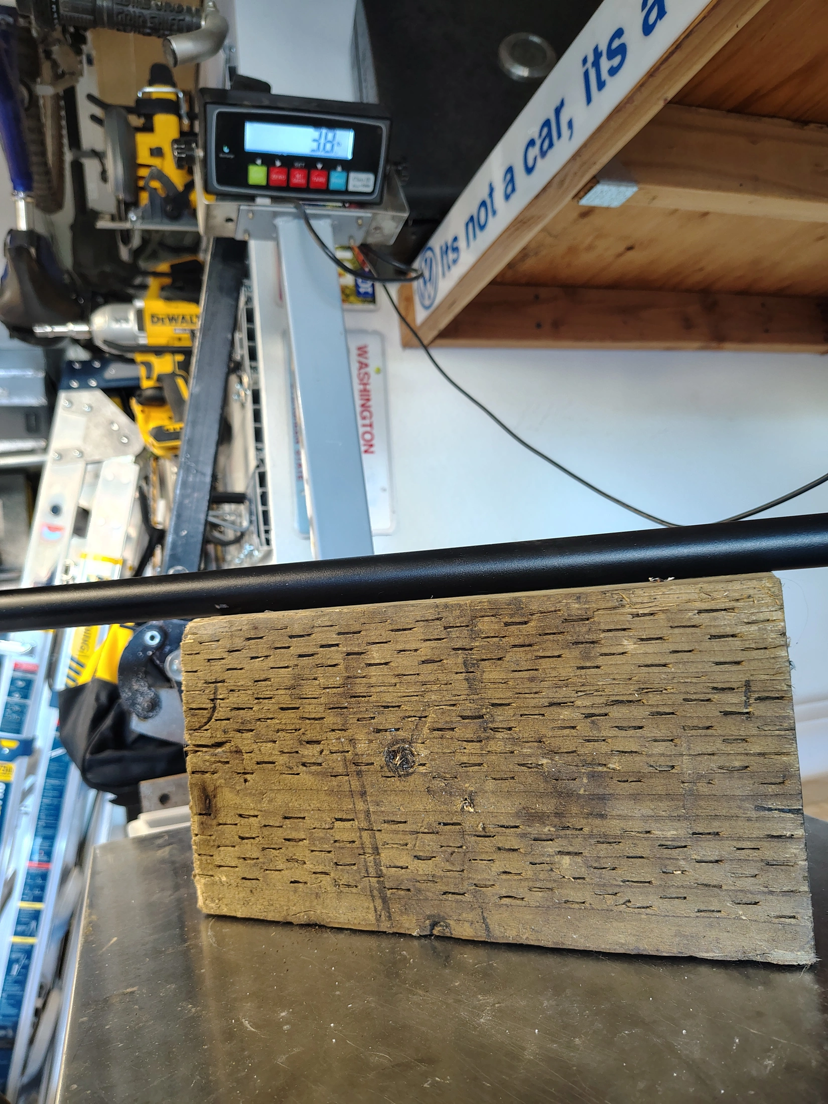

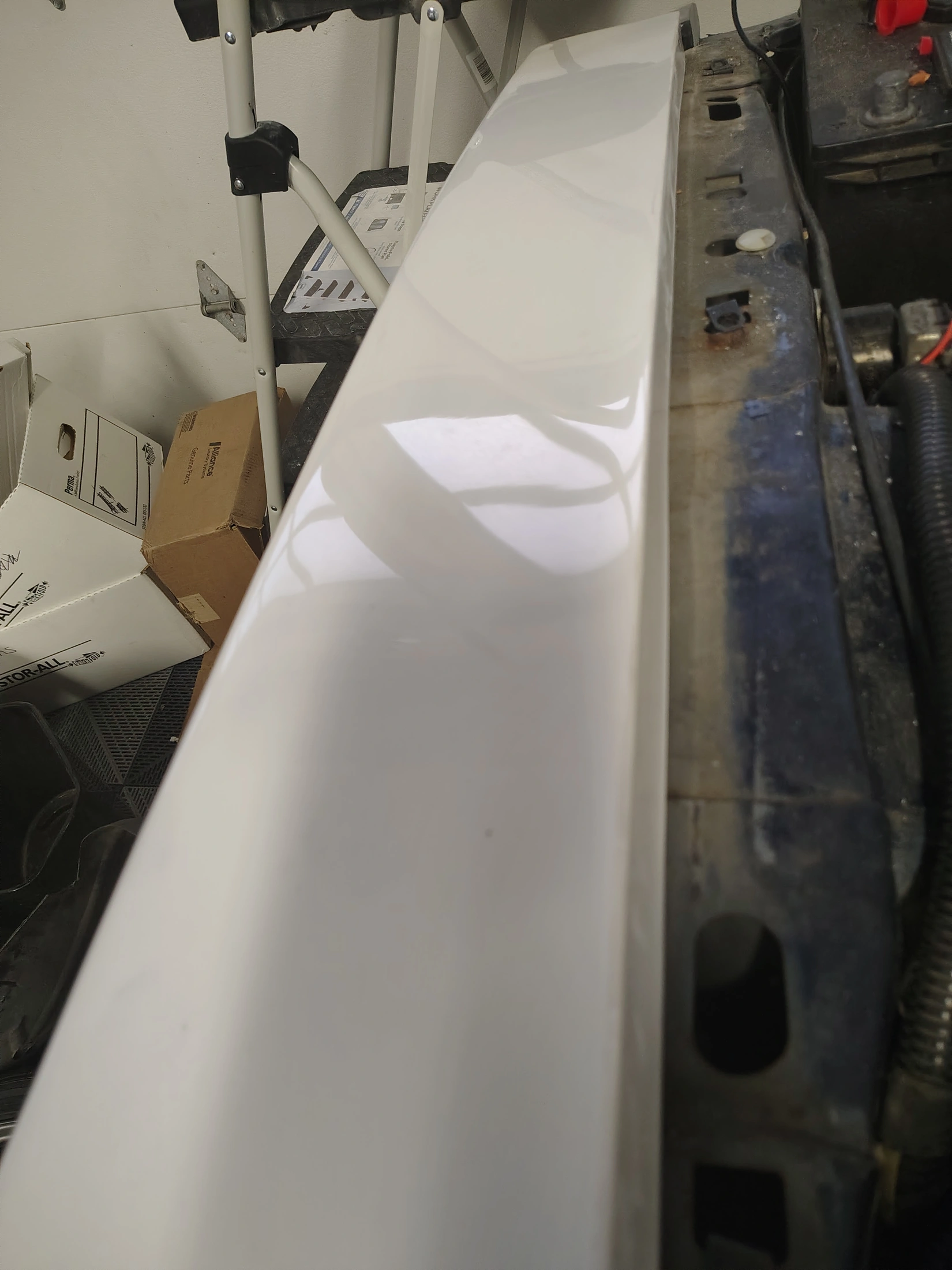

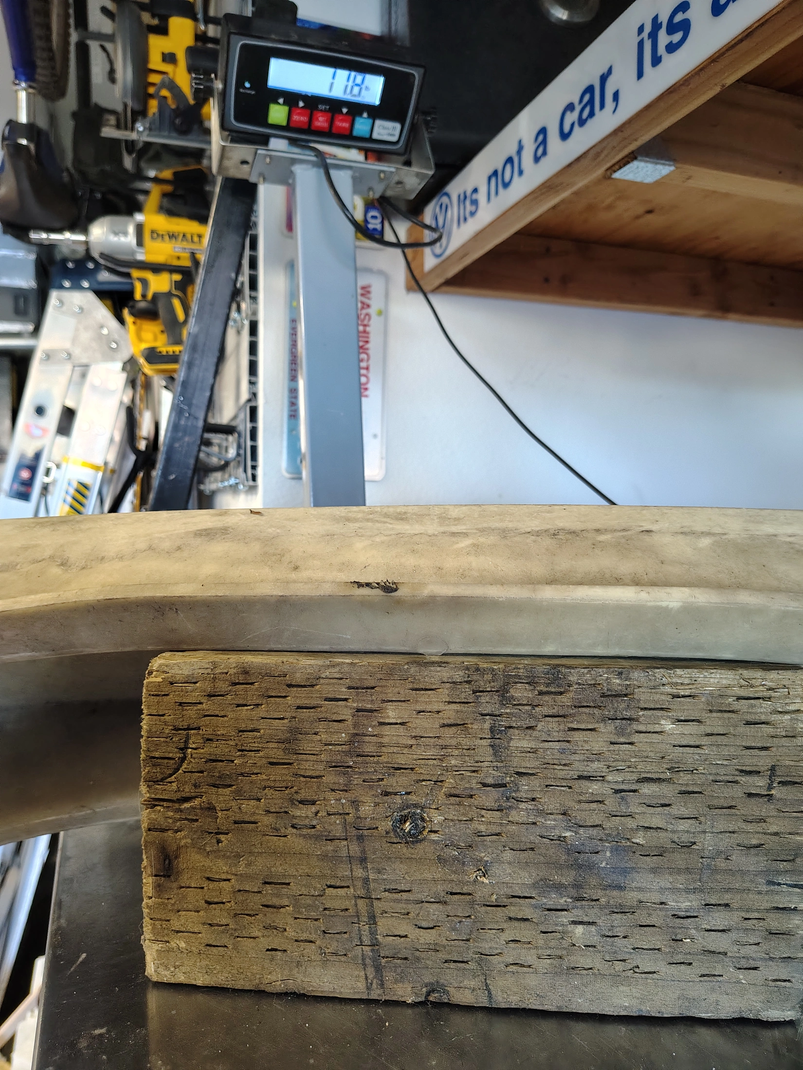

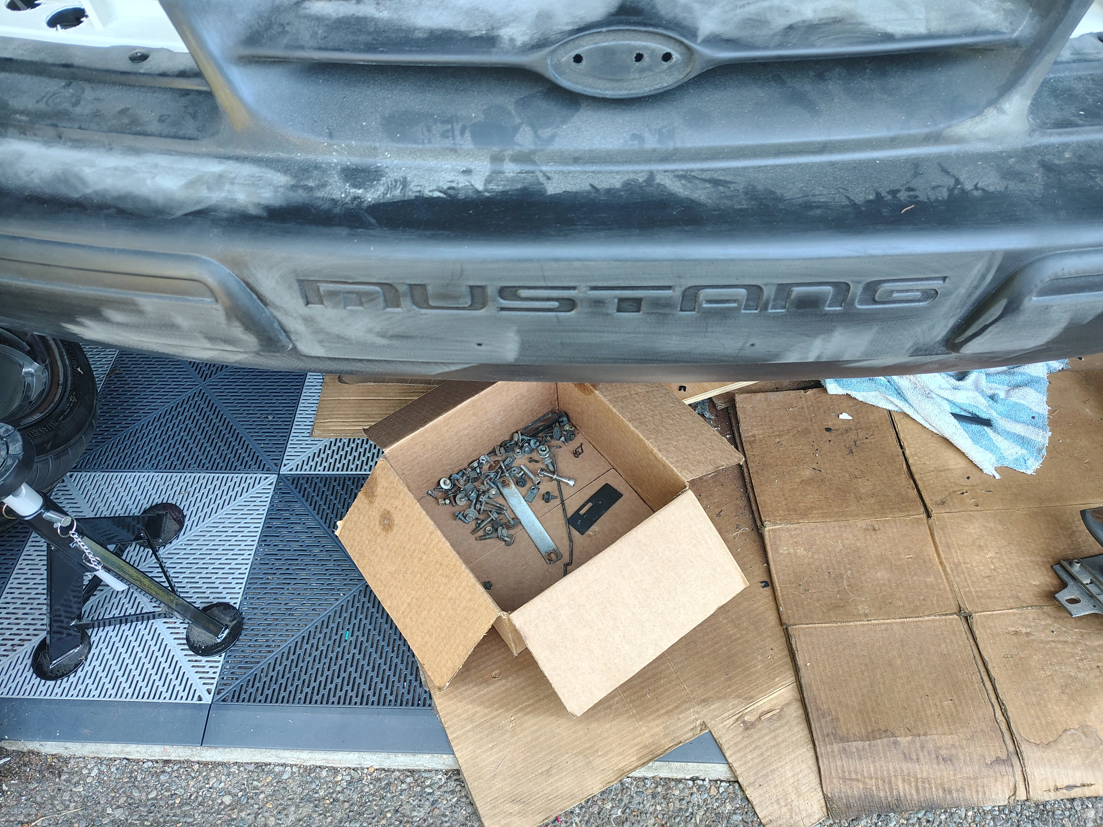

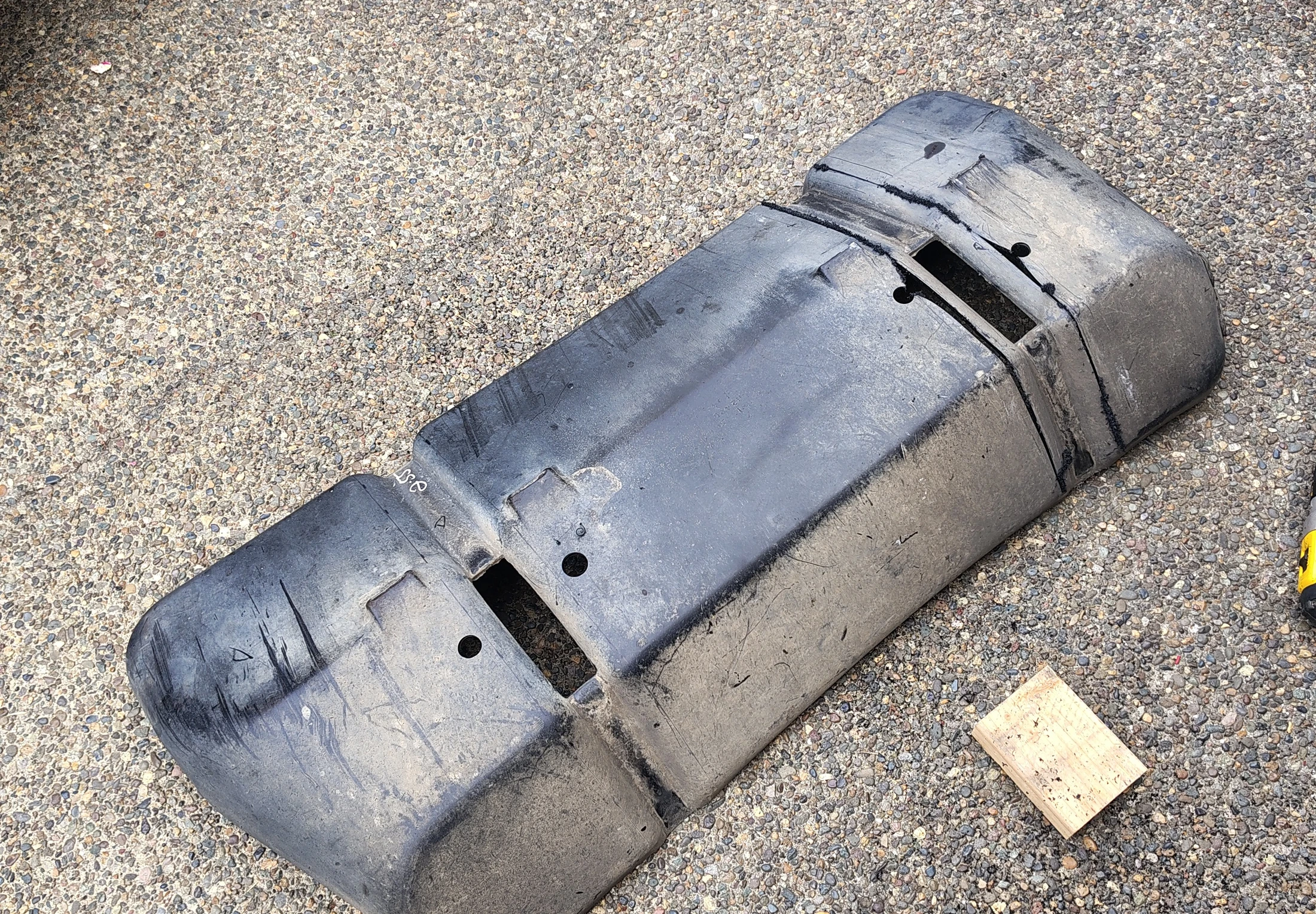

More weight savings on the front bumper . Personally debated the steeda bumper bar that weighs next to nothing 3.8 lbs .But the steeda unit seems sketchy .So I went the route of just replacing the front bumper brackets sure not a huge weight savings but still weight and feels a little safer than the Steeda part . And yes I zeroed my scale out for the woodblock
OEM Front fiberglass bumper 11.8lbs
OEM front bumper brackets 5.4lbs ea
Aftermarket front bumper brackets 1.4lb ea
Steeda bumper bar 3.8lbs

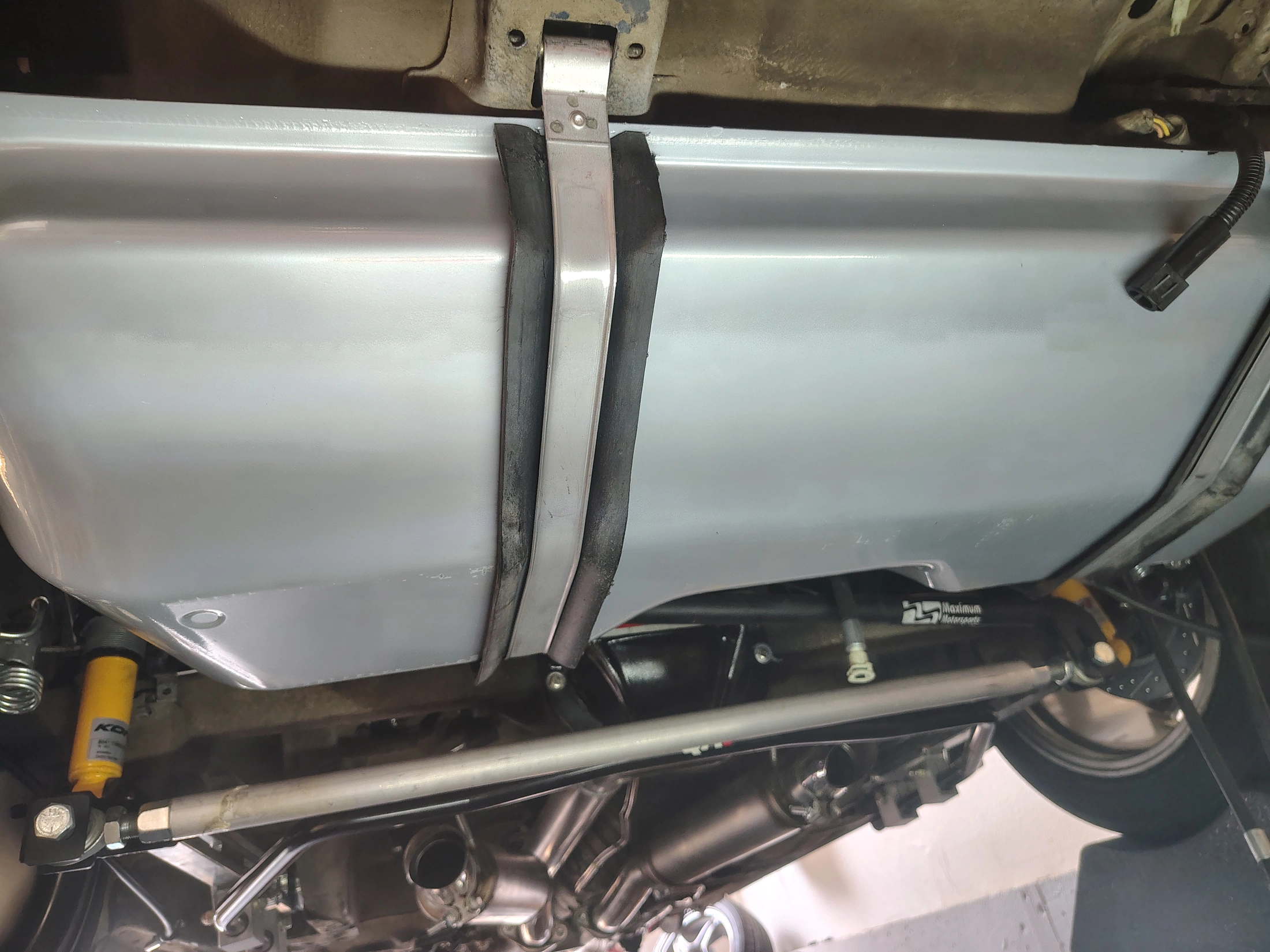

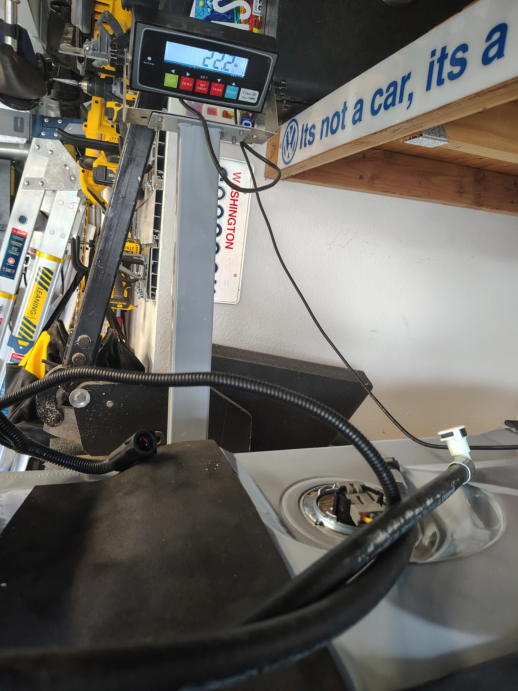

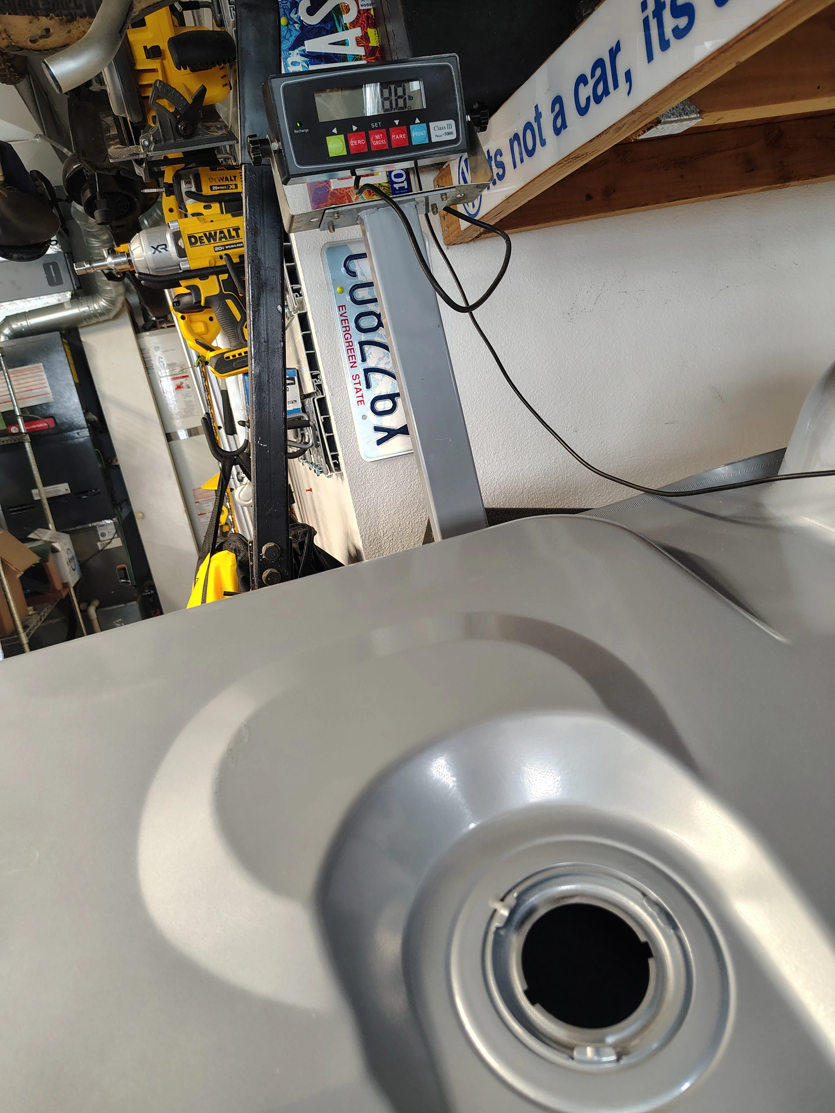

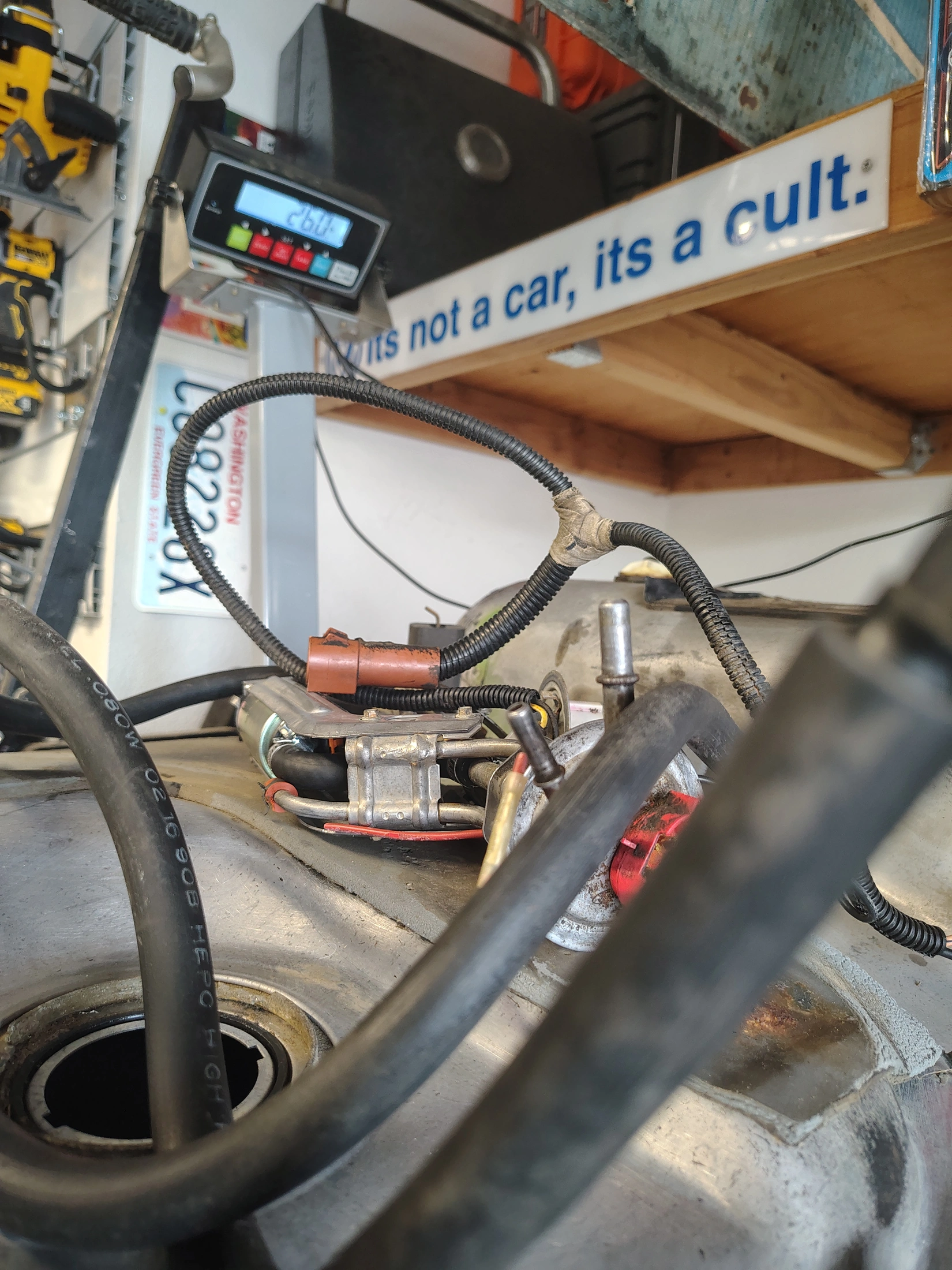

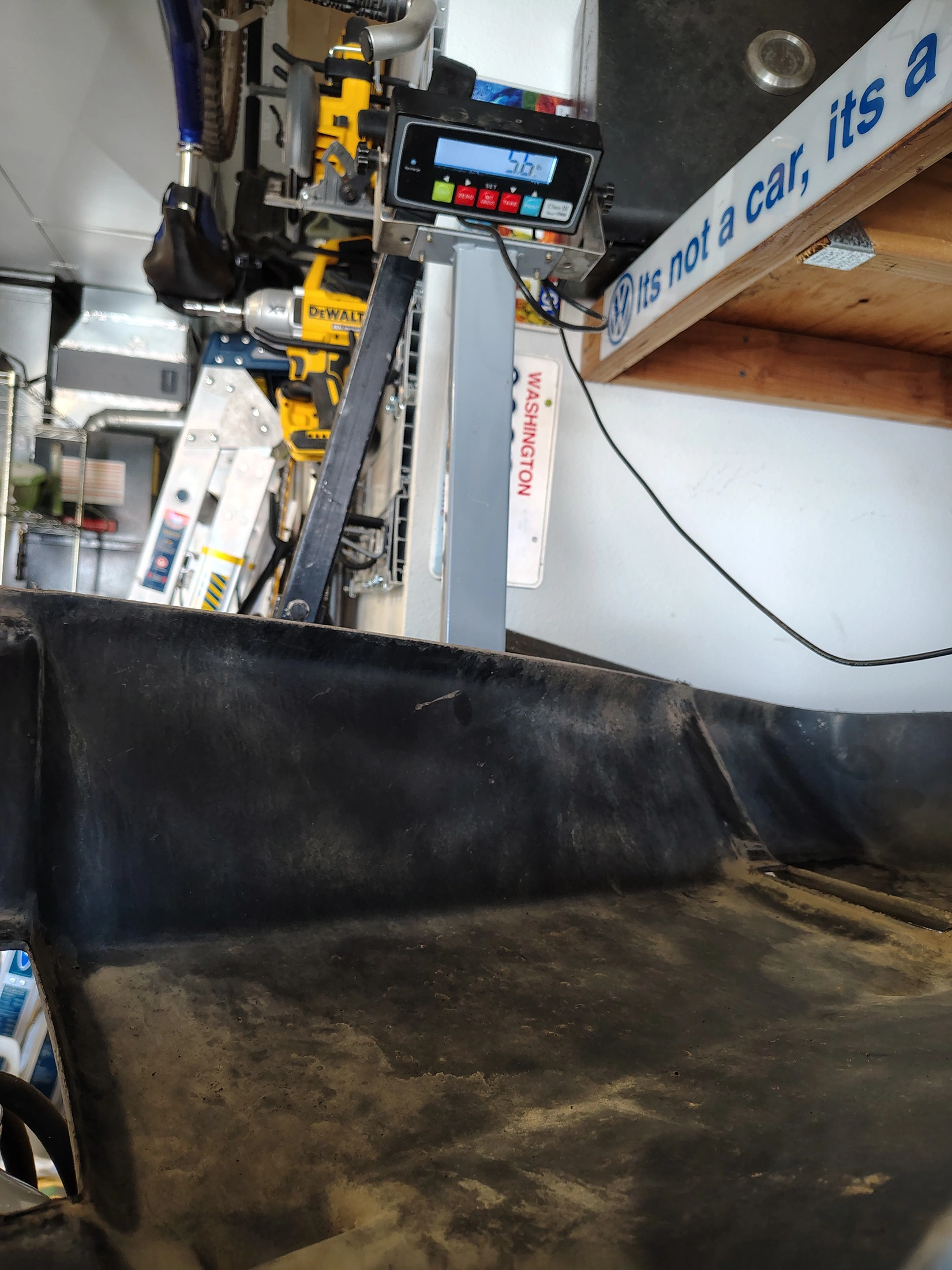

My replacement fuel tank is in ..But again I had to I must weigh the parts does a OEM tank weigh more than a aftermarket unit ? I put the OEM tank cleaned & empty but with all the accessories hoses pump thrown on top 26lbs then I put the aftermarket unit from summit fully trimmed out pump hoses 22.2 lbs almost 4lbs of weight savings .So some time you get unexpected weight savings ...
