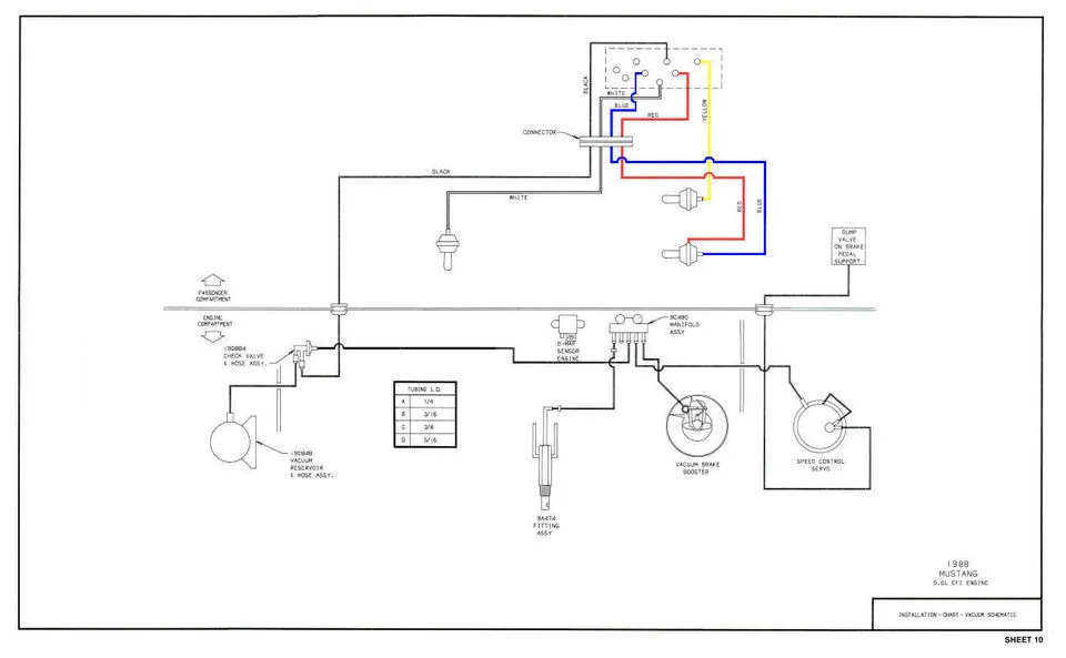

Look on the firewall. By the passenger hood hinge. There is a check valve mounted there. This is part of the main source of vacuum for the A/C system. Like HISSIN stated, if this is broken or damged, you end up with Defrost only.
See:
http://www.stangnet.com/mustang-forums/767567-c-check-valve-broke.html
You might also find this useful.
