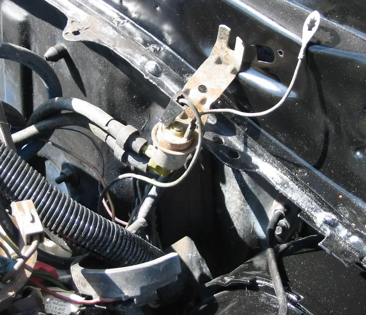

Weird Device On Firewall.

Ha! I haven't been under the hood of my project car ('78 Ghia, 2.3L, 4speed) for a while, but when I did, I found that I had a similar weird device on my firewall.
Also, my carb has only the electric choke heater, and not the water heater circuit. My '76 2.3L Holley 5200 is a significantly different carb from my '78 with different hardware hanging off of it and lots of additional vacuum lines (like the firewall device).
It was running when I started working on it years ago, but I have a long way to get back to that point.
