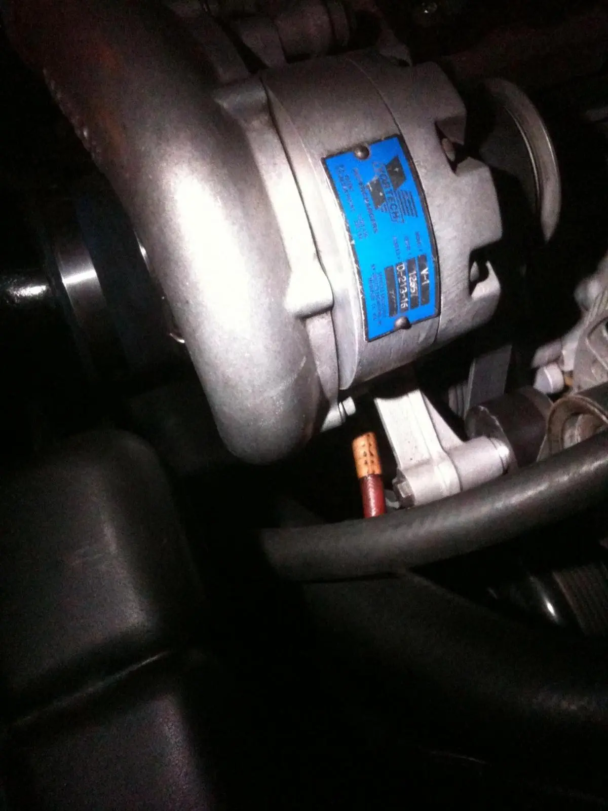

Weird noise in exhaust
Here's the pic

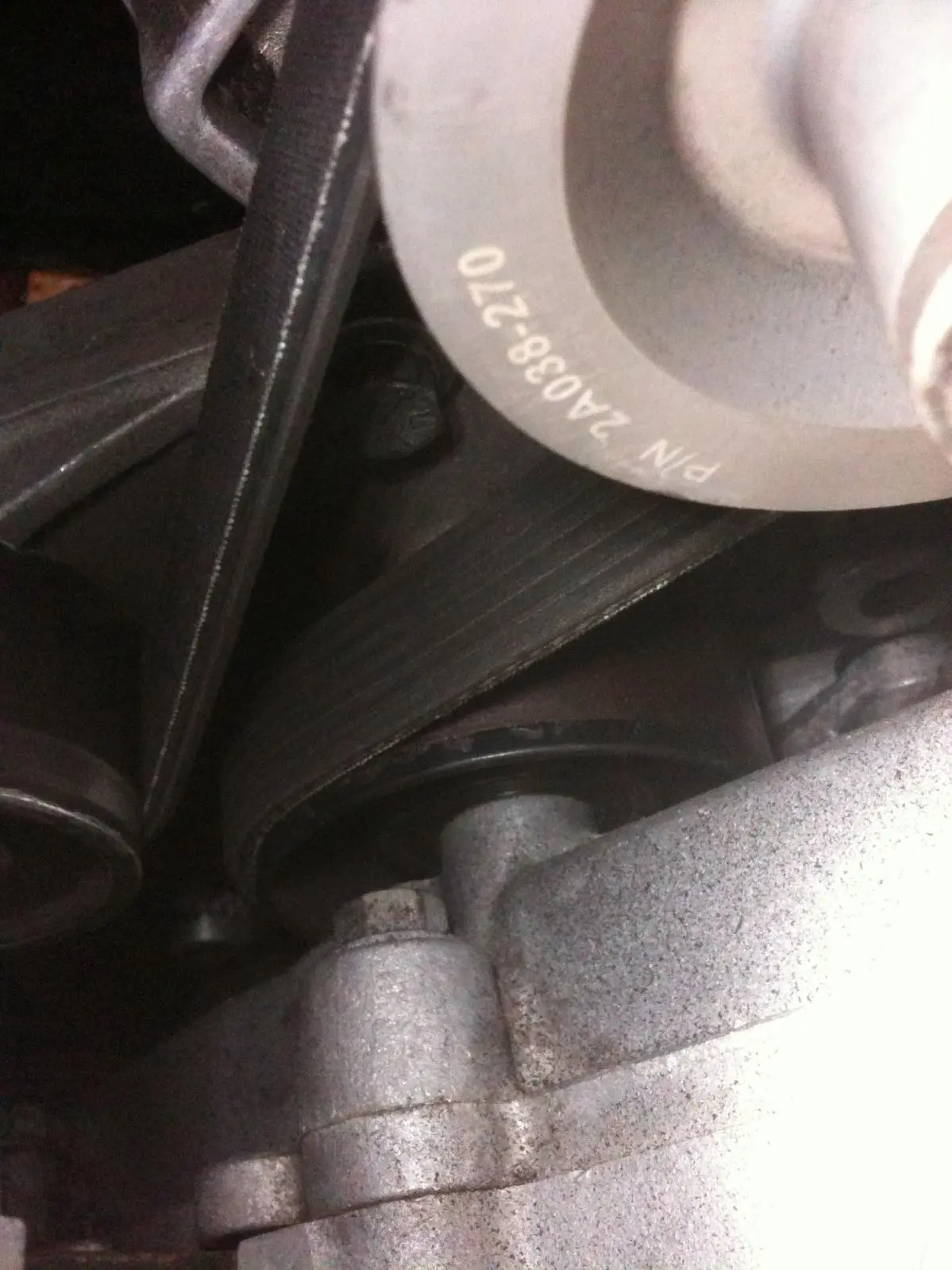

Why are you running an 8 rib pulley when the rest is 6 rib? You know that the belt is still slipping a ton right? To get the advantage of an 8 rib traction you must run all 8 rib pulleys.
Belt looks a little worn too, probably from slipping. If I were you, I would sell the 8 rib pulley and get a 3.33" or even bigger 6 rib pulley and a GOOD tune. I would shoot for 10 to 12 psi max. Having non-intercooled is causing your computer to pull a lot of time, the more boost you have, due to the IAT sensor reading hot air temps, hopefully located in the charger pipe. You will make about the same amount of power, with less worry.
My last .02
