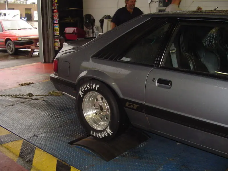

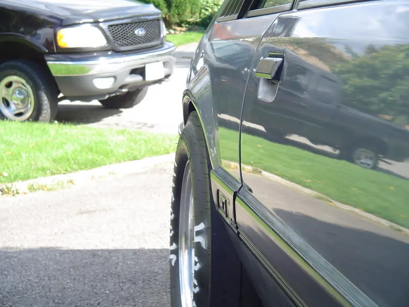

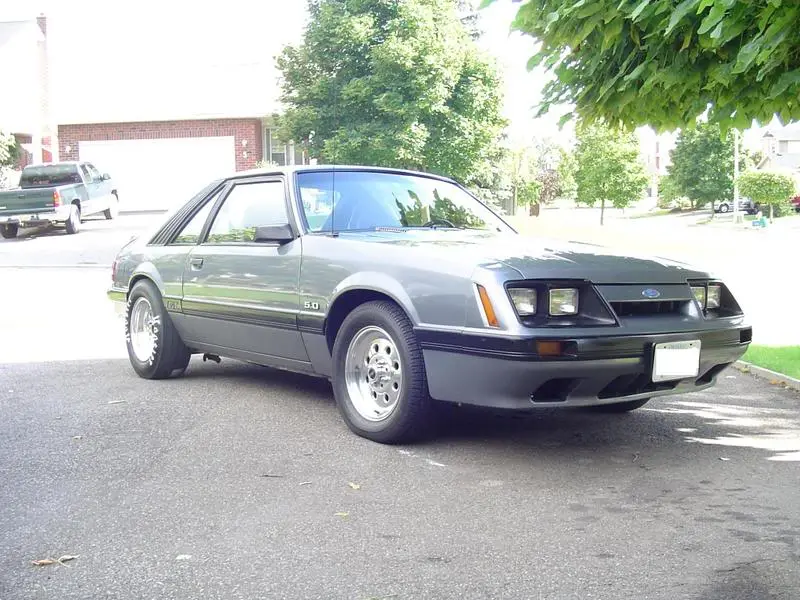

Most guys get the 5.5 inches of backspacing but I decided to opt for the 4.5. I like the lip that the rim has this way. With the 4.5 you cant run as big of a tire though because it will stick out. Here are mine with Hoosier QTP. The tires are 26inches tall, the side walls buldge out to 9.5 inches and the tread width is only 8 inches. That is why I can get them to tuck.

Those would rub like a bitch on my car. On launches my car squats hard and I even have to keep airbags out back because of it.
