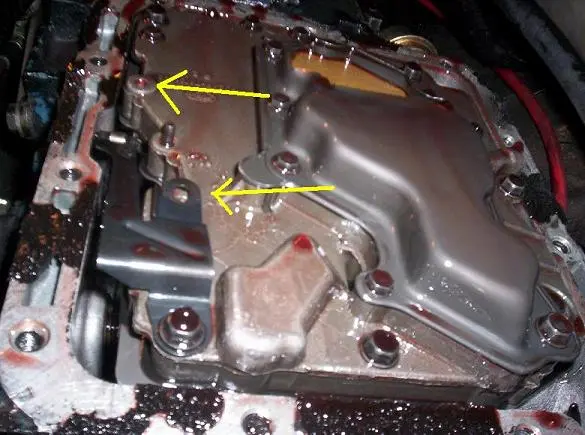

well look what i found in my tranny!

car wouldnt shift into 3rd gear so i decided to pull the pan to see if i could see anything out of the ordinary. well i found two bolts in the pan and two empty holes in the valve body. check out the picture and tell me what yall think. well both the bolt holes are stripped out. what can i do besides buy a new valve body? if i have to what brand should i get

that bottem arrow has a missing bolt. the top arrow is where the valvebody bolts together from the other side......
the thing marked "this thingy" is the shifter detent.....it's what controls your shifting, as in which gear is selected. Not hard to fix just make sure you have all the bolts back in before you try to run it again!

well the thing is...the bolt hole that holds the shift detent down is stripped out. im thinking i just have to get a new one...unless there is some way that i can tap it out. there are no thread in there are all
Time for a Helicoil insert. See your local auto parts for the insert kit which will have the inserts, drill bit, tap and helicoil installation tool.
i just dont think they have anything that small, but ill have to check it out tomorrow. i might have some in the tool box at work also. well that definetly gives me some hope in getting this thing running without buying a new one. do i really need to do the other one or just the shift detent? there is no way i can get the bolt through the top without taking it out. thanks jrichker

This should be able to be fixed by just drilling them and tapping them oversize,or helicoiling. I think at least one of the bolts that holds the detent spring in place also is a valvebody to case bolt, so at least one of the missings threads is in the case.
I would carefully drop the valvebody, and check the holes. You may be able to chase the existing holes and threads with a tap, and go deeper, and use a longer screw.
These are just smaller than 1/4 inch, and there should be helicoils available in that size. Or perhaps a slightly larger metric size could be tapped in there.
so...if these bolts that i put in didnt go through the thin metal plate on the top side of the valve body than it wont work? i tapped the holes but it felt like the tap was bottoming out on something....maybe it was that thin metal plate. i might end up taking the valve body out if i cant do it without springs and **** flying everywhere and than not being able to do a damn thing with it. i dont even know what bolts to take loose to get the valve body out of the tranny.
