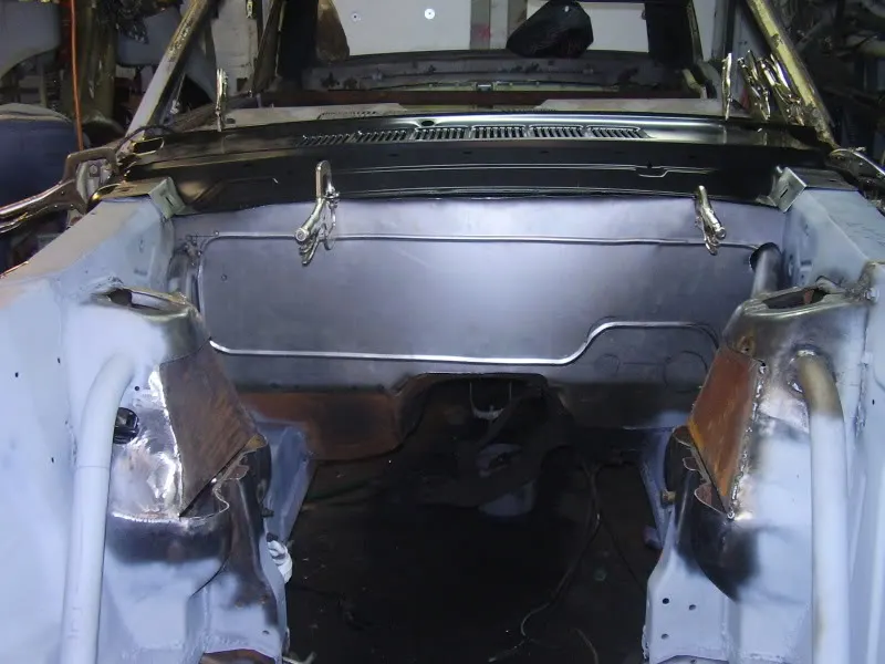

The front suspension is coming to and end im stillworking the bugs out and prettying things up the Cowl is ready to go on as soon as the work behind the dash is farther along,Flat firewall in place,rear sus. mocked up. It's been a challenge doing the brakes Willwood dyna Pro's up front did our own brackets and coil overs..Here is a few pics :) we are currenly working on the mounts for the Willwood Brake and clutch setup every day is a new challenge what fun )
Braided brake hoses ran yesterday still waiting on a few peices of hardware for the masters hard line to the masters today,hoping to set the engine and tranni in for fitmant this weekend that would be fun.the new rear crossmember is in I need to cut out the firstone + the rear spring boxes and get it ready for the second rear frame setup...woohoo
Vise grips for SHure!!Its getting our super nice engine/tranni out of the Daytona 408/TKO600+ we have a new Curri rear 9" housing with revalvable coilovers off a freinds ASA car we have a chance to get his RoadRace tranni from Roush but I would need to sell the TKO since thers only about 175 miles on its 6 one way and half a dozen the other.I have been doing the brake lines this week incorperating Brake gauges and a proportioning valve keeping it all behind the dash exept the valve by my seat.With the cowl off its cool becuase I can get to everything easily woohhooo!:Track:

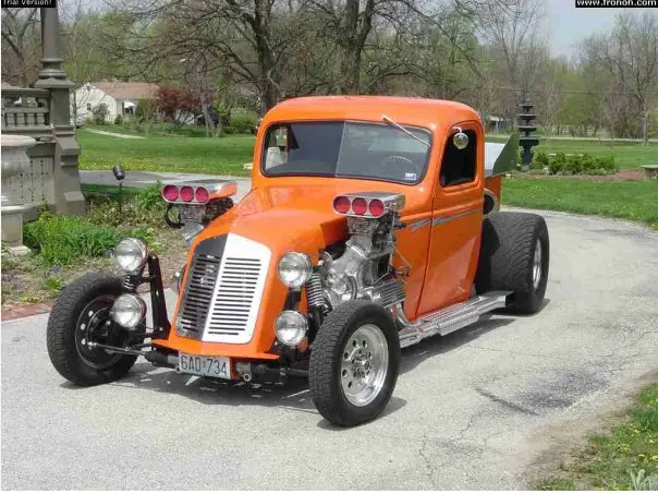

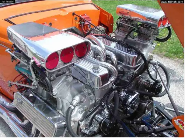

Thanks man, Im just an ol racer from the midwest that isnt Skeeerd to try something a little different I run it by my other racing Buddy at Hollers Hotrods and he gives me advise on whats sound he can really buildm from the ground up.Here is the truck he just finished for himself ....Enjoy :)
Yes those are twin BB Chevy 502's sweeeeet!
