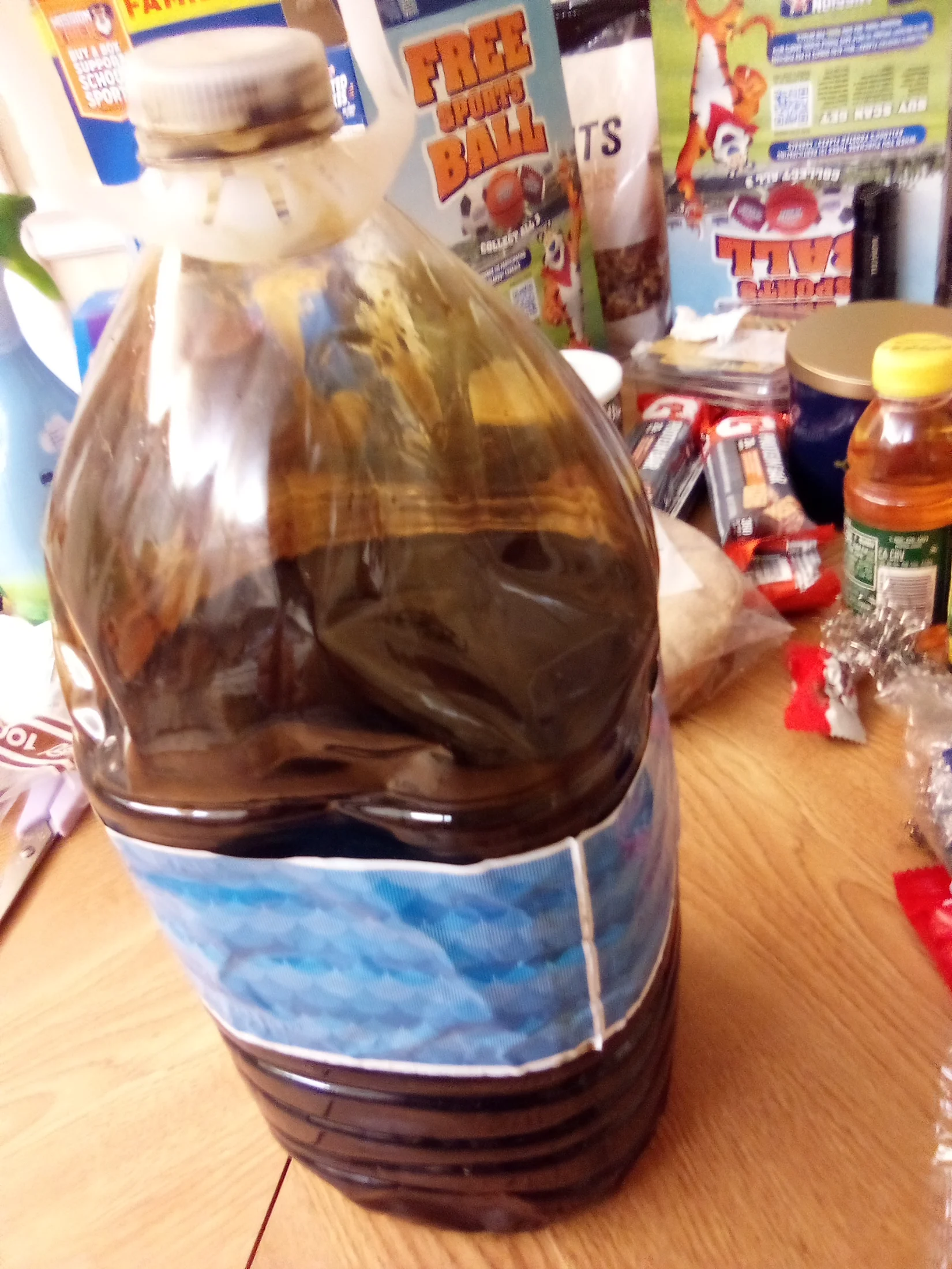

The oil looks pretty bad I think. It had thickened. It's not black but very dark brown.
When you drain oil that's been sitting for a while without first, heating it all the way to operating temperature then [that] it exactly what it looks like.
I see nothing so far in this thread that indicates that you have an oil consumption issue.
More testing is required.
