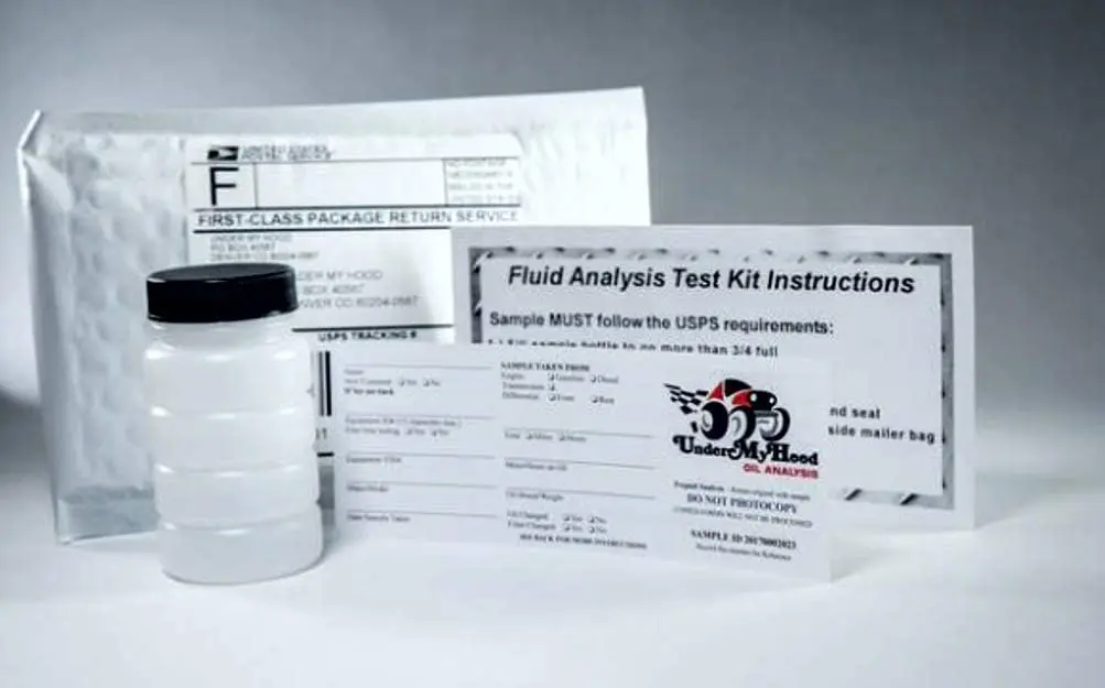

Here is what a basic Oil Analysis kit looks like:
You don't generally take sample from the oil pan drain.
You use a tube to go down the dipstick housing into the pan and pull oil that is [not] sitting on the bottom for analysis.
