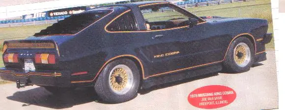

This dude has a 9" Versailles rear axle in his 1978 King Cobra. In the artical in the Magazine he quoted "bolt in" . he spiced the II parking brake cable to the Versilles cable with hardware store cable clamps. I supose his "bolt-in" has theoretical spring bind. Do you really think that in this instance the performance of the rear suspension would be compromised I personally think the flexibility built into a leaf spring suspension could tolerate the pearchs being a little off.

there is a 5/8 difference between the II and the versailles
you can bolt it in, but then a gain you can put a honda motor in a viper, but that does not make it right
And the cable clamps didn't tip you off to anything?
Do I detect a note of hostility?
You Think? ??
True, a little crude
I would probably do the same though, I only ever use the parking brake durring the safety inspection (on automatic cars). It is kinda scary how pencil thin a parking pin is though
Do I detect a note of hostility? Nope hostility is your bag, I like to try to help people.
You Think? ??[/QUOTE] All the time
Have you actually trial fit a Verailles rear axle in a II??
