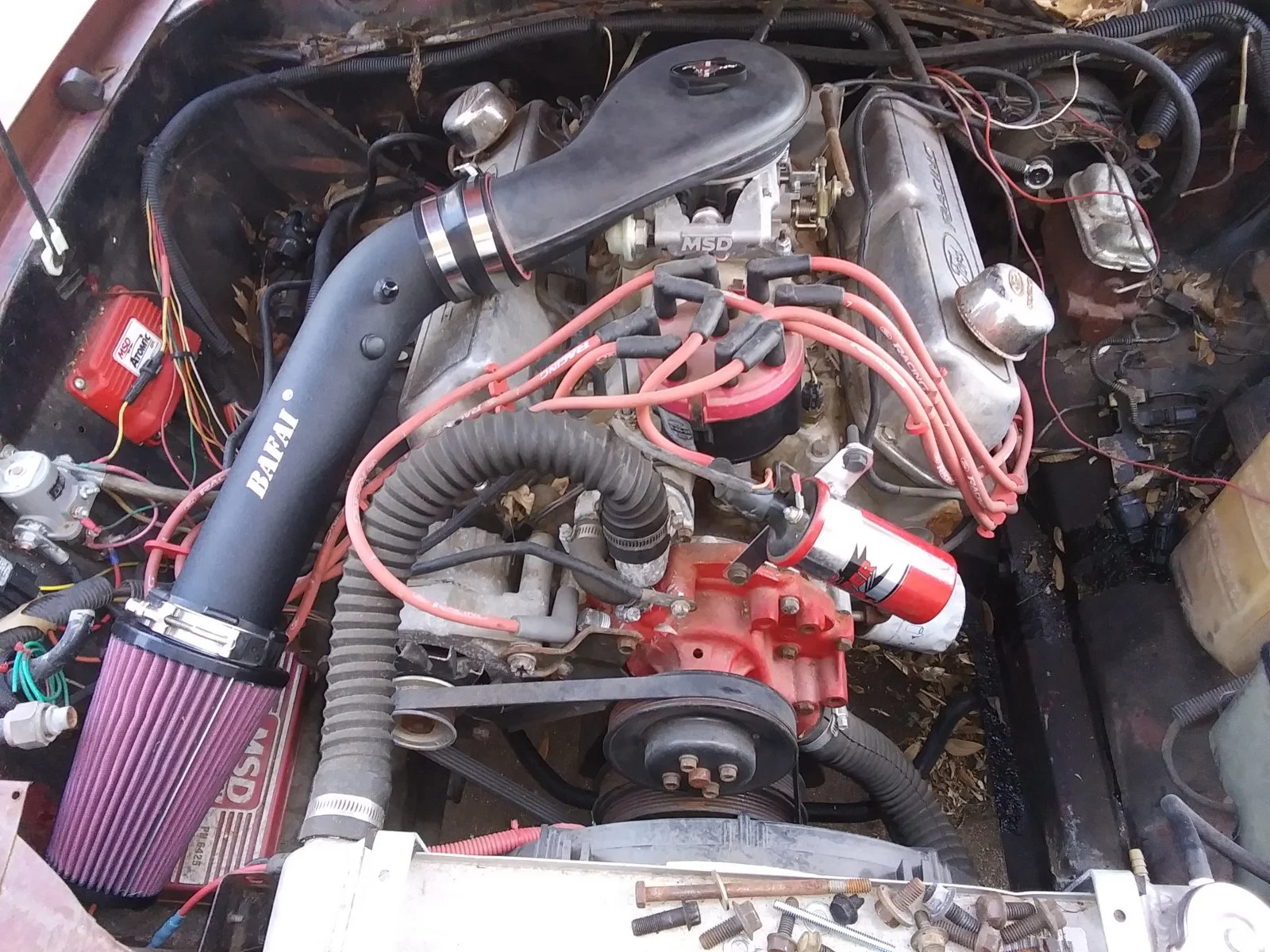

you not) that I picked up on Amazon for $31, and the air filter came with my buddy Kenneth's Procharger kit for his Mach1, but he already had a fenderwell-mounted cold air he connected to the supercharger instead and gave me the air filter that came with the kit.
) that wants to build one old-school, or do a restoration of a late 60s/early70s Ford and needs a good iron head like that (those C9s don't have the best runners, but they've got big-ish valves for a Ford head, and 58.3cc chambers that make for good compression before they've even been touched by a machinest or porter). If you sell them, prices on Ebay are all over the place right now, but range from $30 from someone who has no idea what he's sitting on, to $500 for a rebuilt pair (average used is about $150 a pair at the moment). You can use that money towards aluminum heads if you want to lose some weight on the front of the car and make engine cooling easier (and pick up more horsepower).
