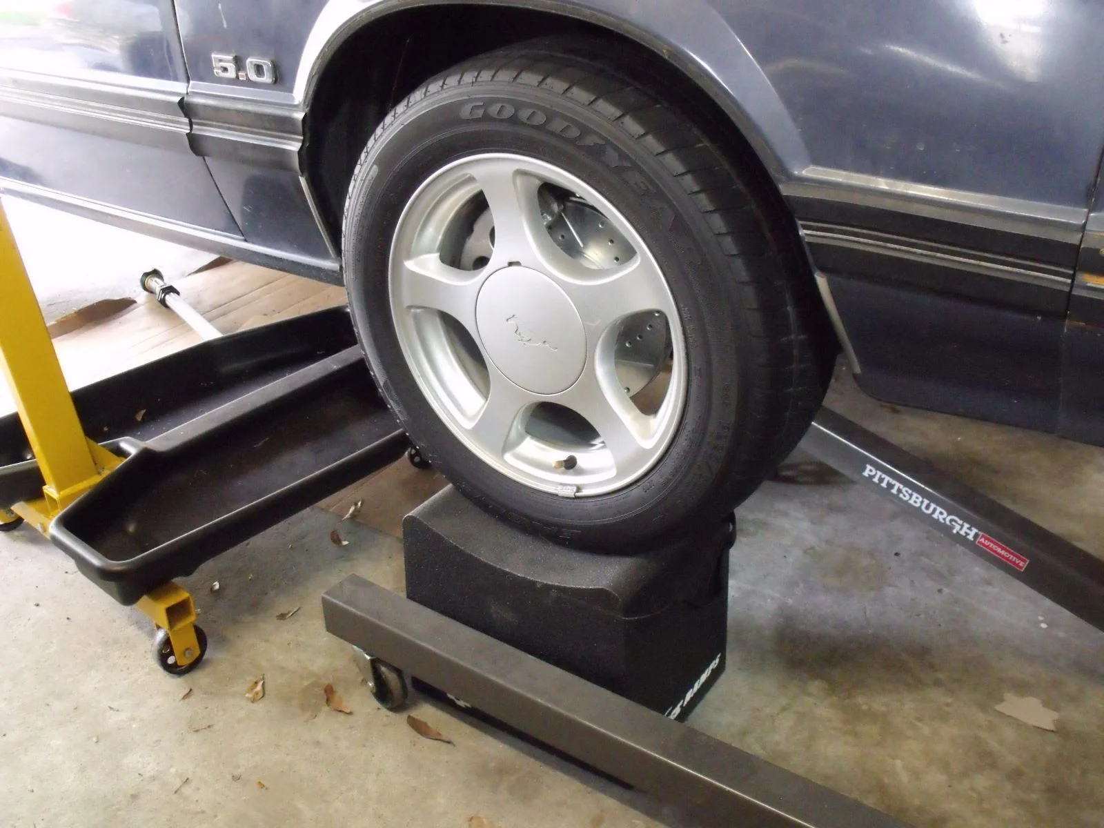

Why my 83 has not progressed forward... I was going to try to do it myself on my 12" Race Ramps... Too old, Too fat I guess.... Looking for a place to take mine to have it done....
my son has a '21 charger scat pack and that car is heavy. He ordered a nice set of race ramps I forgot who makes them but were between 300-500 bucks. They actually sent him 2 sets because one had a small nick but wasn't a big deal. I like using them :)
Reactions: limp
They work well and it seems safer to me than jack stands. Still wish I had a tall ceiling and a lift....
