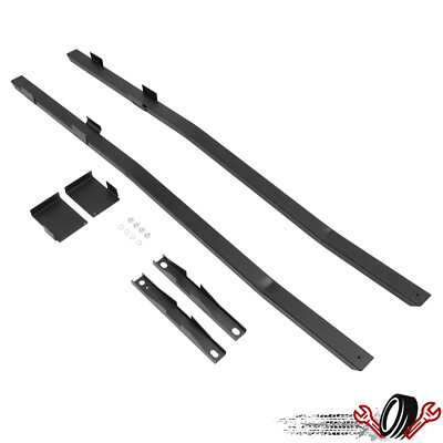

Wondering if they should be fine to use? My car is just a weekend mostly driving street car, no track and it gets driven normal more than I dawg my cars but I do have fun with them from time to time. Building a 331 stroker now for it and with my combo expecting somewhere around 330 to 360 whp.
The price at $85 is right vs the $140 I spent on the I believe Sve ones I put on the 94 back in around '21 '22 and they look the same lol..
I scanned that Ebay ad and didn't see anything.
Ok the Sve's say 1"x2" and I can't imagine they'll be thinner than 1" lol but I'm going to send the ebay seller a message.
Here's what one guy said on another forum:
"I’ve been using standard length weld-in $75 SVE subframe connectors for a decade or so. It’s just metal after all. The main thing I think it’s to get a set that ties into the seat brackets."
I meant the wall thickness. I'd imagine that the tubes themselves are probably identical - or close to it - but they may not help as much if they're too thin. OTOH, they'll probably be fine for your application regardless, and I'd guess that they'd be better than nothing at all.
gotcha gotcha and I'll send him another message. I wonder how thick the walls of the Sve ones are then?
Yeah, there is no mention of the construction of those thing whatsoever. For all we know, it's 3D printed ABS. lol

I will definitely see if he replies with anything about them and if not I might just air on the side of caution and spend the $140 lol. But I don't want to if they are pretty much the same thing. I defintely want to find that out though.....

The ad does say that they're made of steel, but doesn't list wall thickness or tube dimensions. I think - if it were me - I'd shoot that shot. I think they're probably fine for a daily type build. If all else fails, you can compare them to the older SVE set you have (if you still have them that is....).

Maximum Motorsports - Made of 1.5" x 2" x 0.083" wall thickness rectangular tubing
SVE (LMR) - 1"x 2" Steel Construction, noodled around and found the wall thickness is 0.0625"
Steeda - 1.5" x 2.0" x 0.083"
Kenny Brown - 1.5" x 2.0" x 0.083" mild steel
UPR - 1.25" x 2.0" x 0.083"
Another option is Global West (I have them on both cars) which are made from 1.625" x 0.125" wall DOM tubing. Round tube resists torsional forces better than square or rectangular tube and they install to the side of the factory subframes which increases ground clearance. They offer seat braces (I have them) as well as rocker rails (should be used with a vert) and also offer competition series which is like the Kenny Brown extreme matrix setup.
Anyhow, I would pass on the SVE's as the thinner the wall thickness the less torsional force they can resist compared to a thicker wall unit. Any of the other ones are going to do you a good job.
true or worst case I send them back if they look frail lol.
Yeah they are on my 94 Cobra and can compare; would just have to get under the car but wouldn't be able to see inside the tubes heheheee
even for what I'll be doing with the car lol as in passing on the Sve?
the seller pays return shipping on them also , just checked.
I'd think if they were not so good pieces they might not want to foot the bill but you never know. I might take a chance to at least see what the quality is like.
