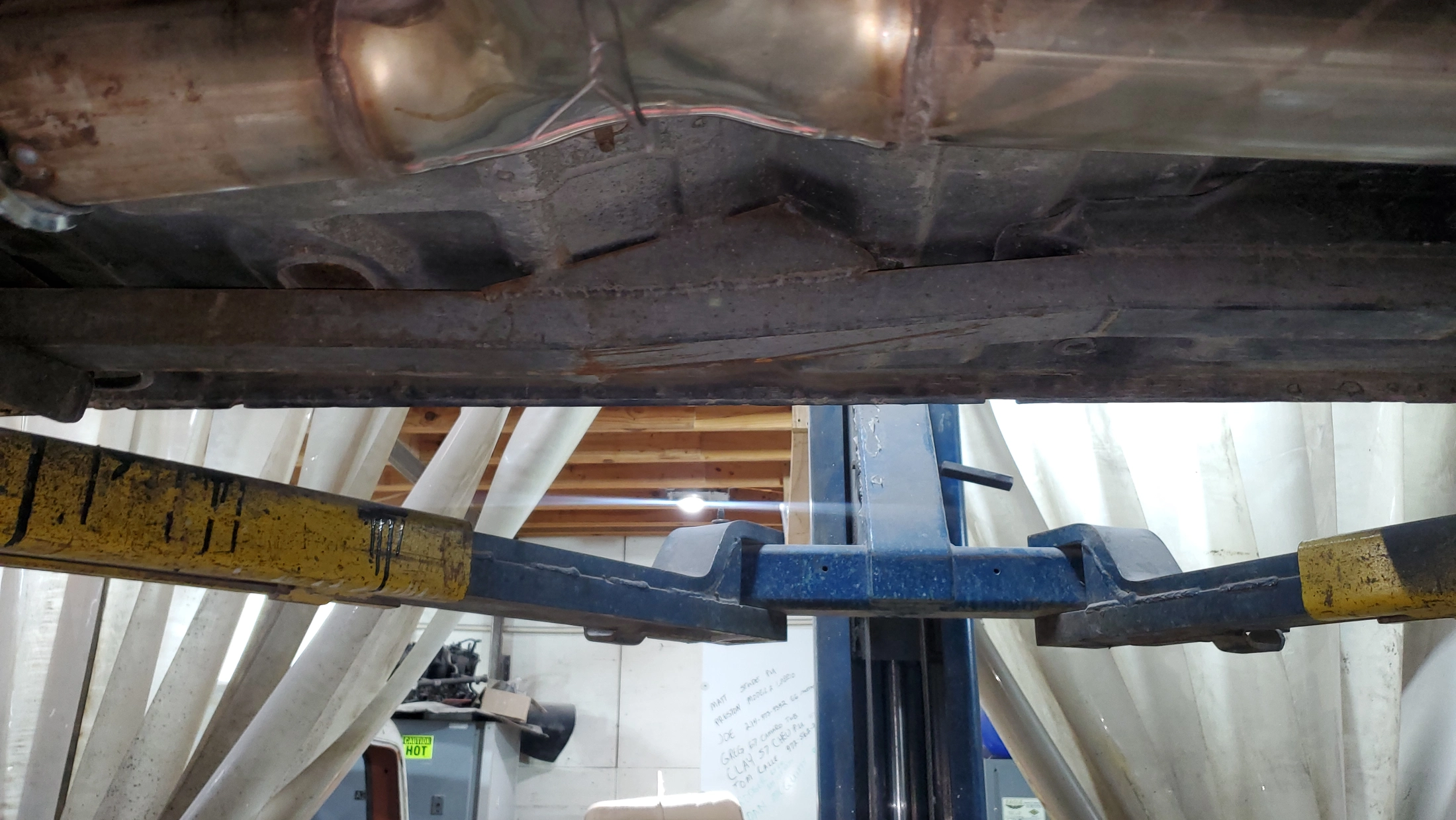

AeroCoupe said:
If you want to spend the same time, effort, and money to weld them in then go for it. I would rather spend the $40 or so more dollars and know I have the better units.
Is it necessary to have the subframes fastened at the seat brackets underneath? I noticed today when swapping my rear lower arms that one side wasn't fastened, I'll check the other side tomorrow. Not sure rather the nuts were missing when the muffler guy welded them up or what.
Admin Dude
Jan 4, 1985
43,565
21,736
Box behind Walmart
Feb 14, 2025
#45
  • Feb 14, 2025
  • #45
It does help to position them. Snug them down, beat/bang/bend if/where required, weld.
You could also clamp it into place, I've seen magnets used, jacks, etc..

from6to8 said:
They are already installed and welded by a shop. Necessary to fasten them now?
If they are seat bolts, then yeah, bolt them down. Can you move that end of the seat up and down?

Whoever installed mine decided to go the extra mile under the seat area.
Yeah it looks like that should suffice since it's welded up in that area even though I don't see the seat brackets themselves. As for mine upon further inspection the seat bolts just fasten through the floor pan with no nuts on them and the brackets for the subframes just kind of sits over those so everything's welded up nice. As some have said it's no reason to put nuts on them as the seats don't have them anyway. I guess it won't hurt too but yesterday I was tackling swapping out rear lower control arms and all of that so I'm not worried about it

AeroCoupe said:
Seat brackets start at about 1:00 and you can see they install nuts on the bolts to pull the seat brackets up to the floor pan. Ties everything together and makes the seats move less.
View: https://youtu.be/TgSju5PQ2pE?si=Rg08gYd8HkxEcZDM
Yeah I did when I watched that video the other day & at some point I'll throw some on. I got to check the thread pitch see if I got some nuts lying around
without going back and re reading my own thread let me try and refresh. So the brackets just get fastened via nuts and there's no requirement of the brackets themselves to be welded? LMR did send me the brackets for the 94 and I have the subframes set to go on the 95 at some point befor the EOY.
If the brackets just bolt up then I'll add them myself and I'm sure they'll have to be secured with nuts. When I get the 95 done I'll have him throw those on while he's under there.
No i believe the brackets get welded to the subframes, the bolts are just for the seats to be mounted to.
