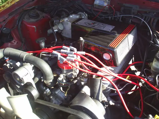

i got me a 94 cobra lower, 96 explorer upper...along with a bit more high end, i lost some low end....and its ported for 70mm and the runners are nice and smooth
