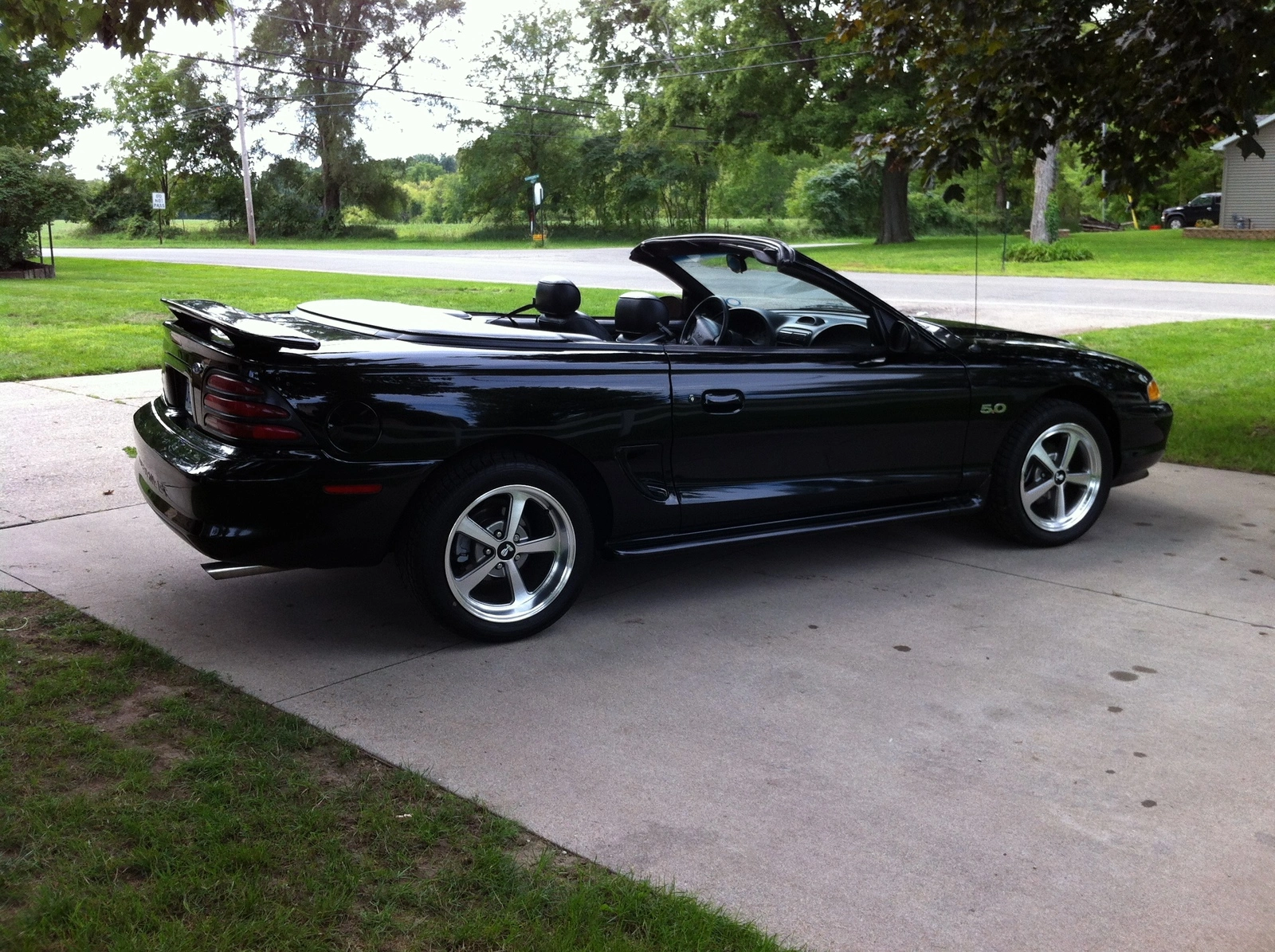

Thanks guys!! Yes it is a convertible. Only 104k miles and changed hands a small number of times. I'm researching exhaust/muffler choices right now its way too quiet stock lol

That's a really nice looking car.
Sure does need lowering though, but that's about it.
Keep the weight in the front until you get the SFCs and lowering springs.
After those are in, you shouldn't notice it gone.
