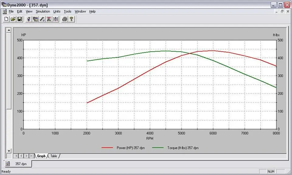

I'd guess it would start a little lower than 2K. My cam is a little bigger (224I/236E and .506 for both) but is rated 1500-6500.
It is a custom grind recommended by my short-block builder (DSS Racing) for my intake/head/carb combo. It is very close to many off-the-shelf parts like the 278H or the Perf-RPM. In fact it was the RPM cam which I asked for and they talked me out of it based upon their experience and my desires for a hot cruiser instead of a strip car, this is basically a torqe build that will lose peak tq/hp figures in favor of a gain in average tq/hp. A nice flat torque curve at that considering what desktop dyno shows.
For the record...I know that chart indicates higher output than reality, I expect peak numbers to be very close to 400 on both lines, not the ~440 it shows.
