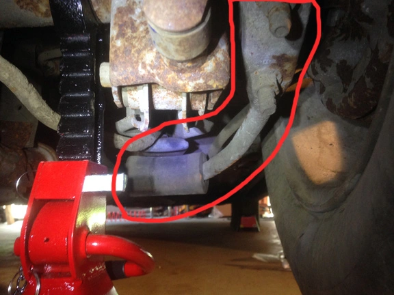

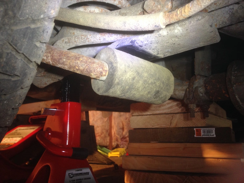

I've searched this forum and many google keywords trying to find out was these suspension parts are, but can't find pictures or descriptions of it on any other cars.
These were on my '82 GT when I bought it. Are they factory? Anyone know what they are called? Basically, there is a pad on the bottom of the lower control arm and an arm with a rubber bumper clamped to the axle tubes? Was this a solution for wheel hop?
I plan on updating the suspension with coilovers, new lcas (read that i should keep the stock uppers with rubber bushings for proper give). Can i just throw away whatever the parts are in these photos? Or is it beneficial to keep them?
Thanks!

You can retrofit quads, you'll just need to upgrade to an 8.8 that has the mounts on the axle tube, and add the mounts to the body.
Also, I wouldn't throw any Fox parts away. Toss em on Ebay. All these parts have some value these days unless really trashed.
The technical term was "anti-tramp rods", as wheelhop was often known by engineers as "axle tramp". They're there to control the oscillations that lead to wheelhop due to driveline shocking. They're basically the factory version of slapper bars everybody ran on their '72 Novas.
