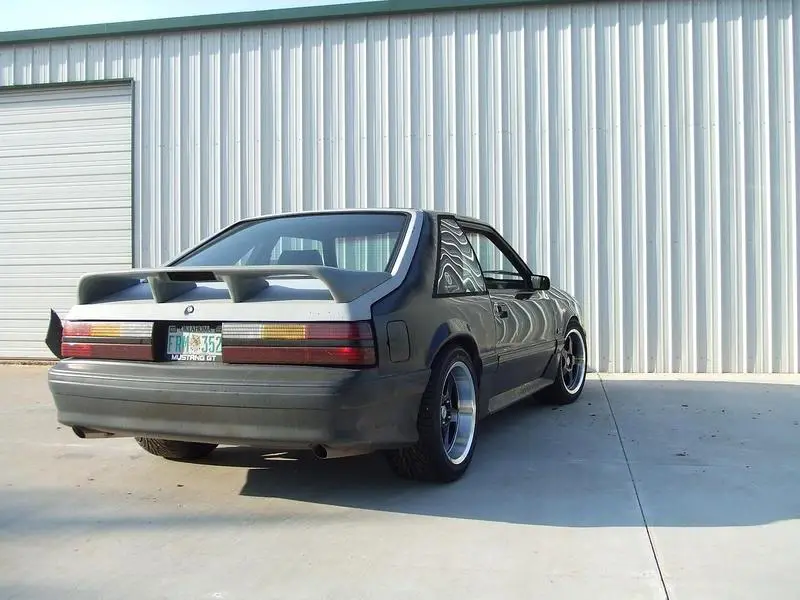

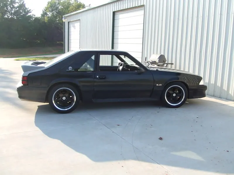

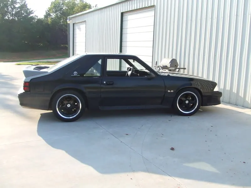

Hack Job had Steeda Sport Springs all the way around. Stock rubber isos in the front. Hardened plastic rubber isos in the back supplied by HPM's Mega-Bite Jr's. Car was lowwww.

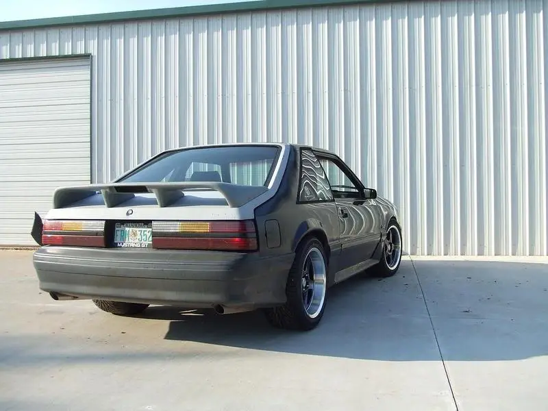

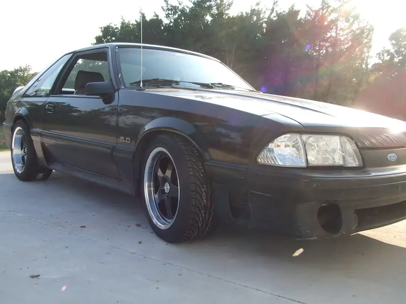

17x10's with 275/40/17's rear and 17x9 with 245/45/17's up front, maxspeed springs, no iso's up front, energy suspension iso's out back. new tokico HP's (blues) all around, MAC c/c plates and UPR uppers and lowers. like other's have said, rides pretty decent.
sorry no new pics, it's still torn down from my paint project, but you get the idea...

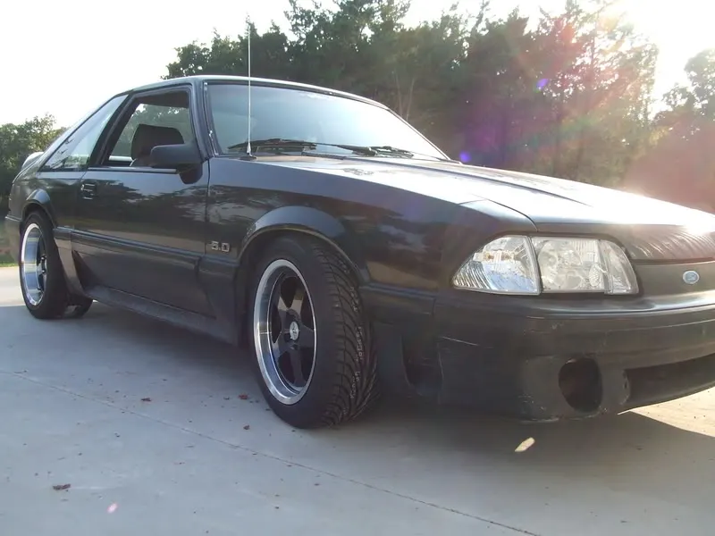

I'm running Eibach Pro Kit springs with isolaters, but i had to cut off 3/4 coil off the rear springs because i didn't like the rake that they give. Now it sits nice and level.
Great guys thanks!
I am really not worried about the rear as of yet. I'll save those for later. The front sits WAY up in the air. On the driver's front I can fit my hand sideways in between the tire and the fender. On the passenger side I can "fit all four fingers" hehe.
The car doesn't feel right over 50 mph and I have a feeling this may be the problem.
