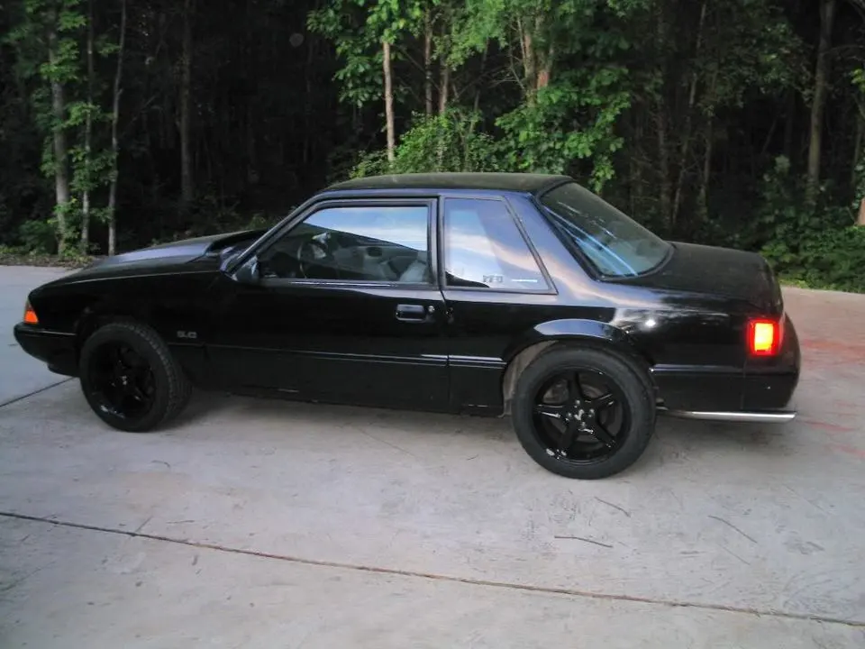

I am running 17 x 9's all the way around. I've noticed many others with that size- I'm assuming they're 17 x 9 anyway. What springs and such will let me recreate the following without major rubbing issues lowered or not doesn't matter... you can't tell from the pic but my notch has brand new shocks in the rear and still sags in the back.
Here is the patient awaiting springs
Here is what it should look like

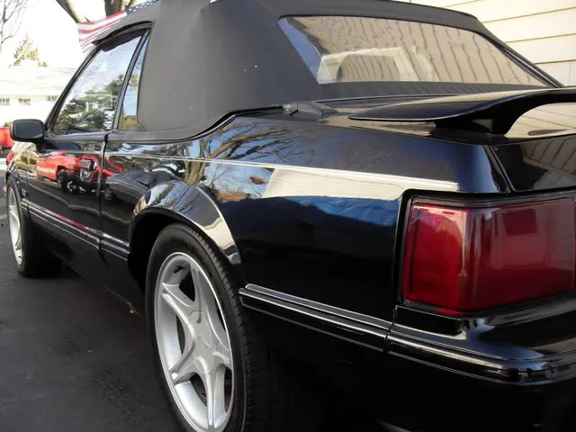

maxspeed springs and bbk insulators.. handles REALLY well and ride quality isnt bad at all.. stance is good :drool:
kinda bad pic.. the pics are with the 16's though, i now run R's like yourself and they fill it up and create the same stance as the others

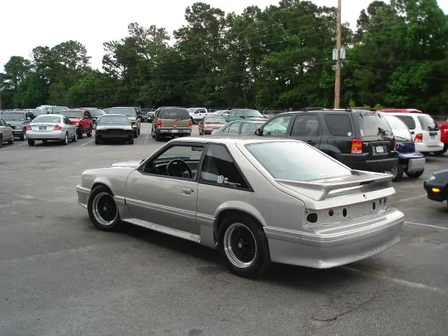

The pics of what you wanted are now gone....but here's my stance with HR Race springs....MM adjustable LCA's....and FR a-arms up front. Not sure what else what might have affected my ride height. But tell me and I'll list it.
Oh...the rear has 1/4" spacers.....I removed them from the front and get a little rub on full turn. Mine are 17x9 with 245/45 all the way around. Front probably wouldn't rub if I had slightly skinnier tires on em. :shrug:

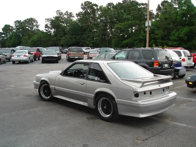

Eibach Sporlines. No isloaters in the front. stock isloaters in the rear. stock shocks and sturts and controling arms. 1/4 spacers in the front.
