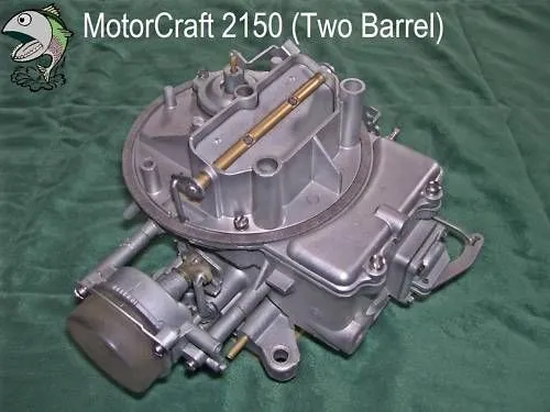

The 1973 302 should have a 2150, not a 2100. The main feature of the 2150 was a pull-off on the rear half of the air cleaner flange.
107649d1281928919-my-motorcraft-2150-carburetor-choke-pulldown-diaphragm-missing-chokeissue4.webp
