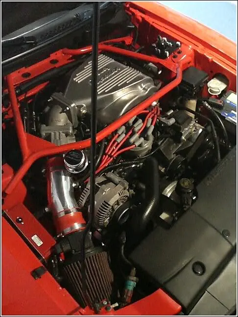

Pro3i 4 bolt plates, $149 on www.partshopper.com
