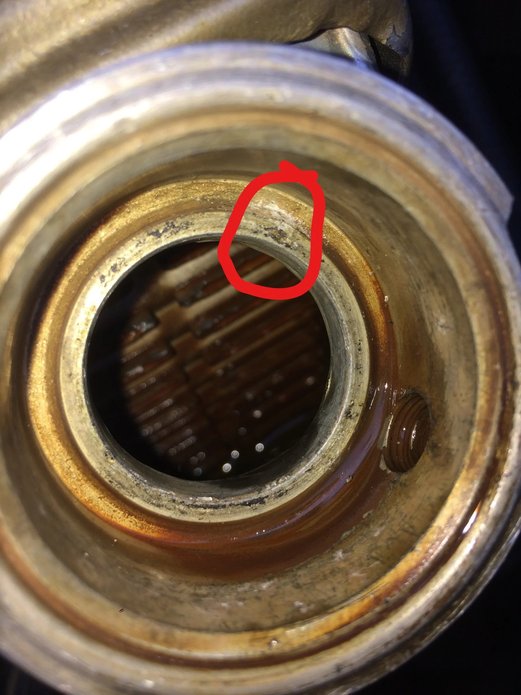

so ... i am still having issues. it took a little longer for it to happen this time but i havent really drove the car in over a week because i needed to conserve gas.
so far i have done these things
- pressure tested coolant system up to 20lbs , system held pressure
- pressure tested radiator cap, cap held pressure right up to 16 lbs , which the cap is rated for
- replaced the line going from the rad to the overflow tank and secured all the connections.
- tightened up the thermostat inlet after the gasket set
- checked the mating surface that the radiator cap seals too, there a was a little blemish that almost looks like a very small hole, and some crusty dried coolant. but if this was an issue wouldn't the coolant pressure test have failed?

I checked this out and noticed something... but it passed the pressure test so im confused. ive included a picture of the spot where it almost looks like there is a pinhole sized hole and some coolant dried up and i scraped it away (the white stuff was coolant)
