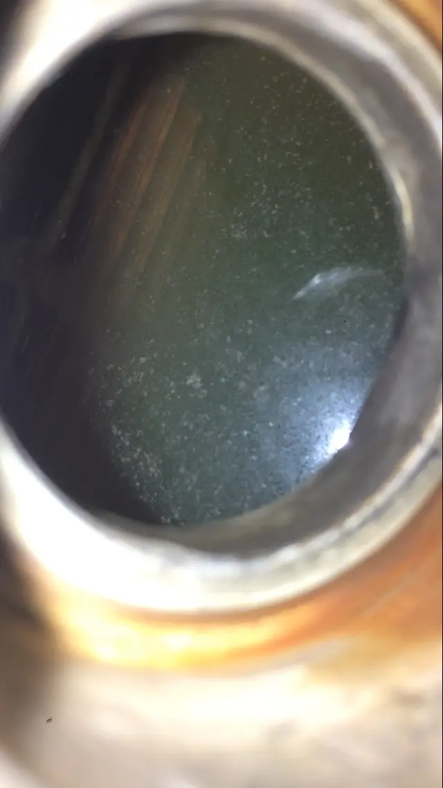

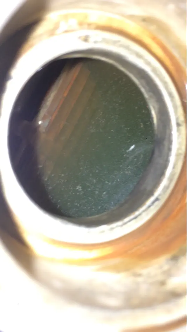

Yeah it definitely takes extra cranks to start, once it does it seems to miss and then levels out and runs fine.. I really hope it's not the head gasket. I have also noticed what appears to be small amounts of gunk in the coolant but the oil is still clean. ill attatch a picture of the stuff floating on the top of the coolant

Lourdalfe said:
I would say to warm up the engine be careful pull the cap and see if there is a constant stream of bubbles or a strong smell of exhaust gases and does it miss when you first start it those are the easiest ways to tell if you have a blown head gasket
I replaced the cap to the one with a release valve. I took it out and got on it hard after it warmed up and coolant doesn't spray out but after a short drive the coolant level went down slightly. I've eliminated every possibility besides a head gasket...
What can I do to determine if it has a bad head gasket? A leak down test? How do I do that

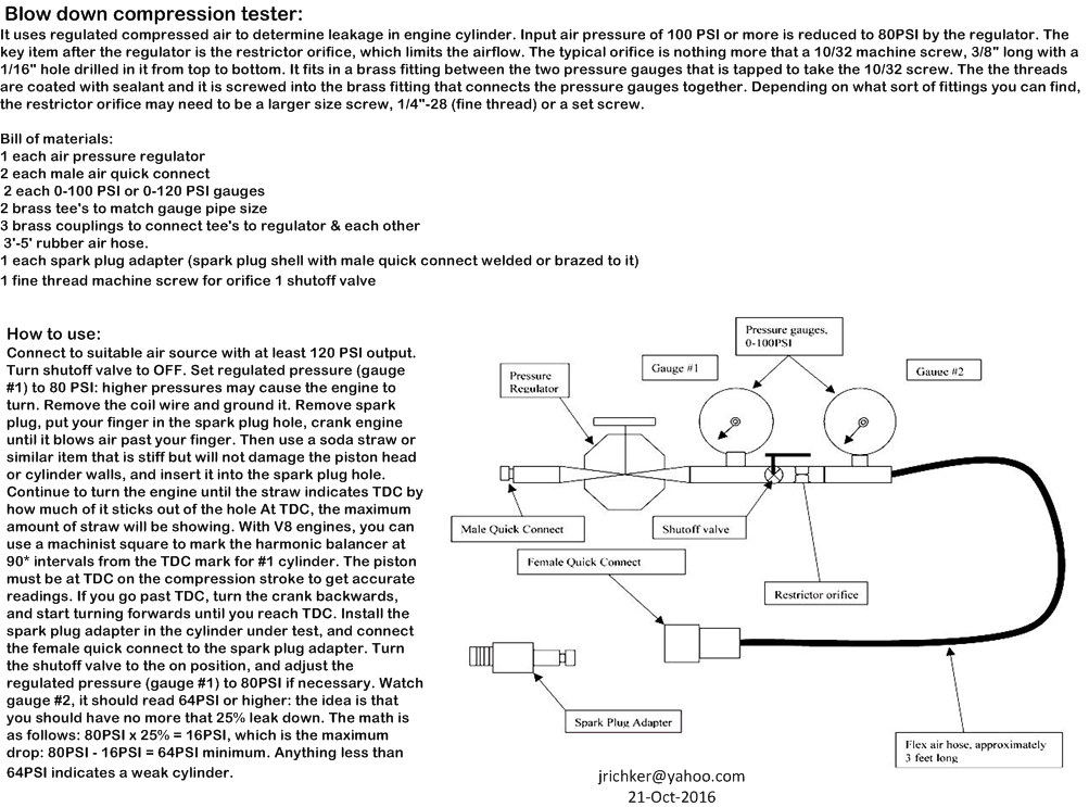

Click on the picture to enlarge...
My mechanic said he would do the test so I dropped it off there. Right now my roommate is using the garage or I would have tried it myself. I'll keep you guys posted. I also told him about the miss on startup which he thought was weird because he originally diagnosed that as a bad fuel pump but we replaced that and now it's doing it again
