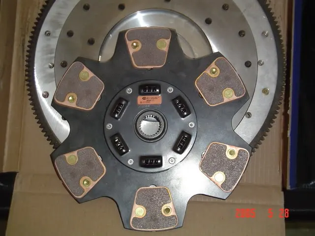

Best two high powered clutches ive owned.
Mcleod dual friction (good around 550rwhp)..After than the center force DFX setup(btw-it needs ZERO break in drop in and go hit the track)...Its held 621+rwhp and 550rwtq without batting a eye.
Plus its as easy to drive as a KC clutch :)

white99gt - I take your word over some others, because you seem very unbias:)
How was the clutch pedal of that particular McLeod Dual Friction clutch, and the on/offness compared to the Centerforce you used?
I have no problem driving a Centerforce in daily driver. Even, every now and then the King Cobra would get annoying in stop and go traffic and I am not a small guy.
the mcleod felt like a heavier King cobra.

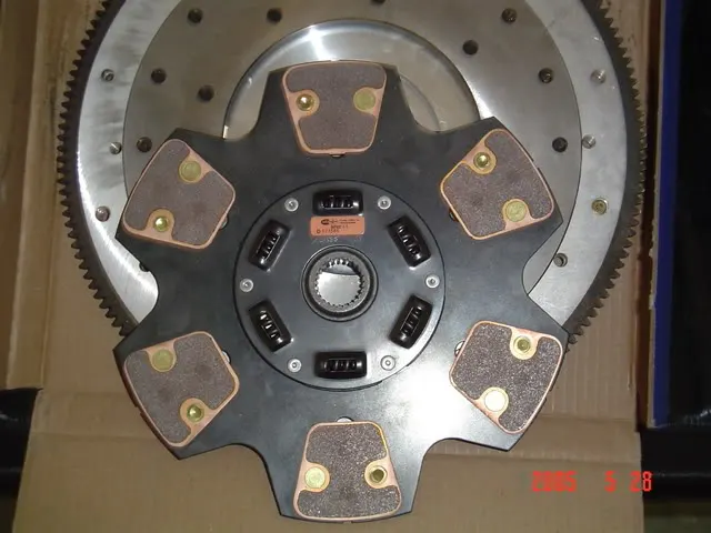

What the hell is a mcload dual friction. Do you mean you ahve a centerforce pressureplate with a mcload disc? if so waht disc and plate are you running?

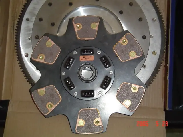

Got my mcleod setup from walt at pro motion years ago.The above pic IS the clutch i was running(dfx)
Cut the weights off? Thats funny ,on my DFX i had no issues with wieghts sticking even at 7200rpm shift points.
WIth what i know now,the dfx is almost the perfect clutch.No break in needed,cheap compaired to a twin disk,very streetable,and can hold 600+ with out breaking a sweat.

I have never had luck with the Centerforce kits but I am liking that DFX setup though. It looks similar to the Hays Metallic kits I run. ( Hey White ) have you ever run one with an alum. flywheel.
Yea originally had a alum flywheel till ,i had the ring gear come off of it(new ford 5.4 cobra alum flywheel)..Then i went back to my trusty billet steel..
For a street car the billet steel is a better choice.I seen the difference in the way the car drove.Power was the same but it just drove better with the steel flywheel.
Looks like the 600hp clutch looks like a DFX disk but possibly with a cheaper pp.
