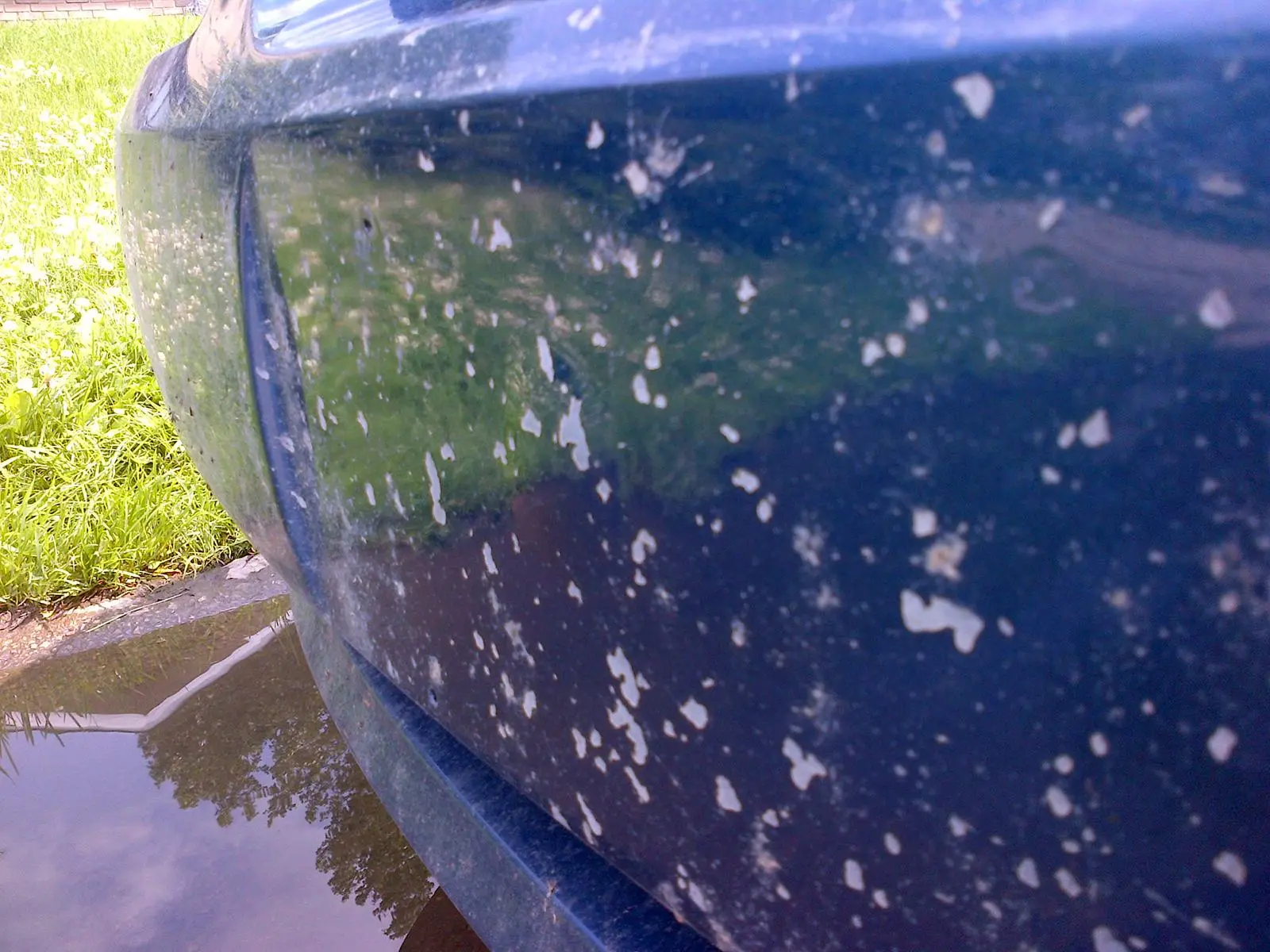

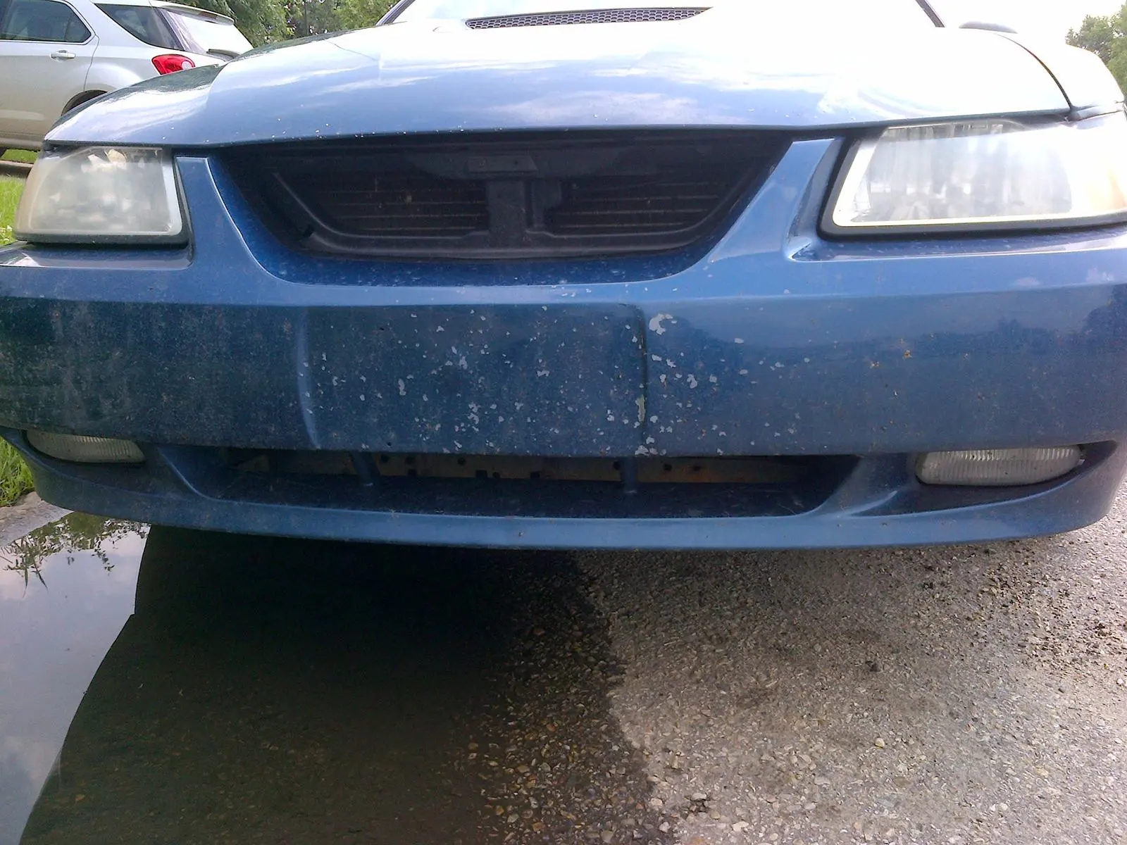

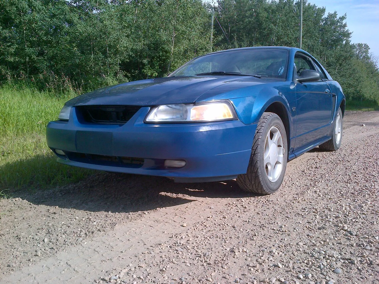

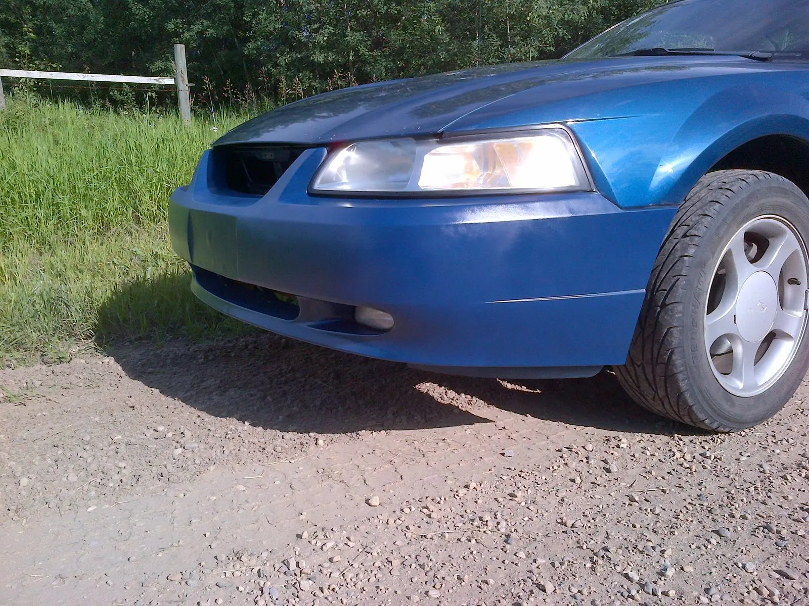

the lady I bought my mustang from had a car bra on the front, wich was first thing I took off when I got home... ;) .... however the whole front bumper is full of nasty rock chips/paint chips... and a bubble.. rite where the licence plate would go there is a buble, its noticeable, the bumper seems to have warped or something... any idea how I fix that... can I sand it down like the rest of the bumper and just use color match spray paint from the local store and clean it up until I can eventually afford a wrap for the car or new paint job... I just ordered smoke headlights, mach 1 grill delete and chin spoiler and need to fix this bumper up asap before the install
this is the colour and the rock chips.. can you notice the bubble... does anyone else have this issue and how do you fix it

With the severity of the chips you'd have to sand the whole bumper down. Still gonna leave you with some holes from some of the stones. Touch up cans never really match. You're better just getting a new bumper and having it painted

ahhh so ive been told.. issue is im near broke for now haha and just want to clean it up.. im thinking of getting the car wrapped in matte blue once I get the money eventually so don't want to spend the extra coin... I ordered a chin spoiler for the car and im guessing installing it would be stupid if I need to redo or replace the bumper ay... whats your thoughts on that
Yea I would hold off 1. Because you have to drill IIRC 16 holes in the bottom of the bumper to mount the chin spoiler. 2. It draws attention to your bumper. You could check eBay Craigslist etc some companies have new painted bumpers for like 350 shipped. Or try and find used one in your color

well I didn't listen haha instead I went out got sand paper and sanded all the rock chips down until they were smooth, then sanded the whole bumper down and tonight I will be spraying it with rust check primer, hopefully it looks good as a finished product
got the primer on, looks great, cant see any of the rock chips any more... a couple spots where I got lazy and didn't sand the greatest needs to be touched up but so far so good
Don't know if I would waste my time with clay bar, I have tried it a couple times it was kinda of a waste. If you have an O' Rielys in your area they carry the Mequires pro line car detailing stuff. You can get some fine cut cleaner and glaze that you can apply by hand but anything over that will require a DA or buffer. I used fine cut with a DA on the sheet metal but the front and rear bumpers needed medium cut.
omg so im ready for paint and go to local stores looking for my color code K9 AND nooobody has it.... anyone know if another color code is similar to mine, I saw some other ford color match paints that looked like they may match up but I donno

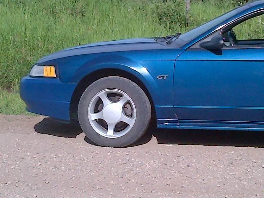

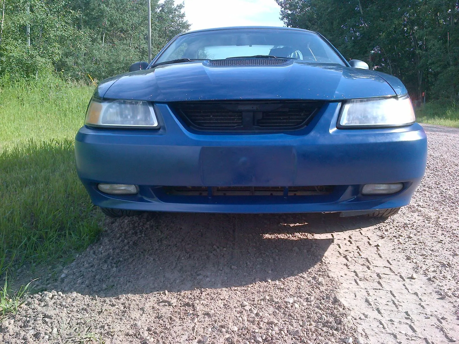

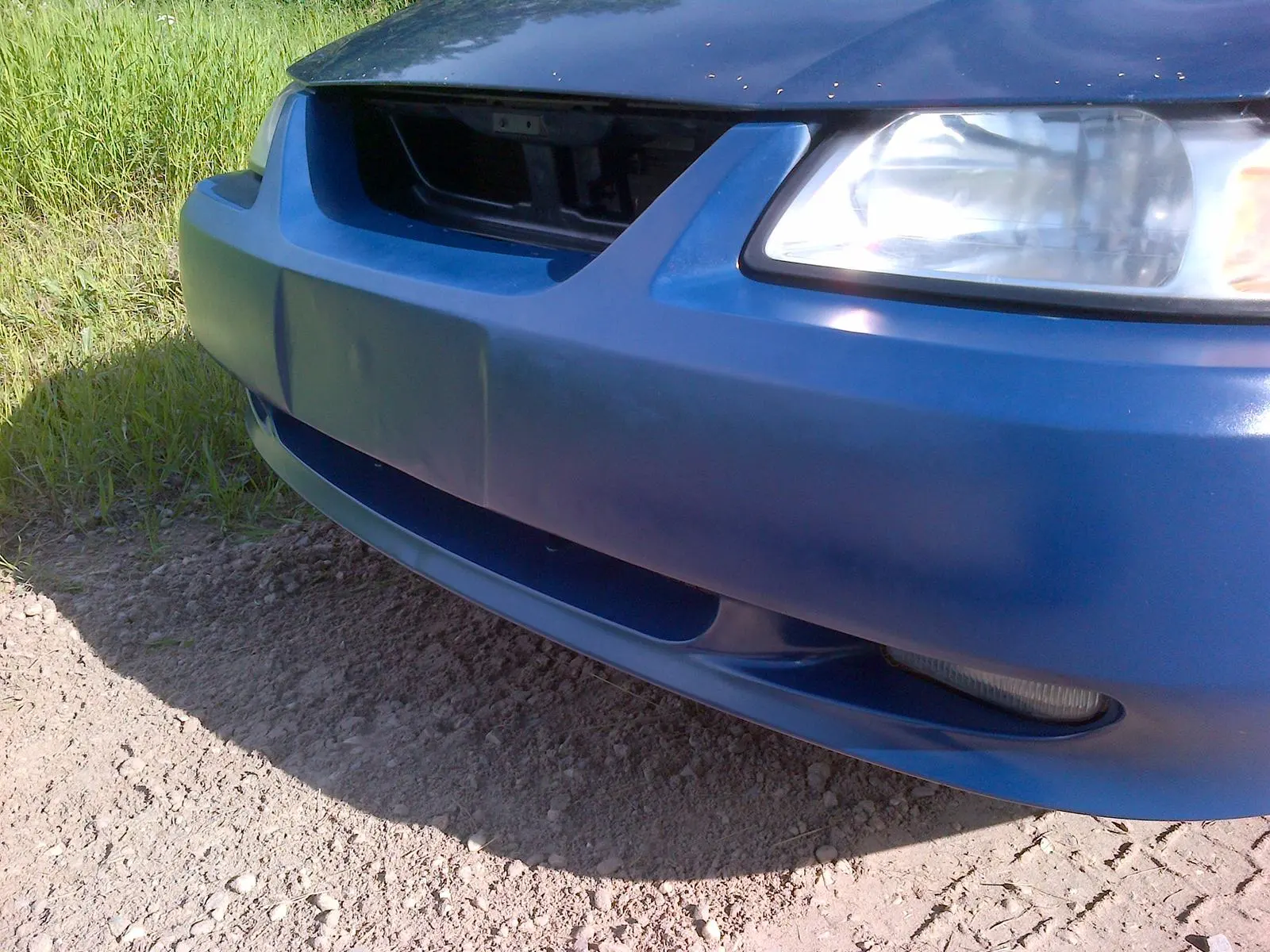

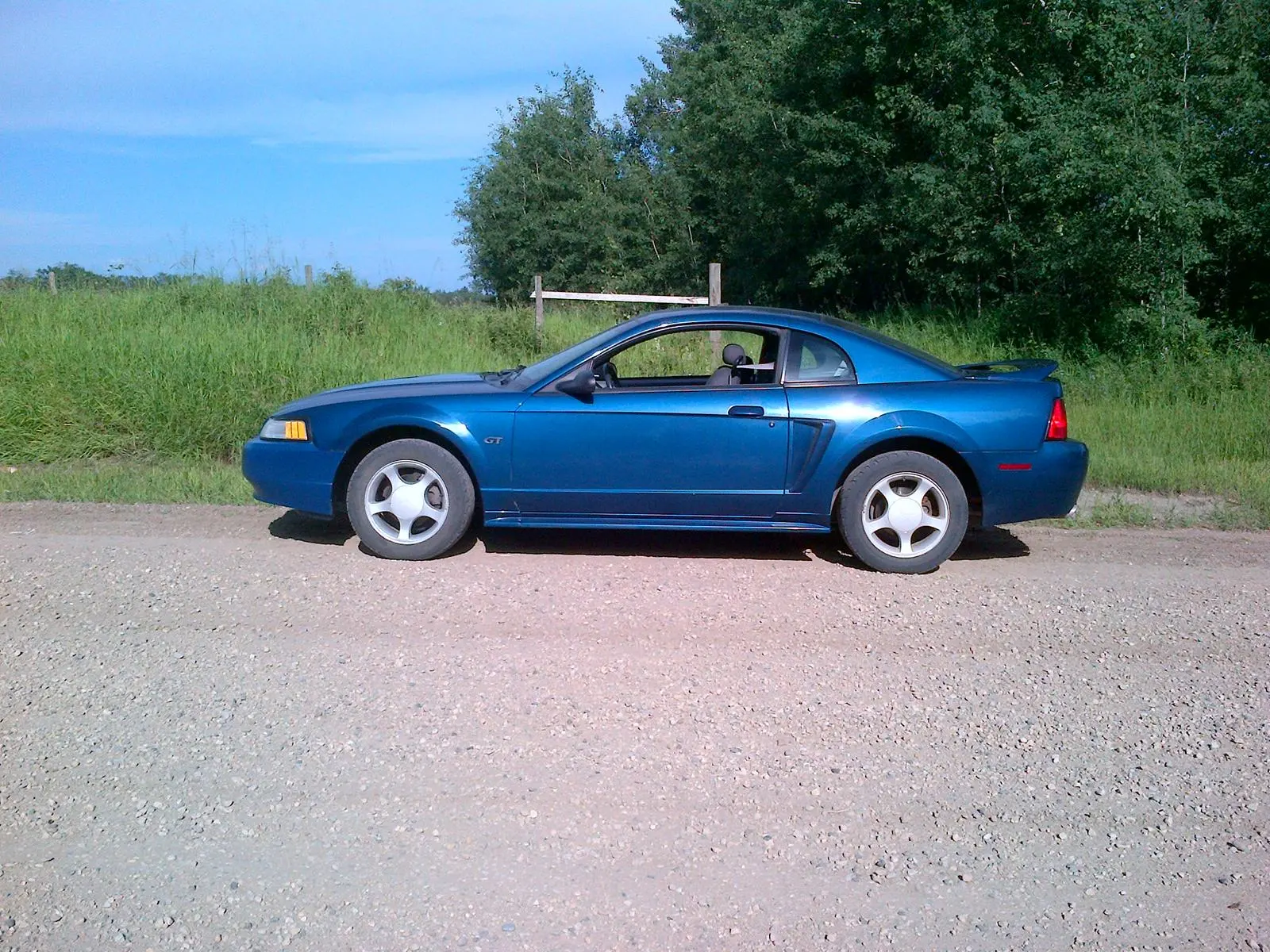

so after sanding primer and painting the car with the wrong color paint this is how it looks... still like sh it but no more rock chips hahaha
