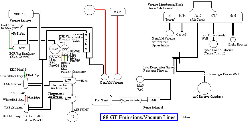

I dont suppose you have a picture of where that vacuum line is do you? I'm having the same exact problem on the same exact year car! thanks guys!

Vacuum routing
Check the power brake booster rubber grommet where the vacuum line fits. They are known to leak. To check the booster, start the car and run the engine for 30 seconds at 1000 RPM. This builds up vacuum for the power brakes. Cut the engine off, and press on the brakes. Each time you press on the brake pedal, you should have a harder pedal, and it will travel less before it gets hard.
I would recomend that you use a vacuum gauge to check the vacuum. You should have 14"-18" of vacuum at 625-750 RPM and 18"-21" of vacuum at 1000 RPM.
