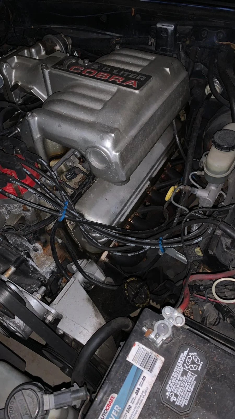

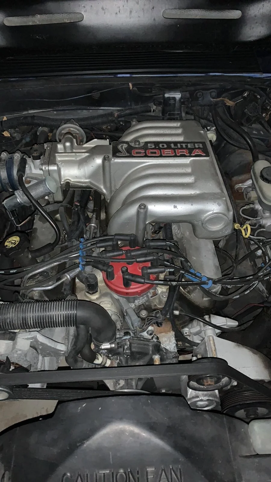

Car is an 87 but after tracking down two previous owners that motor is not original. What was listed but unable to verify is the following bored to 306, cobra heads, and intake, E303 cam, BBK fuel pump and MSD cap and rotor. What I have verified is the BBK headers, BBK CAI to the fender, and I think that is a cobra intake.

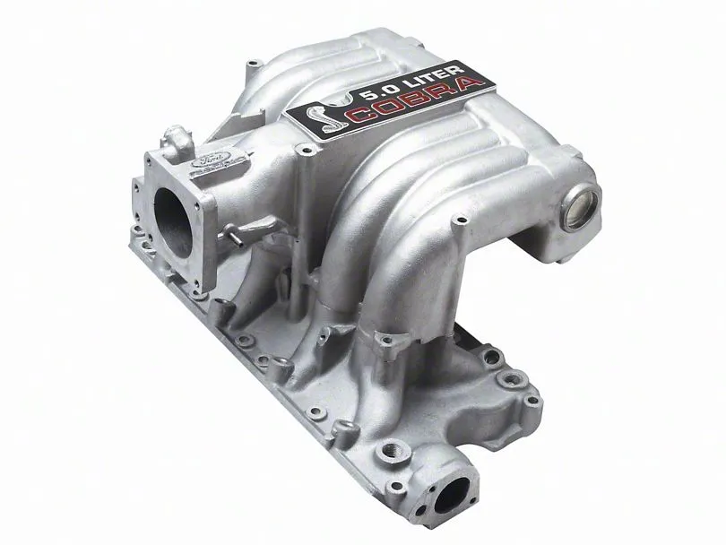

Doesn't appear to be a genuine Ford Cobra Intake, it's missing the Ford Motorsport (now called Ford Performance) nameplate.
Yours still has the 2G 75A alternator; you can tell by the external fan.
Let's see the rest of the intake (passenger side), can't tell if it's SD or MAF
Actually the intake he has is the original version, the later produced versions had the Ford Motorsport logo cast into it. Look at the intake on a stock '93 Cobra.
Also looks like your car used to have AC and the smog pump is removed/bypassed. Serpentine belt tensioner is not in factory location either.

You should really fix your belt routing, and put the tensioner back where it belongs beside the alternator. The way it is running now the ribbed part of the belt is running across the smooth pulley of the tensioner. The tensioner has no ribs in the pulley and is meant to put tension on the smooth part (back) of the belt, not the ribbed part.
Reactions: Blown88GT
Likely moved the tensioner because they didn"t want to get or make an A/C delete bracket and pulley or buy one. Or not move the PS pump up to where A/C was (just like it is on non-A/C cars).
If tensioner was left in the stock location and they didn't do either of the above, I believe the belt would hit top of water pump on its way to PS pump from alternator.
Basically they tried a jury-rigged way to get it done. I agree that this configuration could lead to premature wear on the belt because only the tips of the ribs are touching the pulley and all the force generated by the tensioner will be squeezing against the belt rib tips increasing the stress on them. Not to mention it could wander on the pulley.
Actually it looks like the belt is already one rib off the tensioner. You can also see a distinct line on the belt where the valley of the first rib would be.
