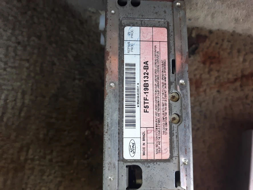

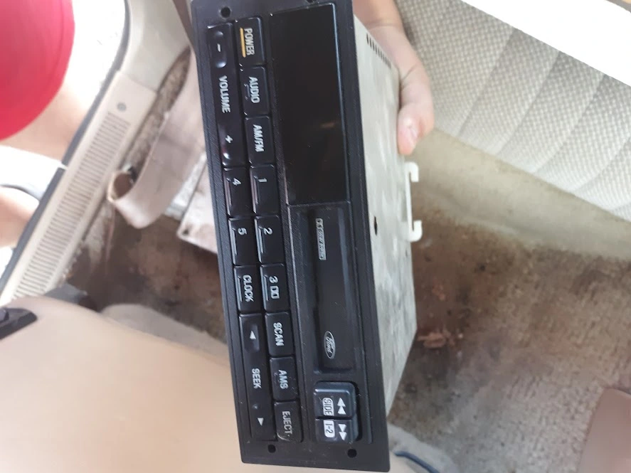

here

Is it an amplified radio, or non-amplified. Would need to see the plug configuration on the back.
See post #6 specifically in the above thread.
In terms of how to get thar radio in a Mustang? It's a square face faceplate, so you are lucky there. You'll need to track down the bottom plate from an 87-93 mustang radio to swap onto it to mount the cubby
Both those threads should have more than what you need
