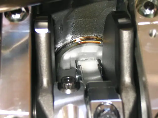

Well ..here is a real world picture of a stroker piston @ BDC. It travels .338" out of the bore. I don't know why some people keep saying the come out half way up the piston. Maybe they have seen some crappy kits??

thats good info,... I am just going by what I have seen from destroyed strokers. seems like the sideload on the rings is the biggest issue though. And after looking closer at that piston that is still to far out for me,.. look how far the wrist pin is away from the bore. couldnt that cause problems?
I am just asking .. you are the expert here.

I am also curious about this. I know with your 324 BB/stroker, the cylinder is re-sleeved so the piston will not leave the bore, but if the stroker is using a stock sleeve, then will this cause a problem?

That is a stock length sleeve you see pictured. the extend sleeves could not be used with the beefy big end of the aluminum rod.
