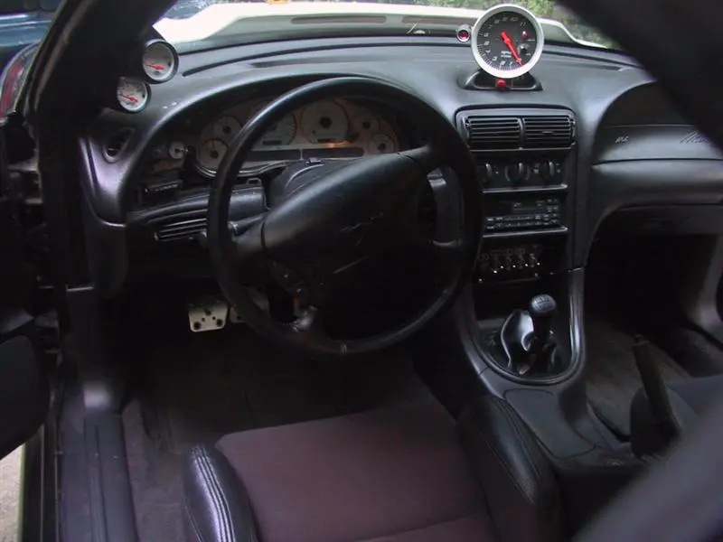

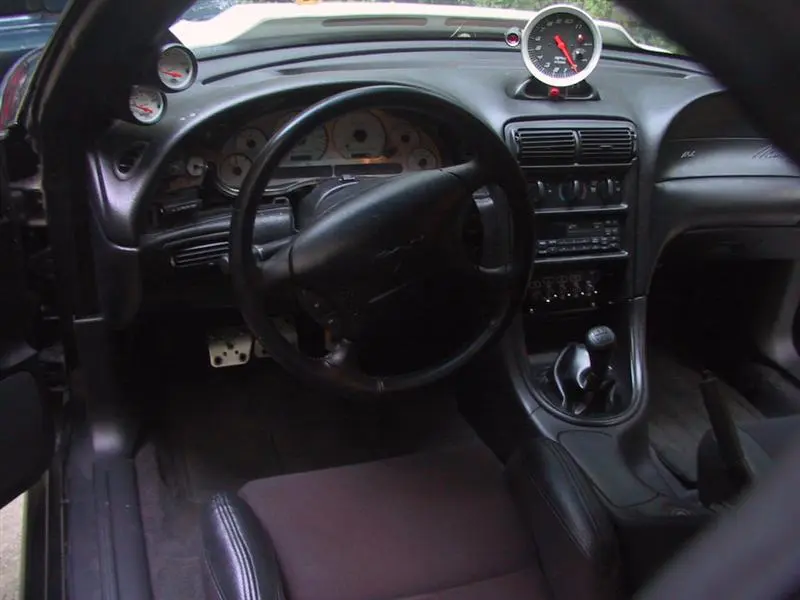

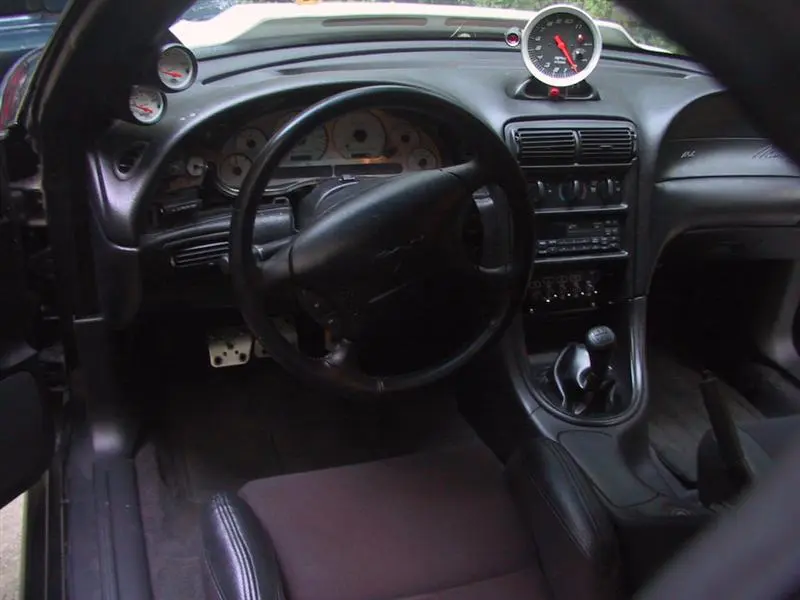

Do it! I painted mine black as well. I used interior specific black paint, prepped all panels thouroughly. (I'm sure you know well enough to do that, working for SW) It WILL chip, but mine has held up pretty nice. It's not too hard to repair either. Mine isn't a daily driver though, so it doesn't get driven as much as yours.
One thing though. If you can get a real black console, steering wheel and door sill panels, do it. Those are the biggest wear items. I have a real black console in my car, and I need to put a black steering wheel and sill panels in.

Did you use the dye or the paint?

I did it with Duplicolor satin black Vinyl / Fabric paint (Label says that, don't use it on fabric, it'll only make your fabric stiff and scratchy.) It's an exact match for the 94-98 black interiors. My black console is from a 97, my black carpet is from an 03 (My carpet is actually Charcoal, the lighter black.. But I'm on a tight budget, so I had to deal with waht I could get)
