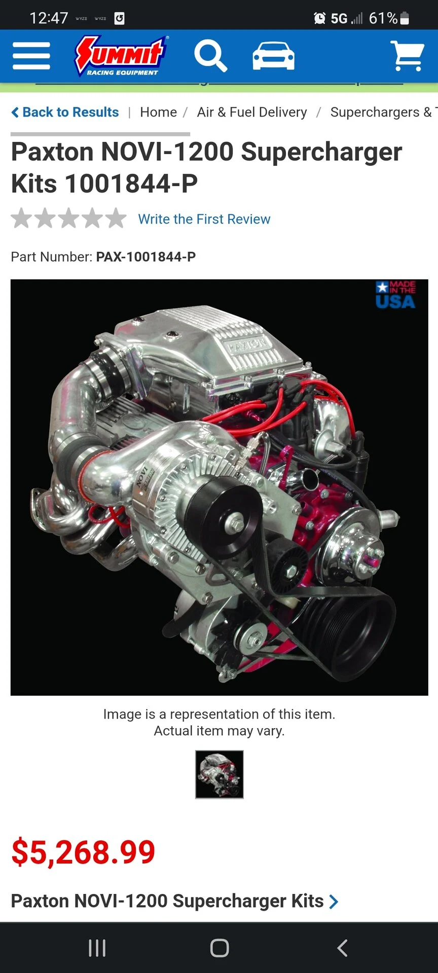

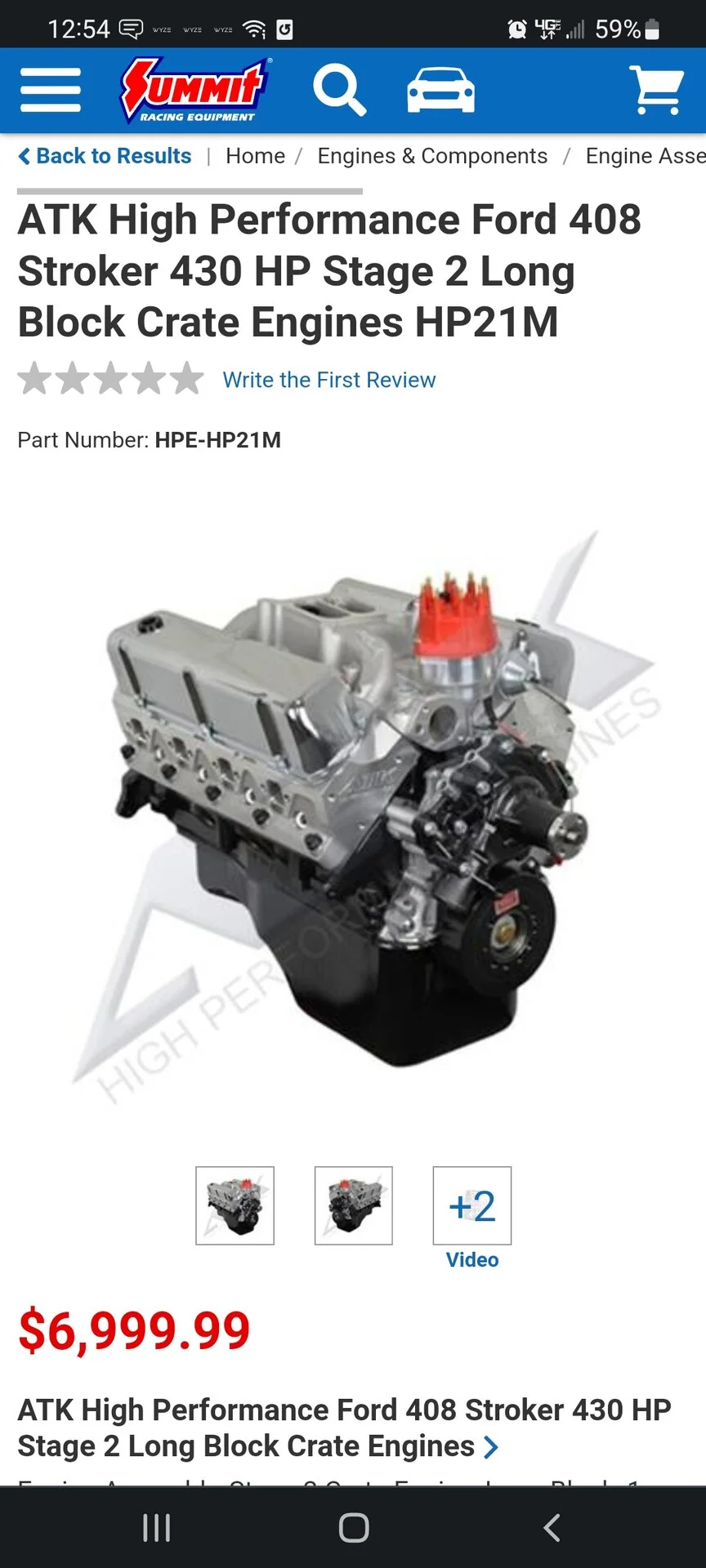

The 351 block is reported to hold 750hp without issues. If I had a truck, with all that engine bay space, a supercharger would be in there. A 408 stroker kit would also be there. If money isn't an issue this would be the way to go. If money is a factor the parts list in the description could be modified and a custom camshaft could be added.
This is the supercharger kit
I had a 1988 econoline van named Papa Smurf. I really wanted to build it but life got in the way. A built f150 would be bad ass.
The supercharger in this post might not be enough for the engine posted but you get the idea. I did absolutely no research...just hit the search bar.

I was referring to the big sewer pipe sticking out of the front
I’m sure there is a blower like that for the 351 W for you to hate on. Most likely, it’s just the base that needs changed for that roots type blower to fit. The centrifugal blowers look like a misplaced turbo to me.
